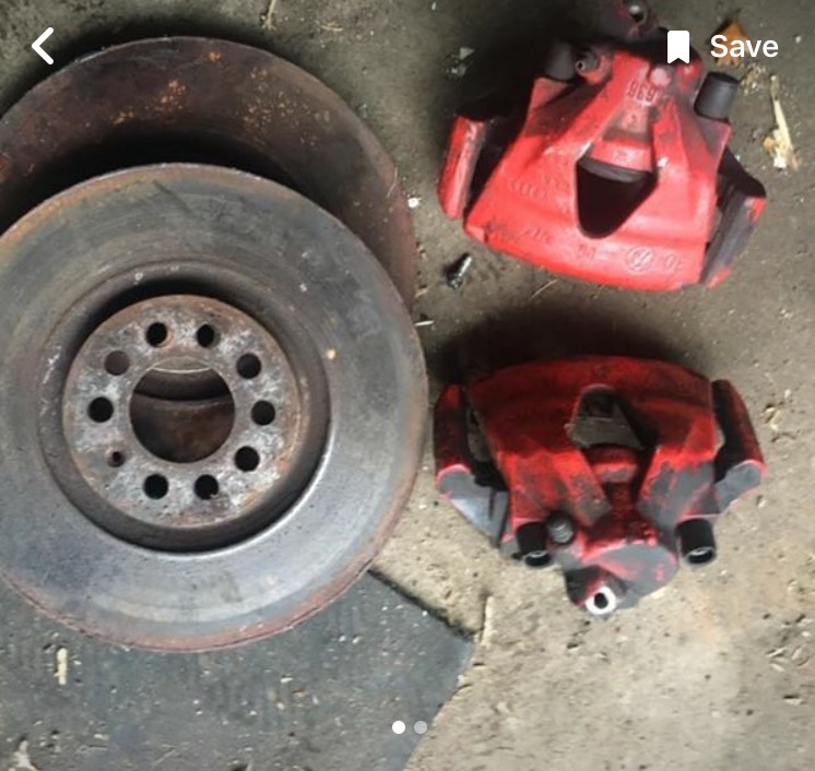

I don't think you can, but if you want to make adaptors I've got some bigger twin pot calipers brand new you can have nice and cheap :D
twin pots off the golf ?
They are pretty similar to R32 type. Here's the link.
Noooooo hahah. Will they line up better then !!
I literally have no idea, I might see what they fit like one day if I don't sell them, im sure they will be better than some second hand octavia single piston calipers if your making adaptors tho ;)

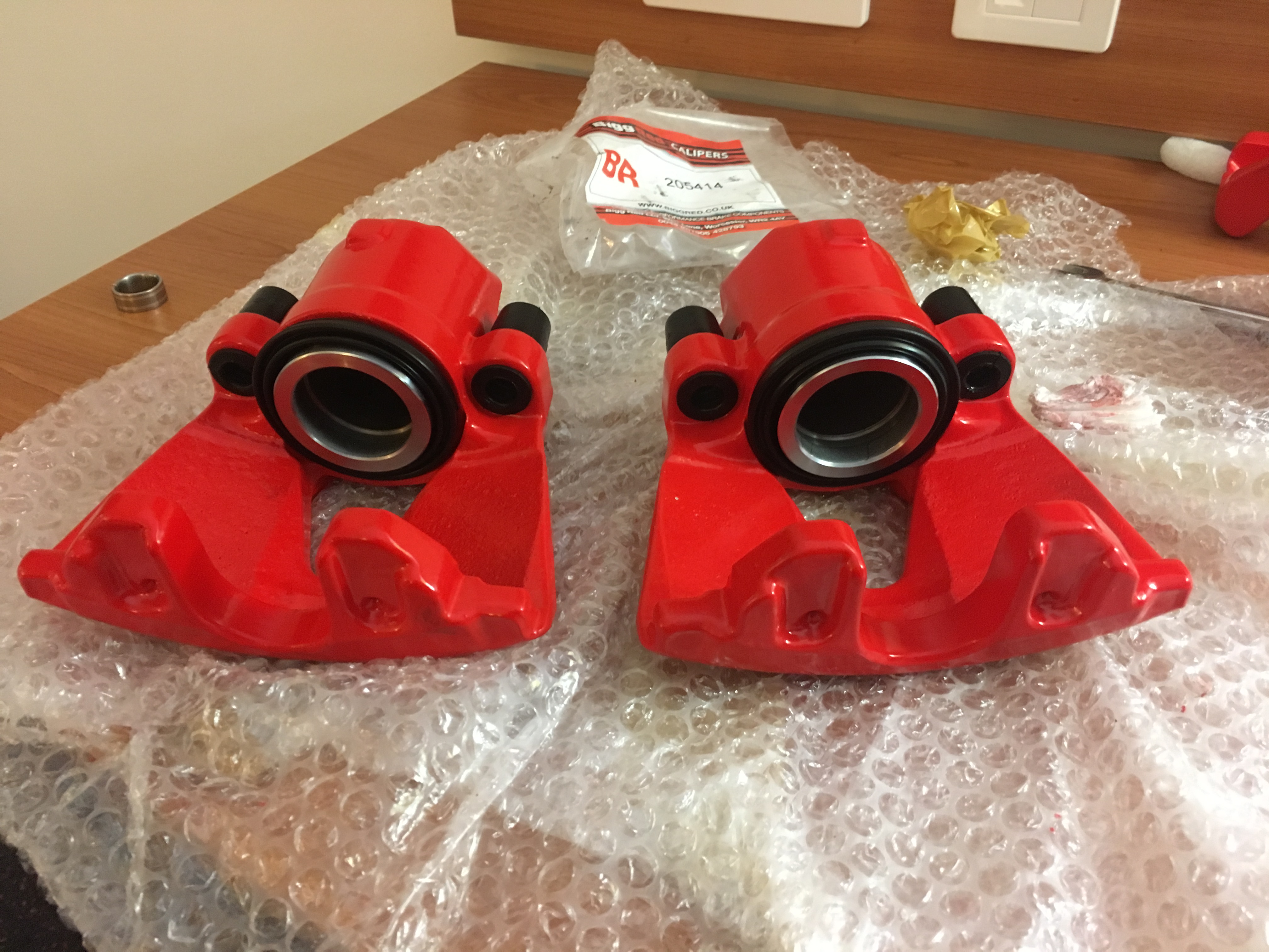

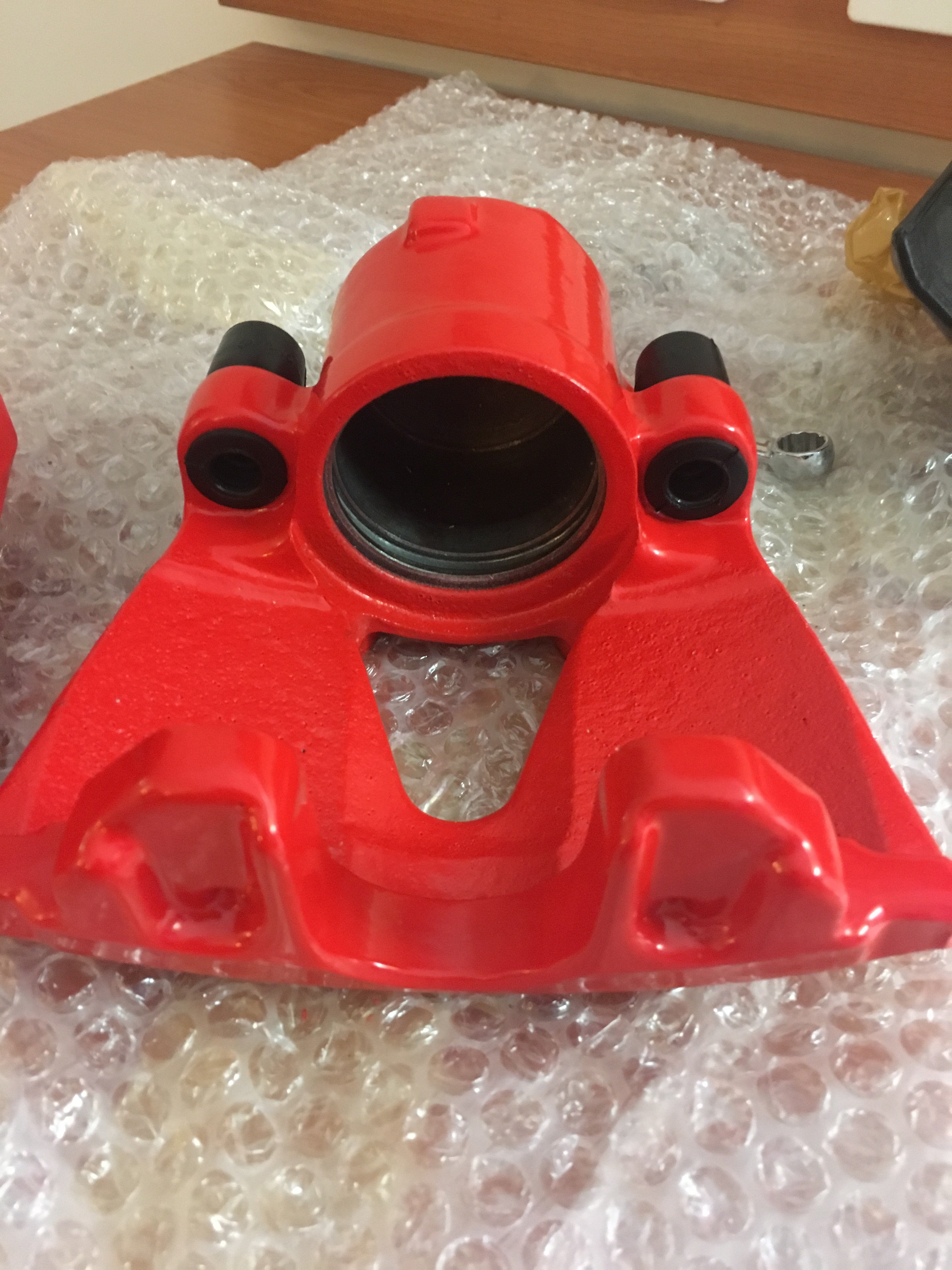

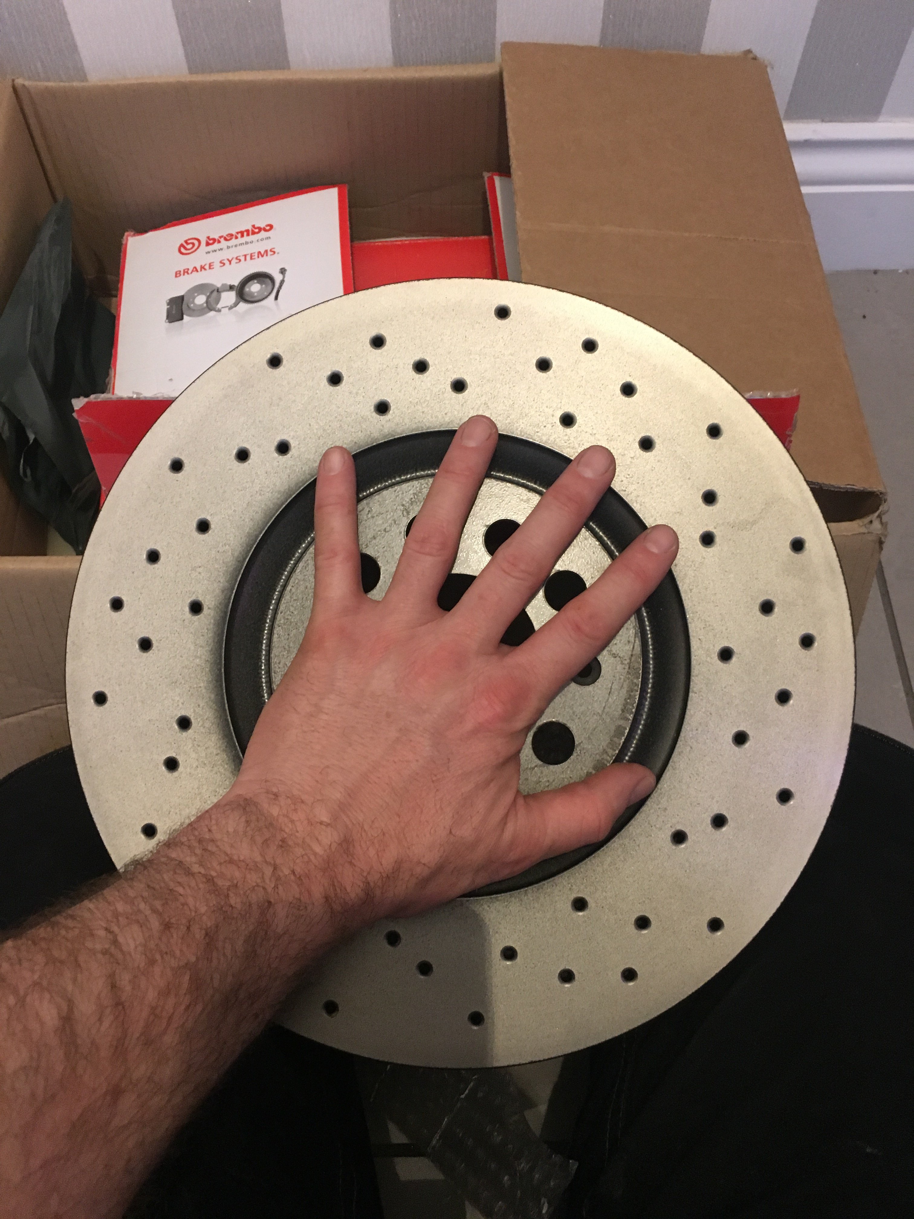

So no adaptors needed.. mk2 octy calipers sent back and a lucky find for some golf mk4 anniversary ones... blasted and ready for powder coating... new pistons seals and rubbers ready to go... all in inc blasting painting and refurbed kit for less than 130 quid.. some brembo xtra drilled discs and all will be well again
Nice I did mine red too

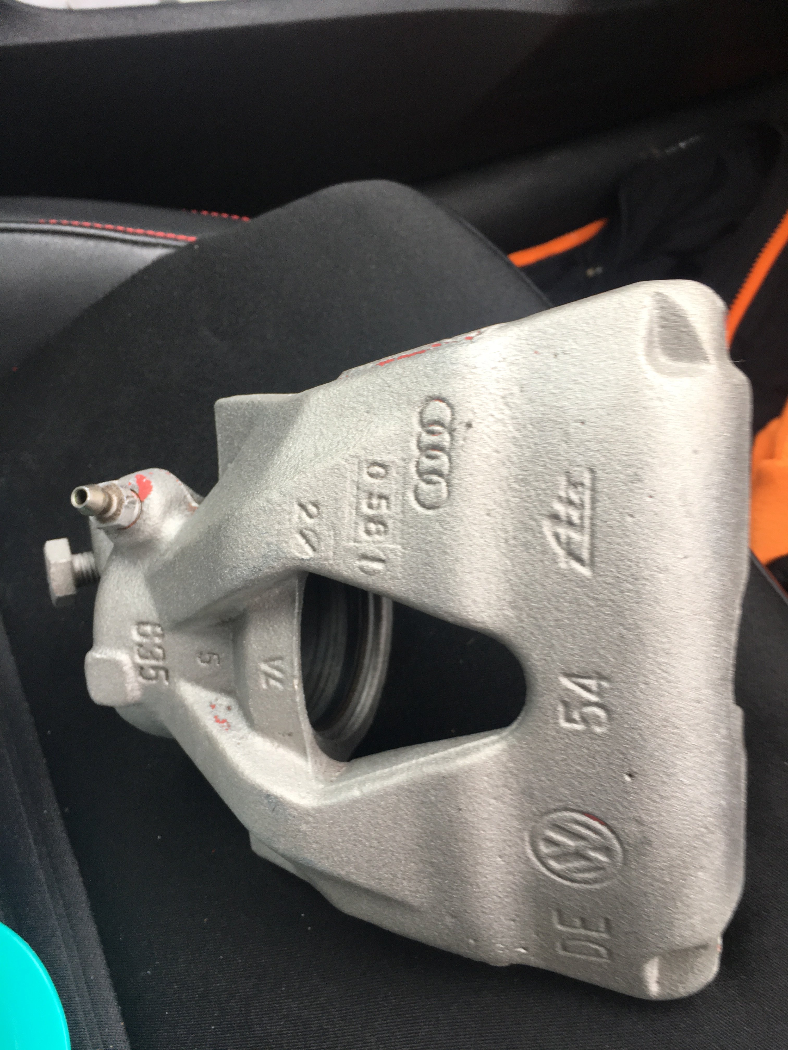

So these turned up today.
