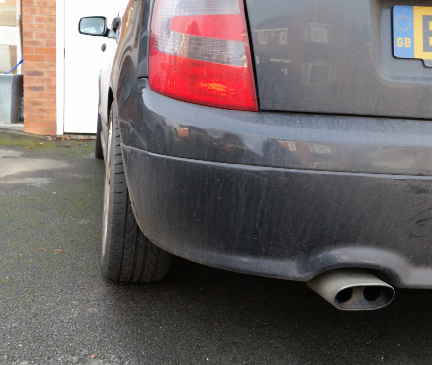

Hi everyone, I've decided (thanks to some lovely people on here) that I should keep my standard 15" alloys and put some spacers on, rather than wiping out the already suspect ride quality in my Fabby estate. My friend at work noticed that the rear wheels sit further inwards than my fronts, so my question to you is, what spacers should I buy to make both front and rear equal, whilst making the car look a little less skinny and allow me to still carry passengers/Wife's rubbish in the boot? Any links to previously bought spacers, would be greatly received ;)

I ran 10mm front 15mm rear on my vrs lowered with no issues I brought them off a member on here so can't help with a link
I think most fwd car are narrower at the rear I'm sure I read that on her somewhere helps reduce oversteer I could have made all that up but I'm sure someone will correct me if I'm wrong
