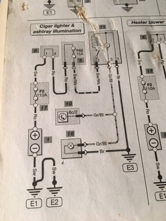

Off the top of my head, there should be three wires to the existing connector. Two will be chunky, with one thinner one. The thinner one is the positive feed for the ring of light that comes on/off when you turn the car lights on. The two thicker ones are the positive and negative. The positive is permanent live so that you can use the lighter with the car off.
Main positive: black/white
Main negative: brown
Lights positive: grey/blue
for the aftermarket ones, most likely they will use red for positive, black or brown for negative. The lights one if they support it could be any colour.

Number 11 in pic below.

Excellent info here mate, thanks for taking the time to write it out. From looking at the switch earlier when testing for voltage to the plug I can tell which wire is which from the colours you have listed above. I wasn't able to get any continuity on the actual lighter socket itself between the 3 prongs underneath and the tabs within the socket that touch the plug for device you are plugging in.
I have since cleaned the connectors and metal tabs of the socket with vinegar and salt and let it sit in there for a few minutes and it seems to have cleaned all the connections and I am now able to get continuity between all connections - its a bit dark out now so will leave it until tomorrow and plug it back in to see if there is any power getting into the socket when I plug it back in. If not, your write up will come invaluable for buying a new aftermarket one which I will probably end up doing as the outer "light ring" on the top of the socket is a bit mashed up!
