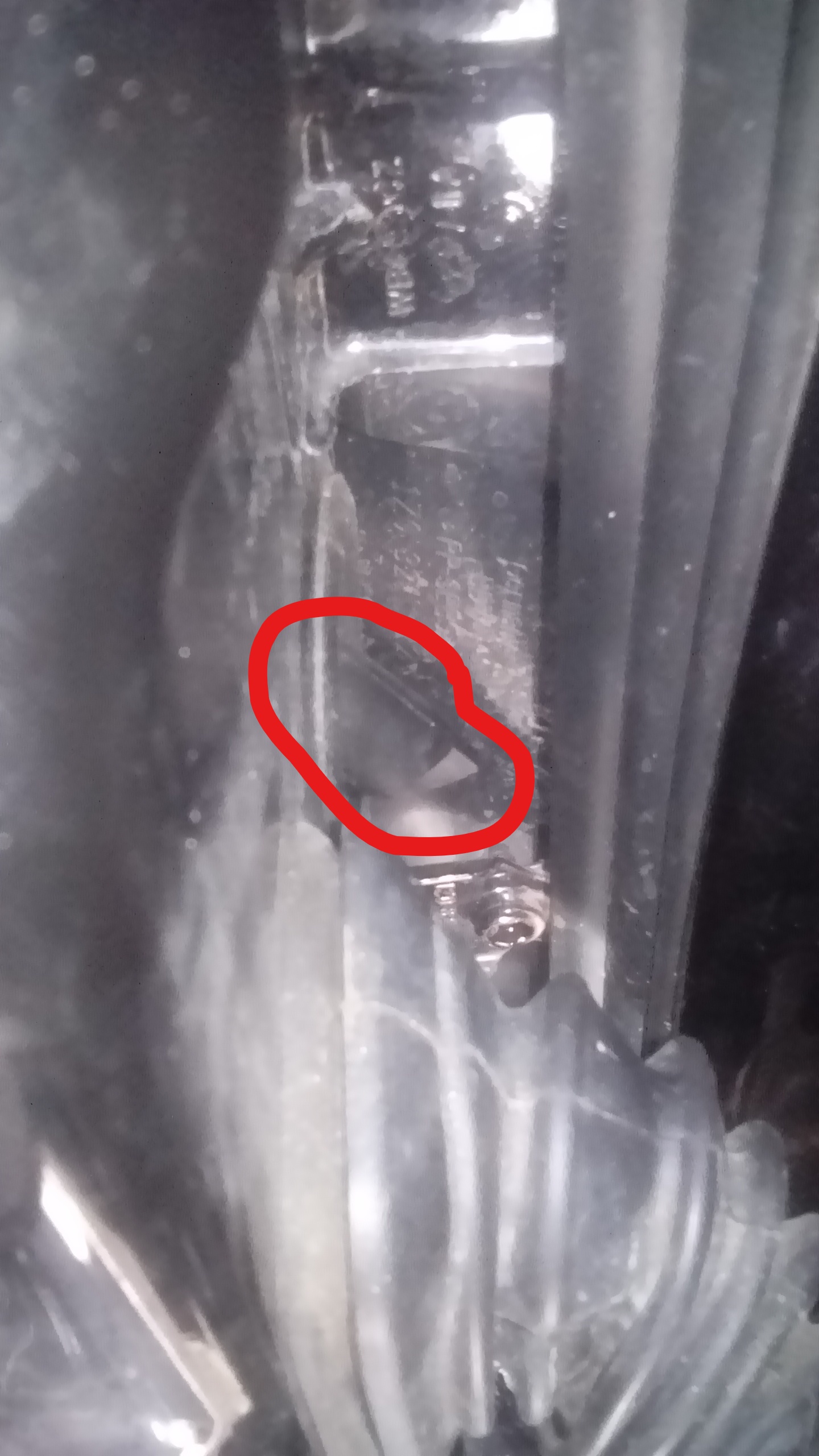

The drain holes for the front are the rubber tubes sticking out in the hinge shut line, just on the engine side of the doors, just in front of the hinges and I'd put my mortgage that that's your problem. What you'll probably find is that find is that if you tweek them to open them up, a shedload of water will pour out, accompanied with the appropriate noise, as they're more than likely be bunged up because they narrow at the end and are designed badly.
THIS IS THE BIT I DESPERATELY NEED YOU TO RECORD TO PROVE WHAT I'M SAYING TO SKODA. (mine are clear so can't recreate it myself)
I suspect, this will cure the first bit of your problem. Myself and others have found that the blocking up of these tubes leads to water overflowing into the cabin, and therefore down the A & C pillars. Now, are you sure it's coming down the B pillar cos as I said, I would guess it's actually more likely to be coming from down the C pillar! What happens is the water overflows and runs along the underside of the roof lining (which is plastic backed and therefore doesn't stain/show water damage signs) and comes out at the c pillar point, runs down the inside of the chassis and back into the rear footwell via the sides of the seat, underneath the squab. You need to remove the side squab of the seat to see where I mean, but it'll make senseonce it's off. If it is there, you'll probably see water under/along the wires which go through to the boot.

These are what you're looking to manipulate...
Nailed it!! Thanks for videoing it Raimon, very helpful. ;)
