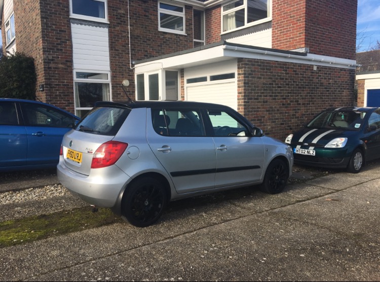

I have a fabia elegance / Frankenstein monte 1.6 (105) I use it for motorway hauls 60+ miles a day which keeps the DPF clear. But short journeys in town are ok but a couple weeks ago car started crying because it hadn't been on a motorway and threw a DPF light, quick motorway blip and it got rid of it.
I have had my roof wrapped black (£115) within a week as I also liked the black roof. Lovely car just shop around as some monte Carlos aren't as well equipped as the Elegence models since they are modelled of the SE trim. Try and get one with a maxi dot as they are worth having.
