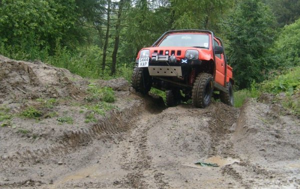

Sometimes you just need to get out of the ruts.

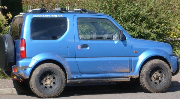

(My Blue Jimny had on 195/75 R 15 instead of the standard 205/70 R15)
