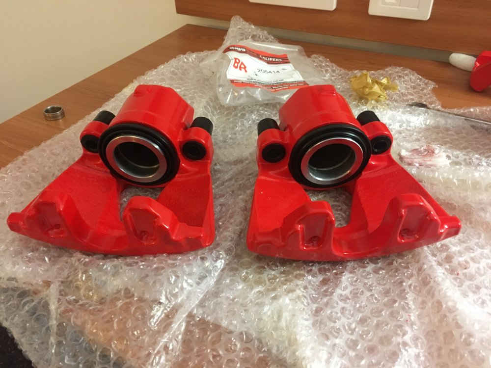

Mine are the same mate.. you can change some settings in vcds. I.e. How much assistance. Failing that. Get them re bled with new fluid or do the 312mm upgrade like a few guys on here. I'm just fitting mine this weekend. Mk1 Audi TT calipers or mk4 golf anniversary. Or my 1 Octavia vrs.. Just eBay search 312mm vw caliper

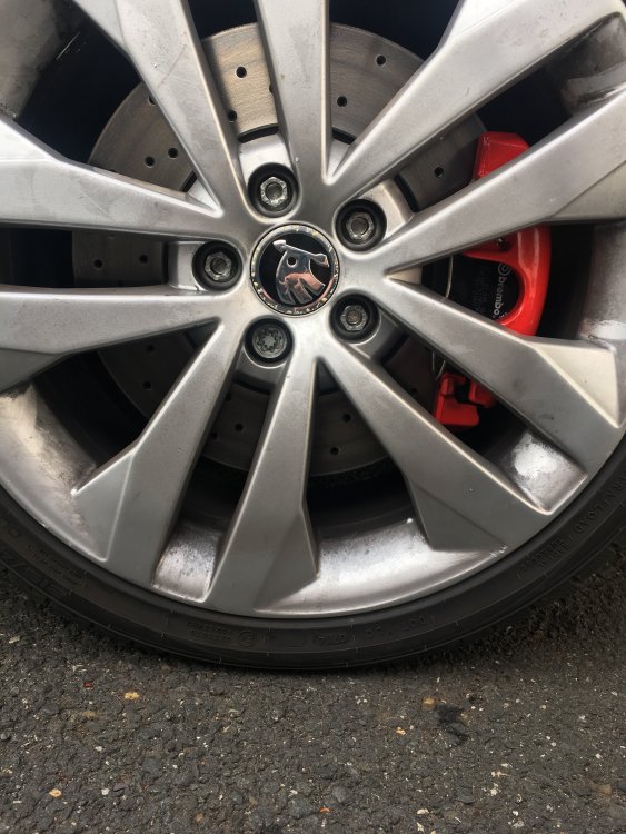

Skoda changed Brake fluid on mine 2016 there was no improvement. In the end i put expensive EBC's a bit overkill but they are really good now. (see pics on my project page)
I would still like to put braided hose on and change vcds settings (if i get the oppportunity). Car was on original discs and pads and had glazed slightly. Each week seemed to be getting worse (compared to the wifes citigo at least)

If anyone needs 312mm upgrade give me a shout. I've got a couple in my garage kicking around! :)
Just done the Wife's vRS ... night and day difference!

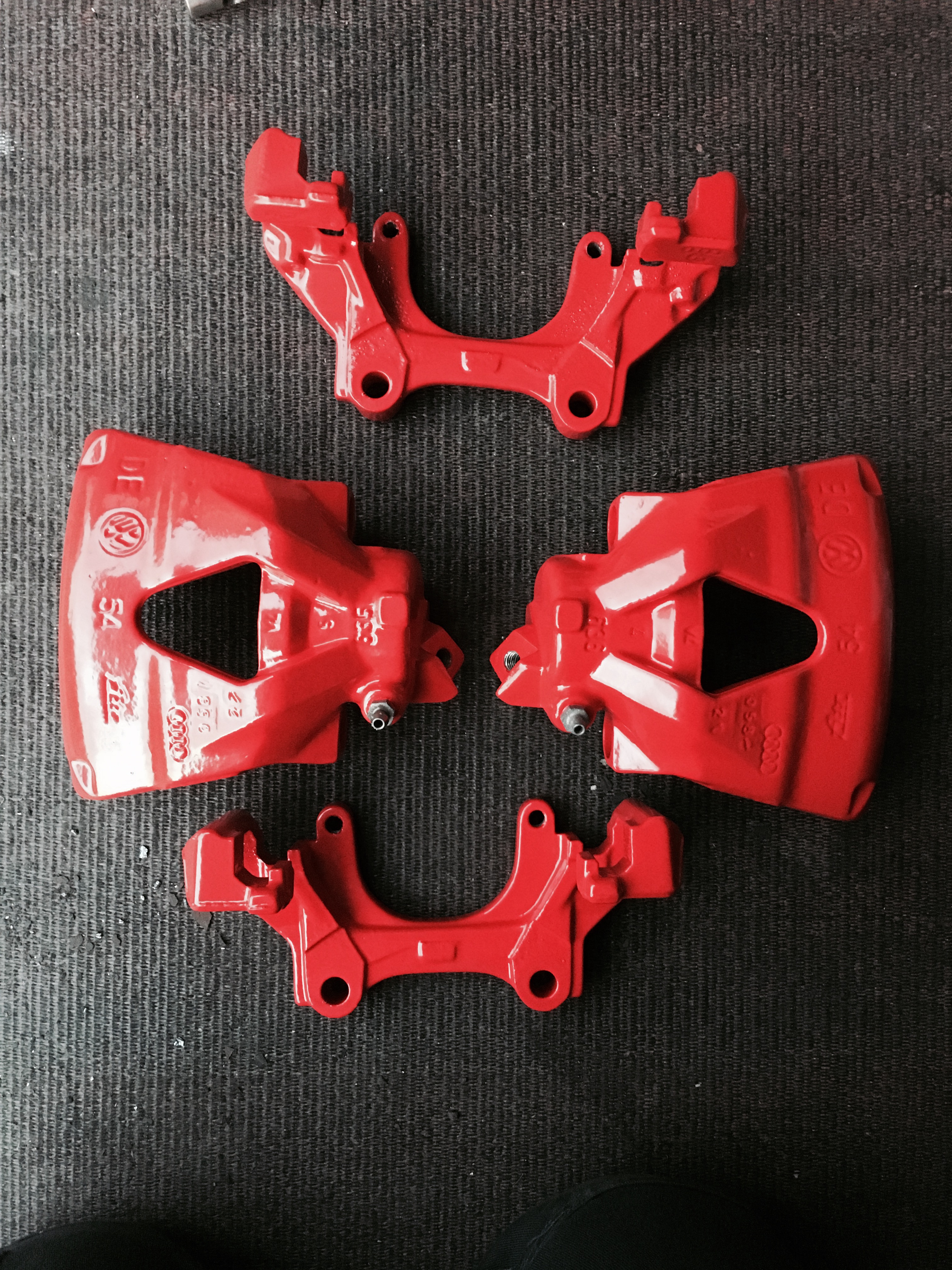

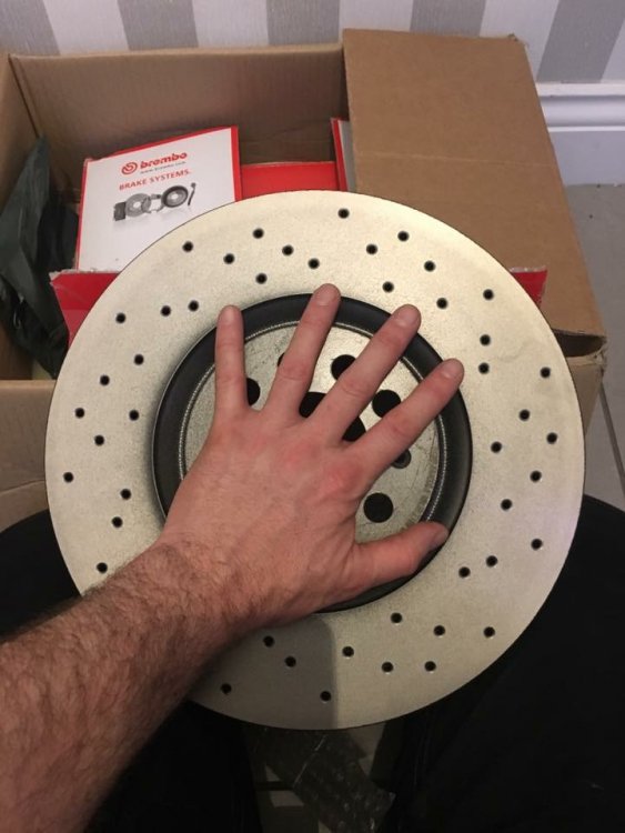

Calipers for the 312 upgrade will be Audi TT mk1. Skoda Octavia vrs Mk1 or golf anniversary. These are the golf ones I brought and refurbed and discs are a brembo xtra

On 16/04/2017 at 00:12, Esseesse200 said:
Calipers for the 312 upgrade will be Audi TT mk1. Skoda Octavia vrs Mk1 or golf anniversary. These are the golf ones I brought and refurbed and discs are a brembo xtra imageproxy.php?img=&key=66c1d7df650950daimageproxy.php?img=&key=66c1d7df650950da
