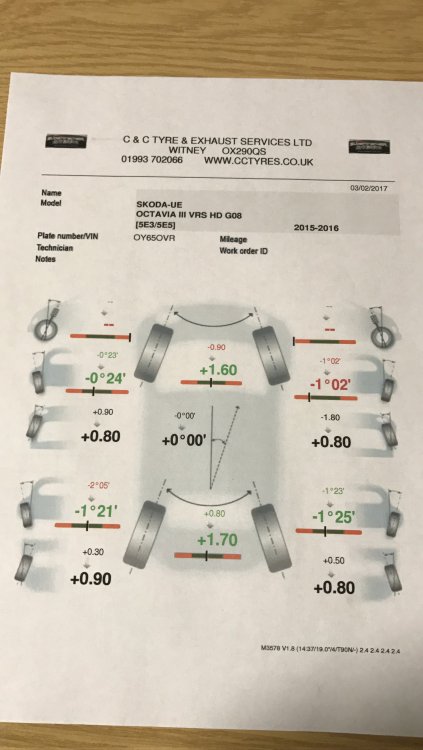

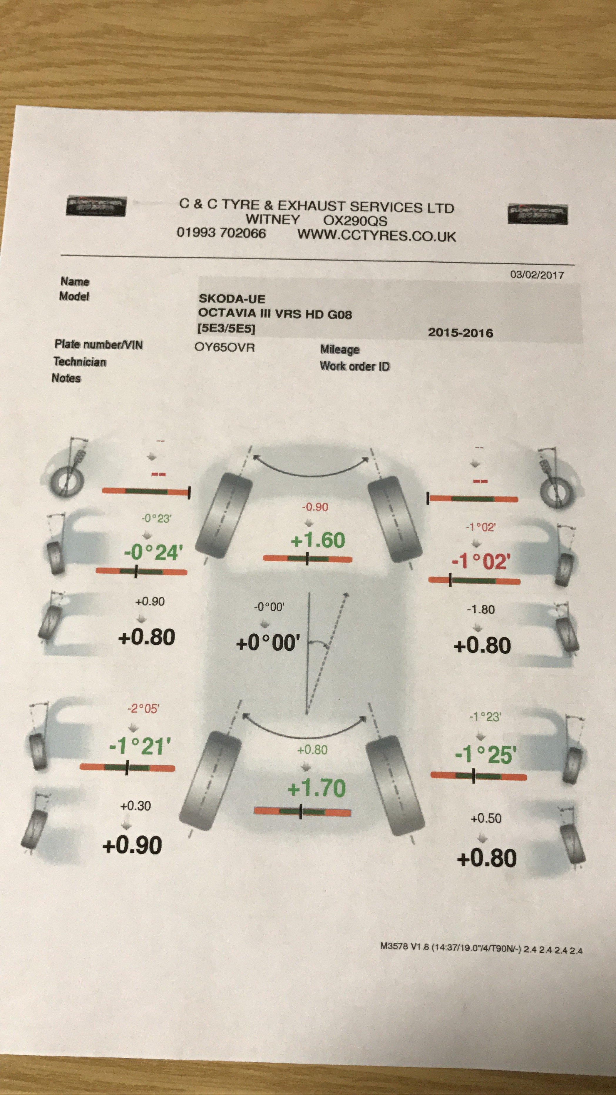

Very interesting to know as I had mine done (to a degree) at a local place to me and my car has ACC and Lane Assist.
Still needs more adjustment though to fully correct.
Edited by VRS_Dan
Added image
They said that they could do the front wheels, but that they can't do the rear wheel with ACC. Problem was the back was out as well, so not worth doing peicemeal
