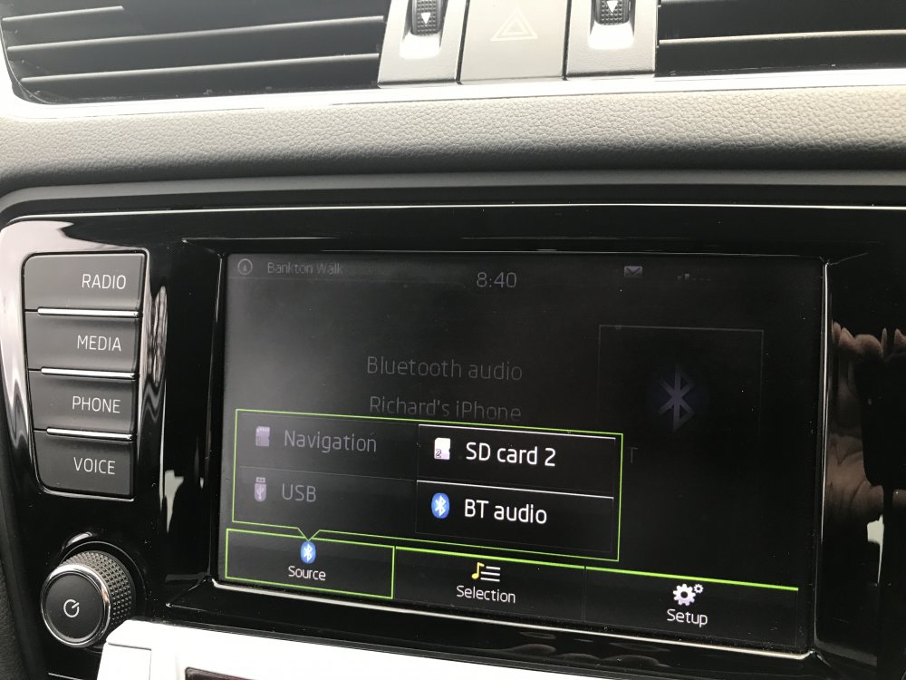

I use the smartlink on my iphone 6s usually but I switched that off and tried it just via bluetooth. My apple music works fine from the cars controls. Once bluetooth is connected if you press Media, then source, then BT audio you should have the access to your music, if you turn the right hand knob on the headunit (under the menu button) you scroll through the option of playlists,artists,albums etc and press that button in to select, Also you should be able to select all these options by touching the screen too, if any of this doesn't work then your headunit must be faulty. You cant change menus or anything from the steering wheel controls, only change up and down tracks within each folder.

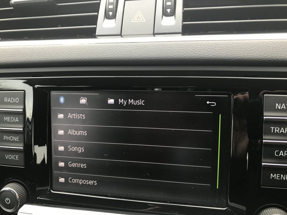

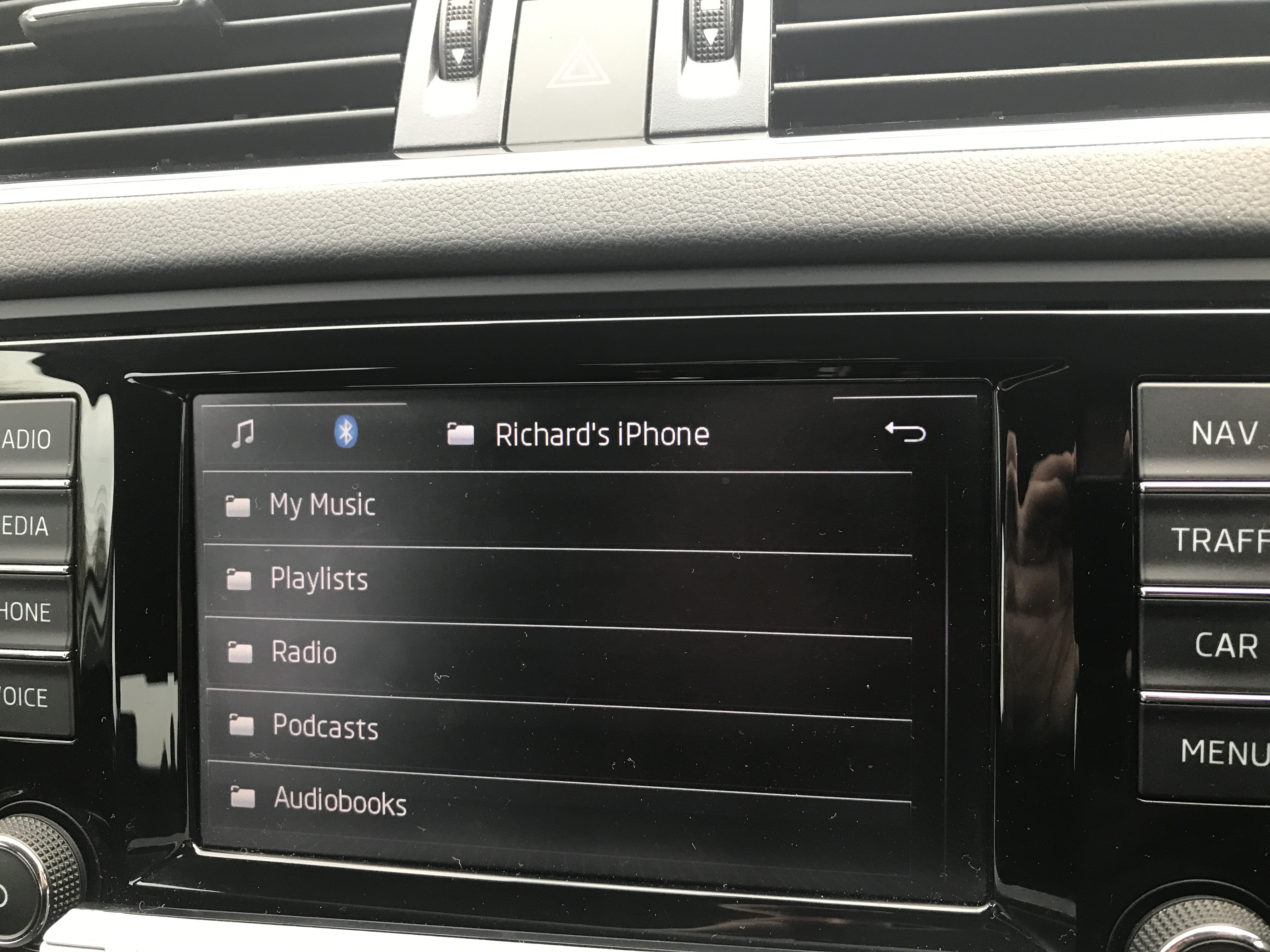

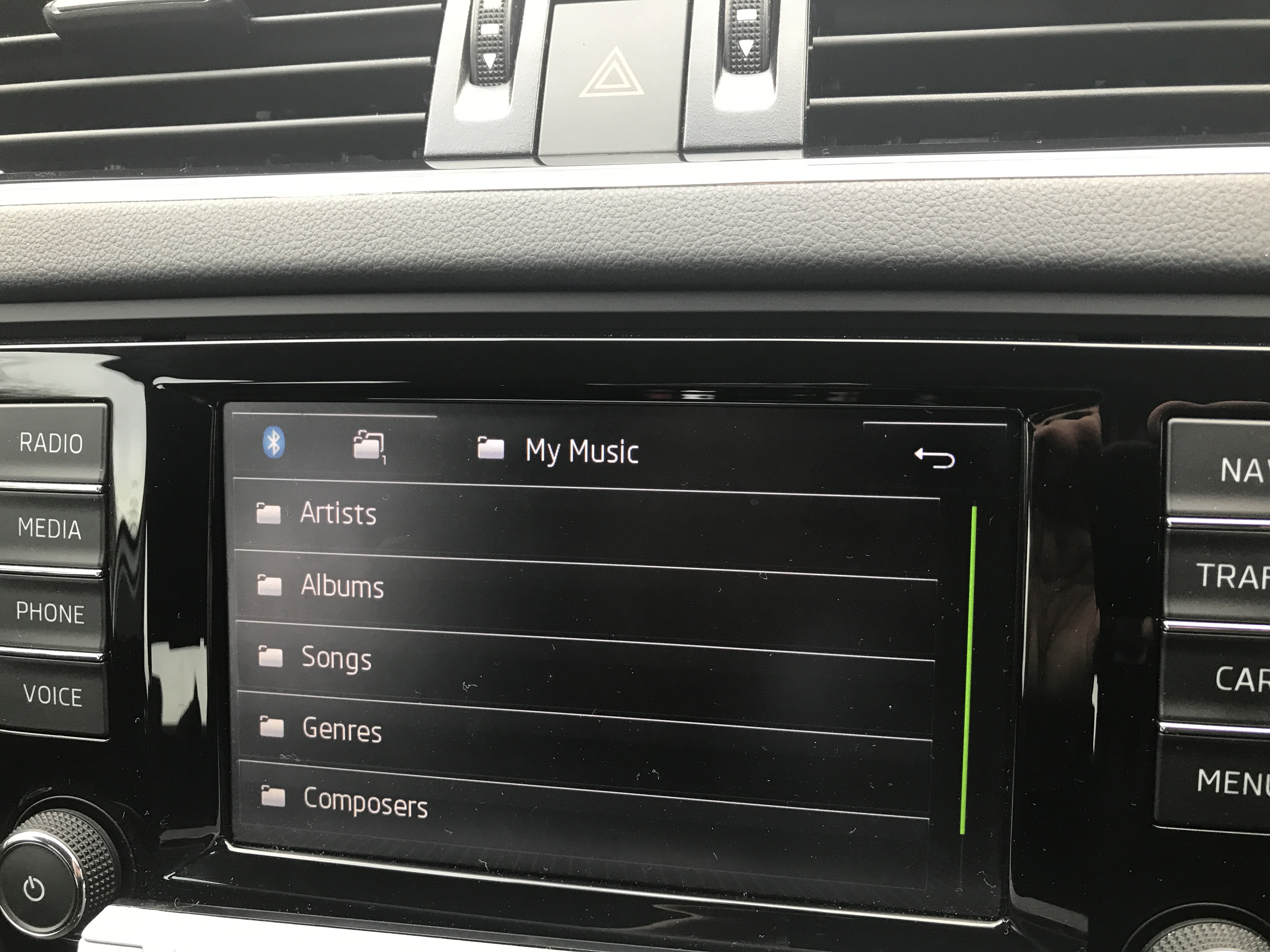

Using my MIB2 Amundsen I can browse all music stored on my iPhone using the Media bluetooth source.
This is exactly what I want!!! Am I doing something obviously wrong :wondering:

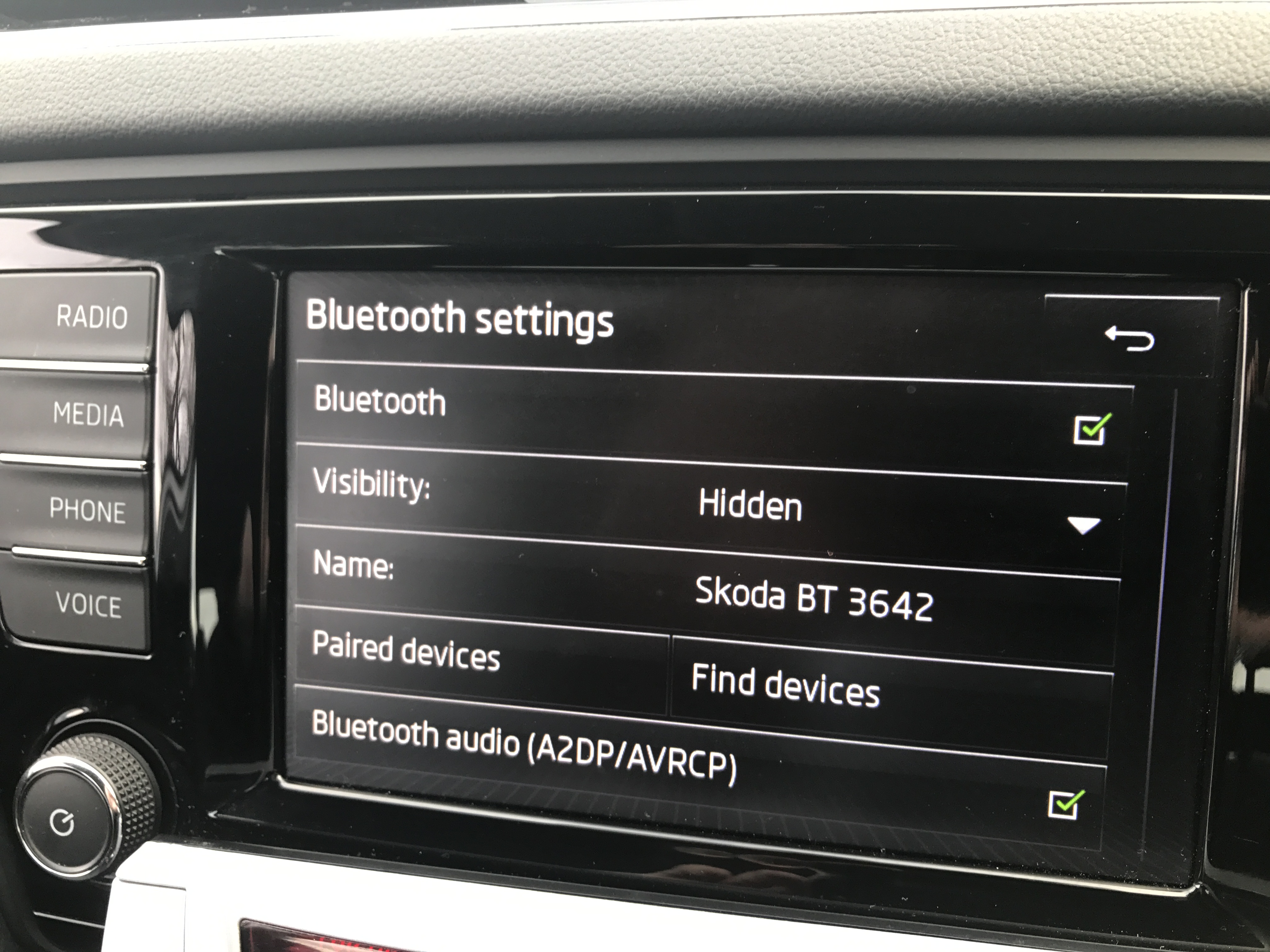

I see these options when I press the Media button and select BT Audio within the source selection. Also be sure and select bluetooth audio in the setup menu.

I had the same problem with my 2016 vRS 230.  My iPhone 7 paired OK, and I could pause/skip tracks, but I could not view music / podcasts / playlists on the Amundsen screen.  I did a bit of fiddling and I now have it working as expected.  This is what worked for me : disable A2DP / AVRCP in the Bluetooth settings, accept the warnings then enable it again, and select my iPhone as the Bluetooth source.
