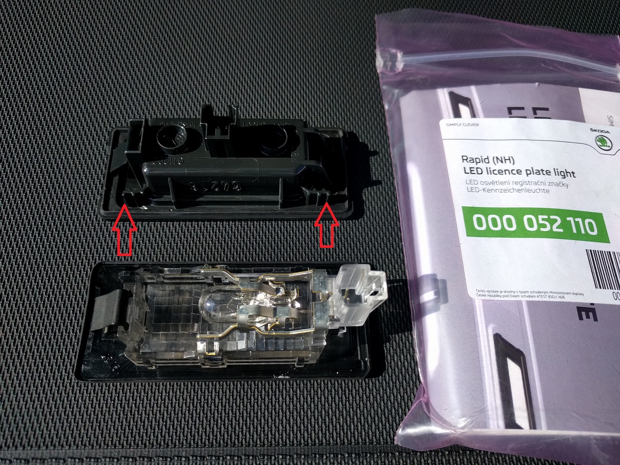

Fitted some Skoda Rapid LED number plate lights yesterday (see photo for code number) They needed the tiniest little bit trimmed from either side (red arrows) to fit properly.58ea51a33d78c_2017-04-0811_59_15.thumb.jpg.acec9005963ba4679cba4c79aeea01ca.jpg

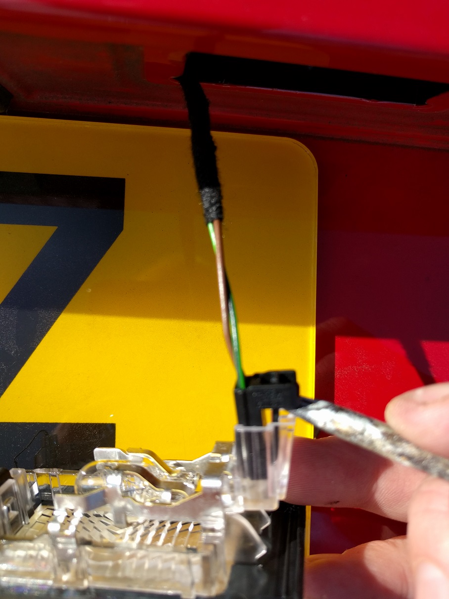

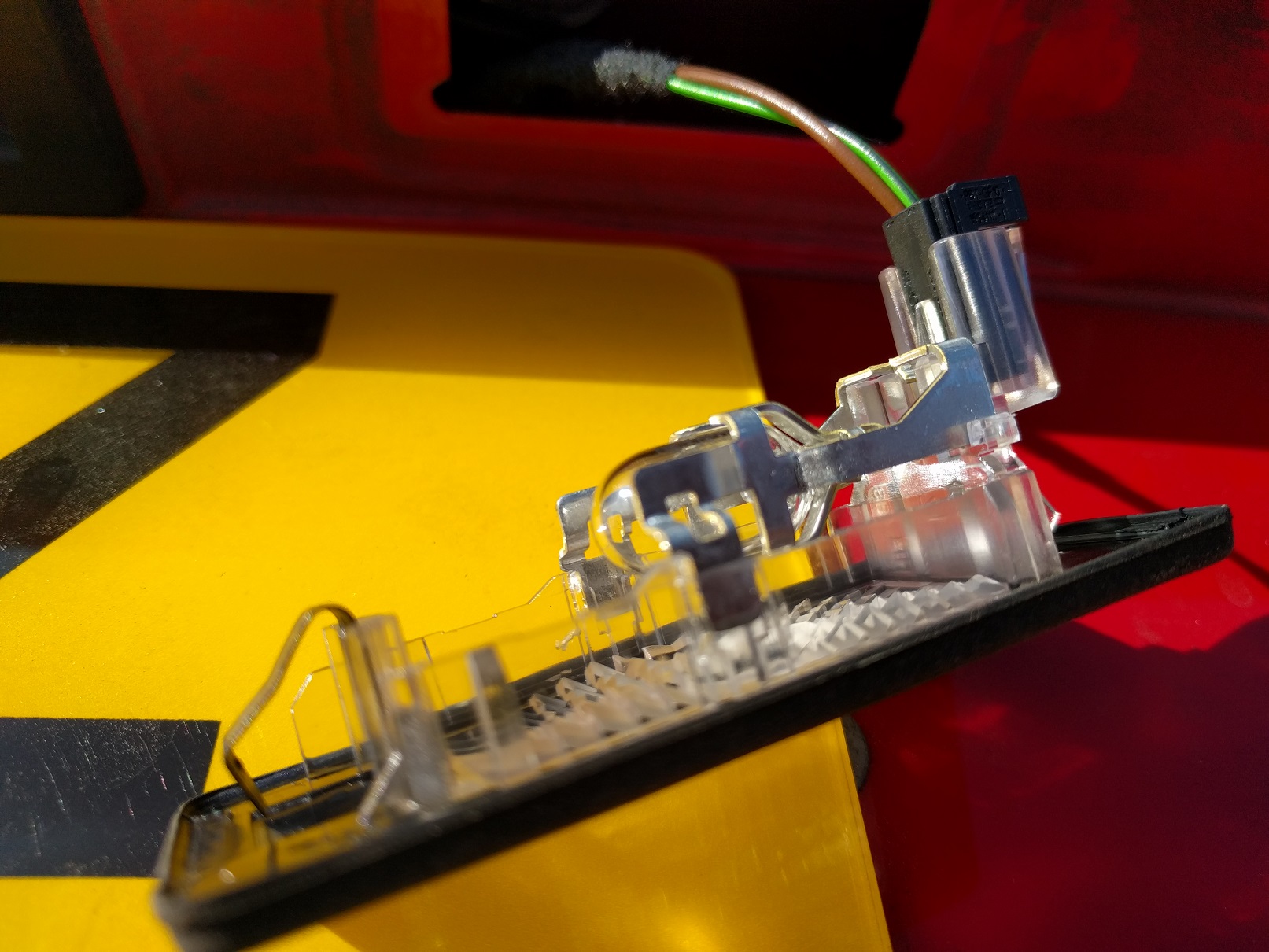

the connector is in a different place but easy to unlock with a flat screwdriver blade (sorry for the crap focus)

Agreed these look miles better! I fitted mine the other way around and they didn't need anything trimming off. They look more than bright enough for lighting up the number plate at night.
i tried both ways with no success until i used a craft knife to trim the vertical sliver off each side
