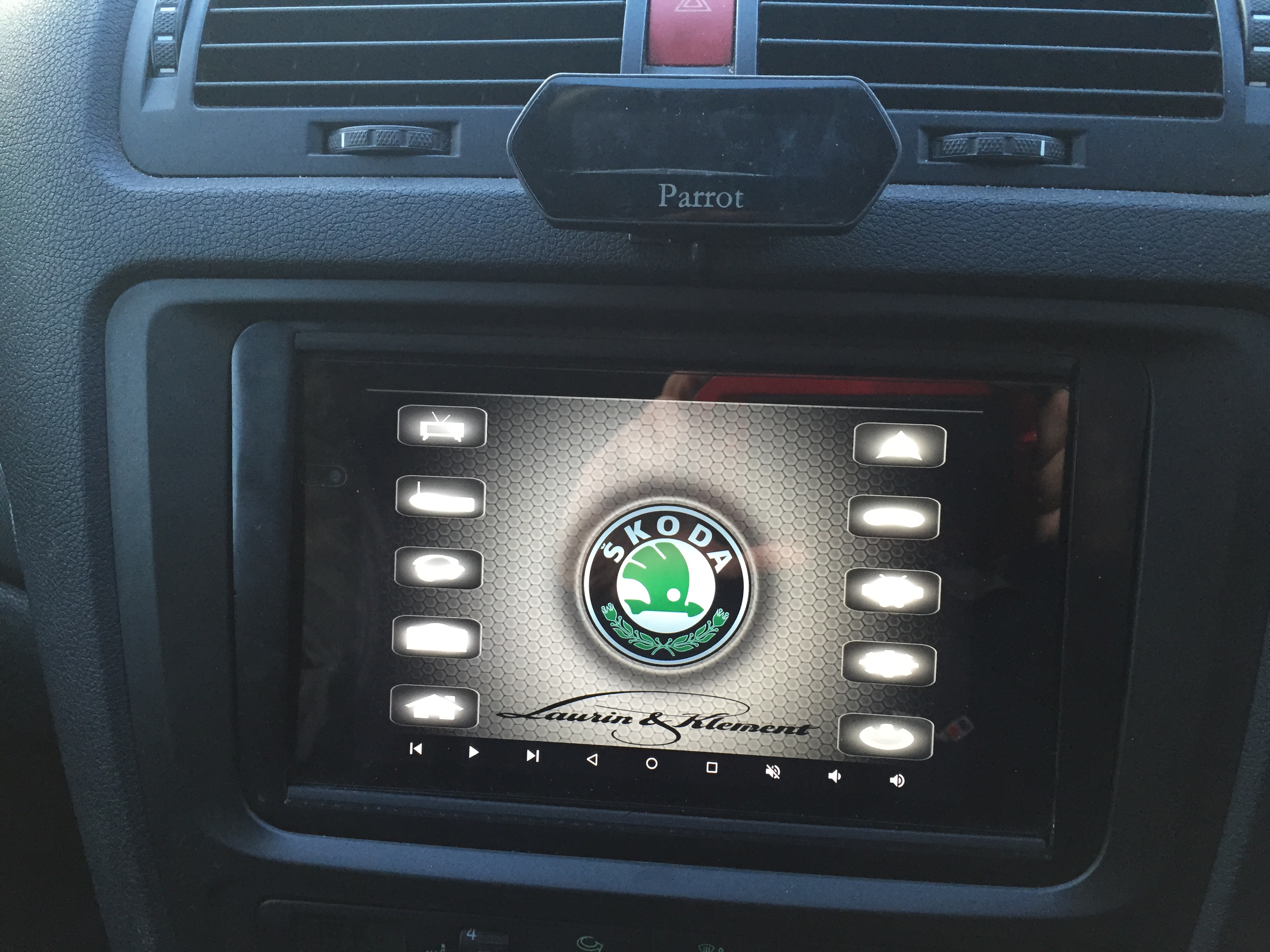

and attached a pic of the tablet in car in case anyone is interested to see how it looks
using timurs rom for marshmallow which is specifically for fixed dash installs ie otg and charge at same time, goes into deep sleep when ignition off and loses about 2% battery overnight, and starts charging when ignition on, monkeyboard for dab radio radio, usb digital tv tuner, 12 port usb hub, rear reverse cam via usb easycap device and rca camera, and dashcam via an android usb headunit dvr camera and a playstore app which background records displays time stam,gps,and battery info on recorded files, and audio routed via the aux -in on the parrot mki9100 and i can use the volume control on the parrot to control the tablets volume (if i didnt have parrot id have needed an amp to power my speakers, and something to be able to turn up volume ect without the need to touch the screen to do it)
homescreen made by me in photoshop, and the buttons are invisible shortcuts made in app desktop visualizer, and my launcher is nova launcher
overall im very happy with how the functionallity is, and was worth the time and effort for sure
but the final piece is regain my steering wheel buttons

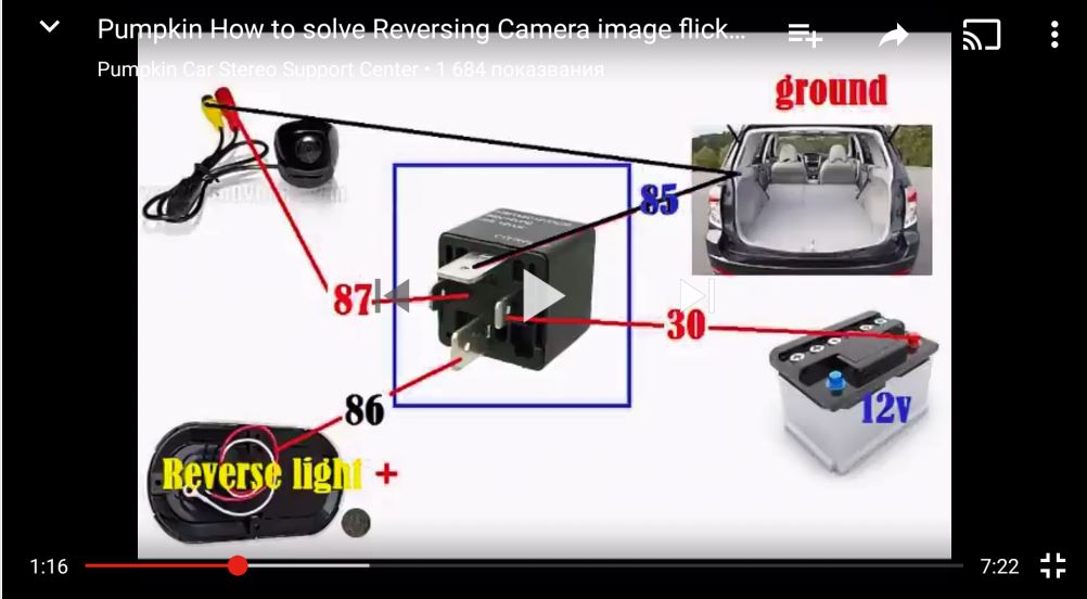

my reverse camera is wired for power from the boot couetesy light via a relay from reverse light, as only going straight from reverse light i only had picture when car was not  running due to PWM , and then video line goes to an easycap usb device into my hub in glove box and easycap viewer on the nexus 7, but i also used a relay on the 5v power of the eacycap device so the device is only engaged when reverse is, without the relay easycap device was always on, and was getting a tad warm, now it works flawlessly evertime revese engaged bout one second till image on the nexus, and when reverse disengage the easycap viewer app closes
got the 1st picture of getting power from boot courtesy light here on forum, second pic from a a carpc forum so used a relay in glove box on the easycap device usb extension wire, and 3rd picture is my next part to get my front and rear cameras to work in conjunction, one off one on so to speak, had todo the front and back this way as my rear camera normal rca rear cam, but my front is a usb android head unit dvr camera, just didnt want to use a poor quality camera on the front and the usb one is 720 resolution, number plates people ect ect can be clearly seen, unlike the reverse camera which high detail isnt really needed
 as for the mounting of the rear camera i just bought a one for a octavia that replaces one of the number plate lights, it is off centre due to this, but not a real issue as i still predominantly use my mirrors and just glance now and again at camera image mainly once lined up and for judging the final distance with the parking lines
