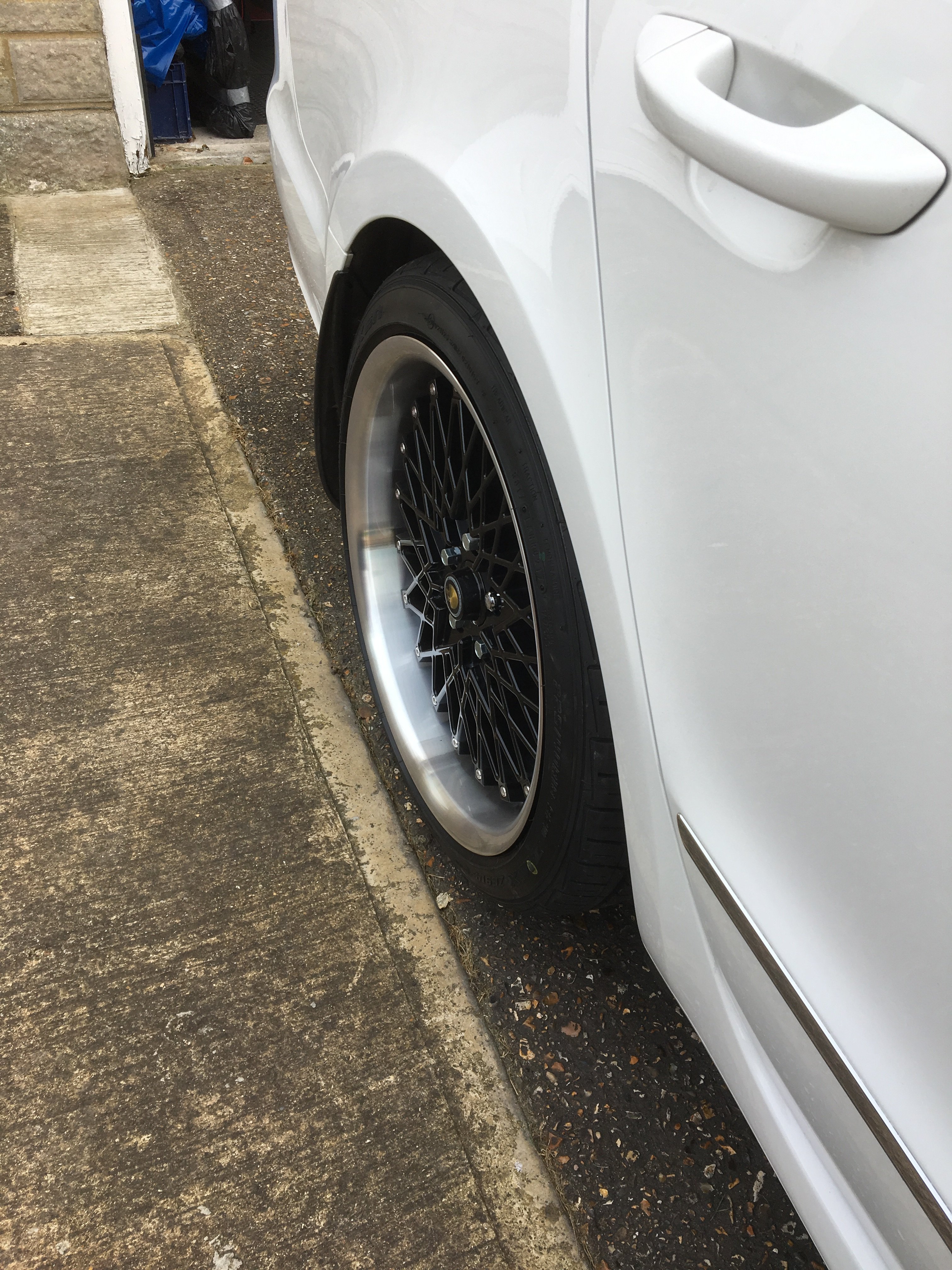

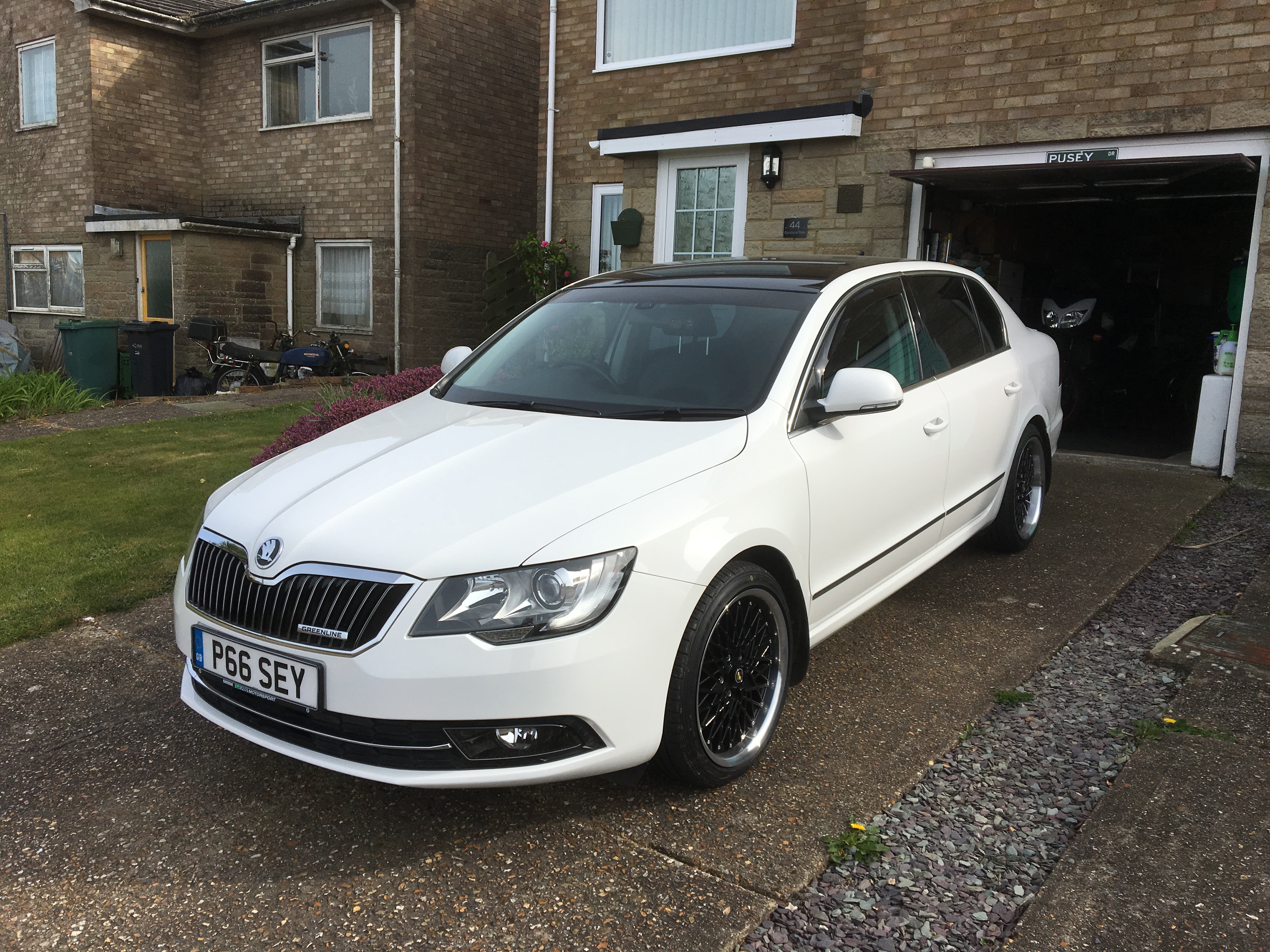

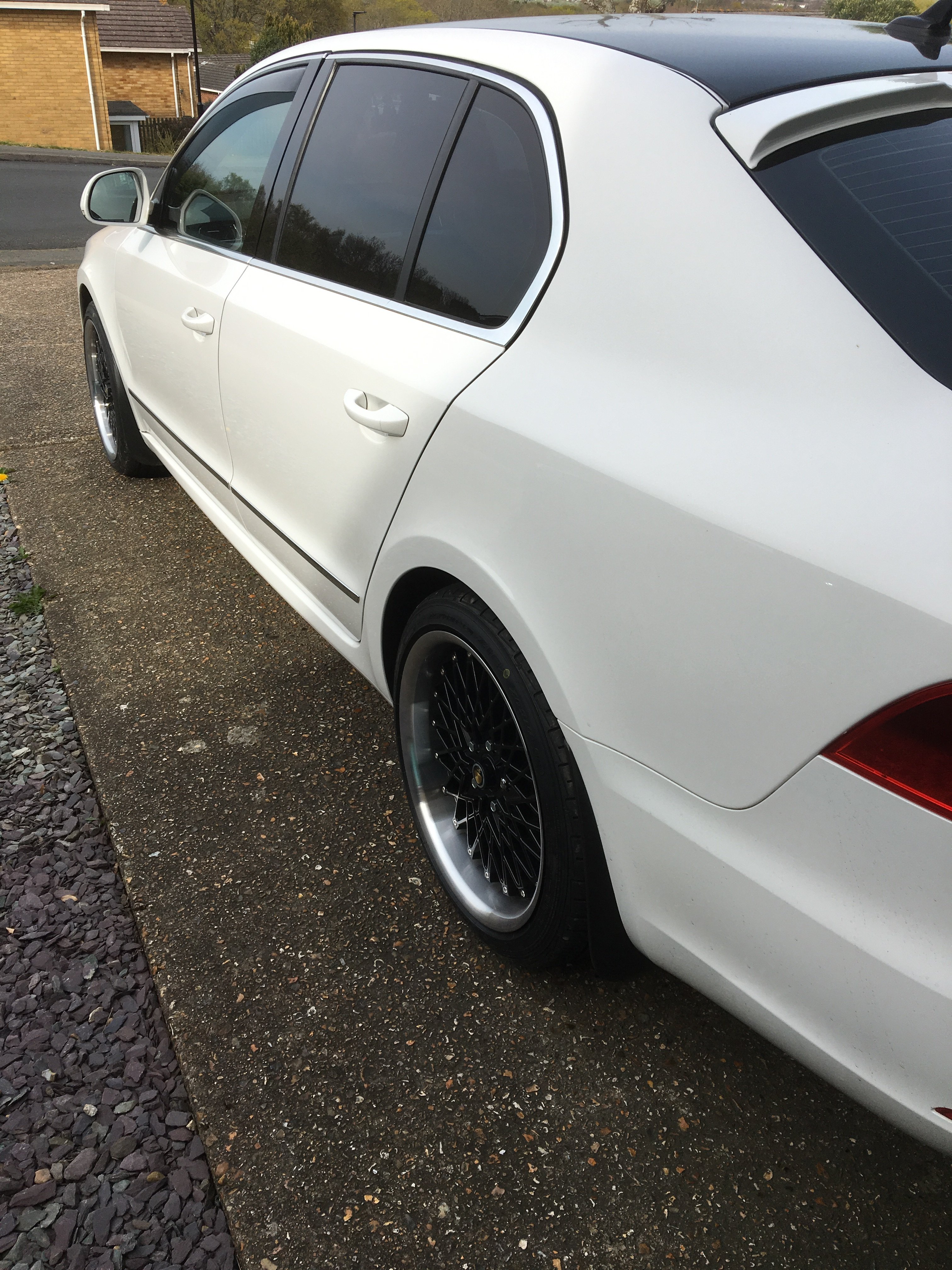

Finally got my Cades Zeus 18" rims fitted today , had to go for 3mm wheel spacers due to centre cap popping off when wheel bolts tightened , all good now and was well impressed with ride coming back from garage as I had tracking checked also.
purchased via stanced.co.uk , they were very helpful and gave me a great deal on wheel tyre package .
rear wheels are slightly deeper dish to give me the look I was after .
Nice! What's the spec? Width, offset etc?
Thank Matt,
18x8 5x112 et42 / tyres are 225/40/18 Falkens
Nice! You could probably push them out a bit wider with spacers. I'm running 20mm spacers on the rear of my Greenline with 7 1/2 x 18" et 46, 225/40/18
yeah possibly could go wider , but would have to get longer bolts etc and locking wheel nuts
