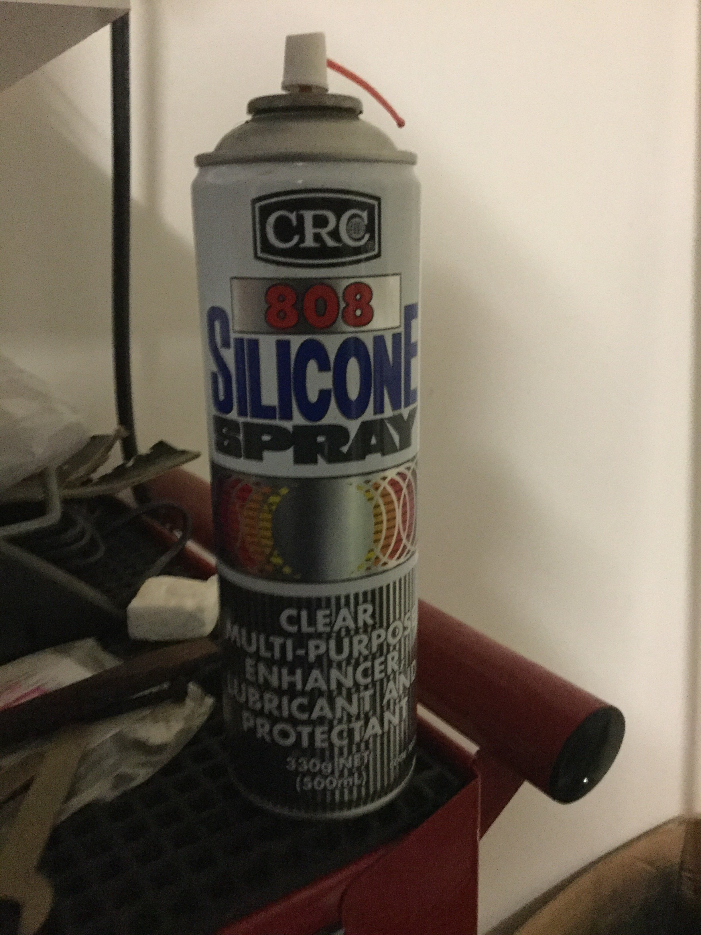

If it's the instrument cluster, particularly around the outer edges of the speedo and tacho, why not simply spray silicon 'dry  lube' into the narrow cracks and, like others, perhaps avoid the whole catastrophe of removal?.
It fixed mine.......permanently

I was wary of doing that in case it got onto the front face of the instrument surround and made it glossy, or even worse, got onto the lenses in-front of the gauges.
Or am I worrying unnecessarily ?
If so, is there a recommended brand of dry lube that doesn't cost the earth?
Please excuse my ignorance, but what exactly is "Dry Lube"?
Is it just a thin silicone spray?  There seems to be a phenomenal difference in price between brands of Silicone spray. Some call themselves "Dry Lube" and some don't (including CRC's product above).

The one pictured won't cause any problems...it leaves no sign
Specialist products tend to be a bit exy........the old adage; beware of substitutes, in this instance particularly.

Graham, there seem to be quite a few sprays including bike chain oils that contain Teflon, but many are just that, an oil that contains Teflon. I would think that they may not be suitable for use on plastics, whereas silicone is.
I have a very old can of Ambersil silicone spray that was originally intended as a releasing agent when casting into rubber moulds, but it's very "thin" and the nozzle won't take a plastic straw to aid accurate application. I don't want to get the stuff on the face of the instrument panel (or me!).
When I look up silicone sprays, there seems to be a whole rage of the stuff for different applications and with different viscosity.
Is "dry lube" a generic description for any silicone spray, or is it something specific?

It seems now that the description "dry lube" now means any lubricant that does not use oil as a liquid method of "transport". Ours was a Teflon base in liquid that evaporated after spraying, so leaving a film of Teflon only. Because of my involvement with that company I am now very wary of some of the descriptions of some "dry" retail products.
One of the problems with silicone is that it "migrates" so even if you do spray it in a very small area it gradually "creeps" across a bigger area. There certainly are "dry" Teflon based sprays on the market and I'm sure I have seen one in Halfrauds. You need to read the labels, I'm afraid.

Thanks Graham... you've confirmed my suspicions - I'll check descriptions carefully to find an appropriate product.

The CRC product has been used successfully by others also.....the straw helps getting at the difficult spots.
Don't get it on any control surface though eg steering wheel or brake pedal.
