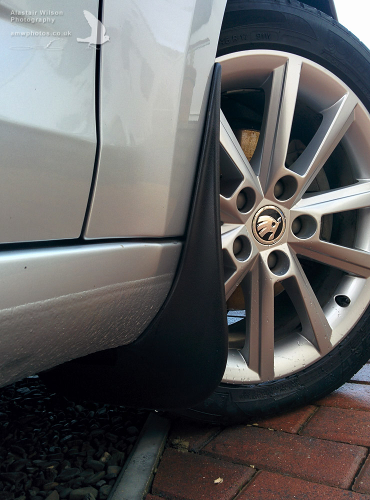

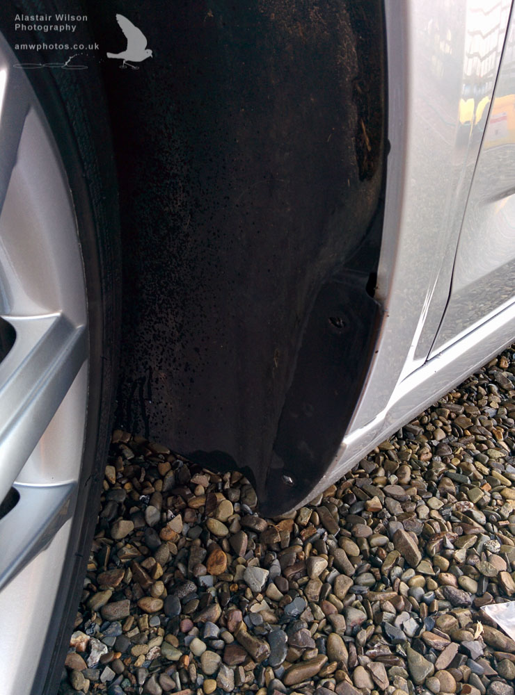

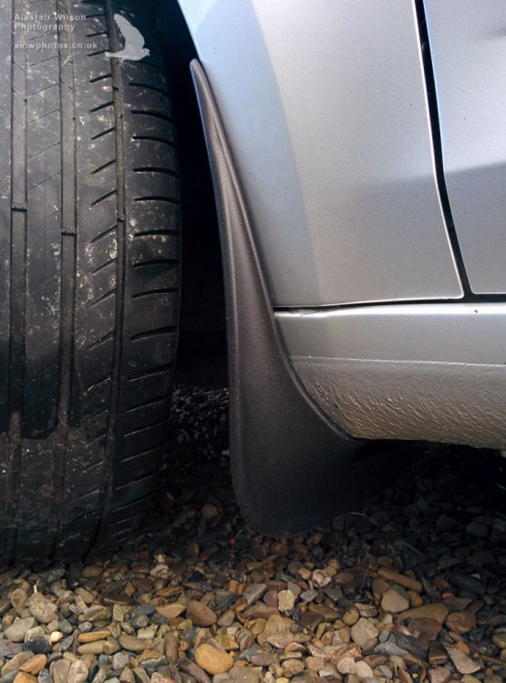

Mudguards were first, I live in a rural area and mud and muck on the roads is very common. They were a cheap buy from superskoda. I phoned the garage and they quoted a ridiculous price to fit them.
With the wheels on full lock one way you could reach the outer two screws, then on the opposite lock reach behind the wheel to drill the 5mm hole to put in the included plastic push fit retainer. I used a hand drill, it's only plastic wheel arch lining so really easy to do.
Should help stop so much road muck spraying up the sides of the car.

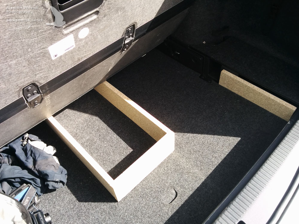

The variable level floor is really handy, and while on the test drive I discovered that with the back seats down the load area is completely flat, and that there is space to sleep in the back, I'm 6 foot tall, and fit easily! The salesman apparently hadn't seen anyone laid down in the back of an octavia before.
However, there appeared to be a bit of flex in the floor, when loading bags of compost. The only support is the loading lip, and two flaps that hinge out slightly from the sides. This doesn't help support the most vulnerable part, the hinged sections. So I decided to make some supports. Having some spare 18mm chip board I cut two pieces for the edges. This lower section is 11cm deep at the back. They tuck behind the lower carpet which holds them in place too. Then I made a long narrow box to support the middle. This was more tricky as the depth goes from 11cm at the back to 10 cm halfway into the boot, so the box is slightly tapered. It also makes a handy place to chuck smaller items that you don't want sliding around.
A coat of black paint will get it looking a lot smarter, and I may even hinge it so that you can get into the spare wheel void without removing the support box.

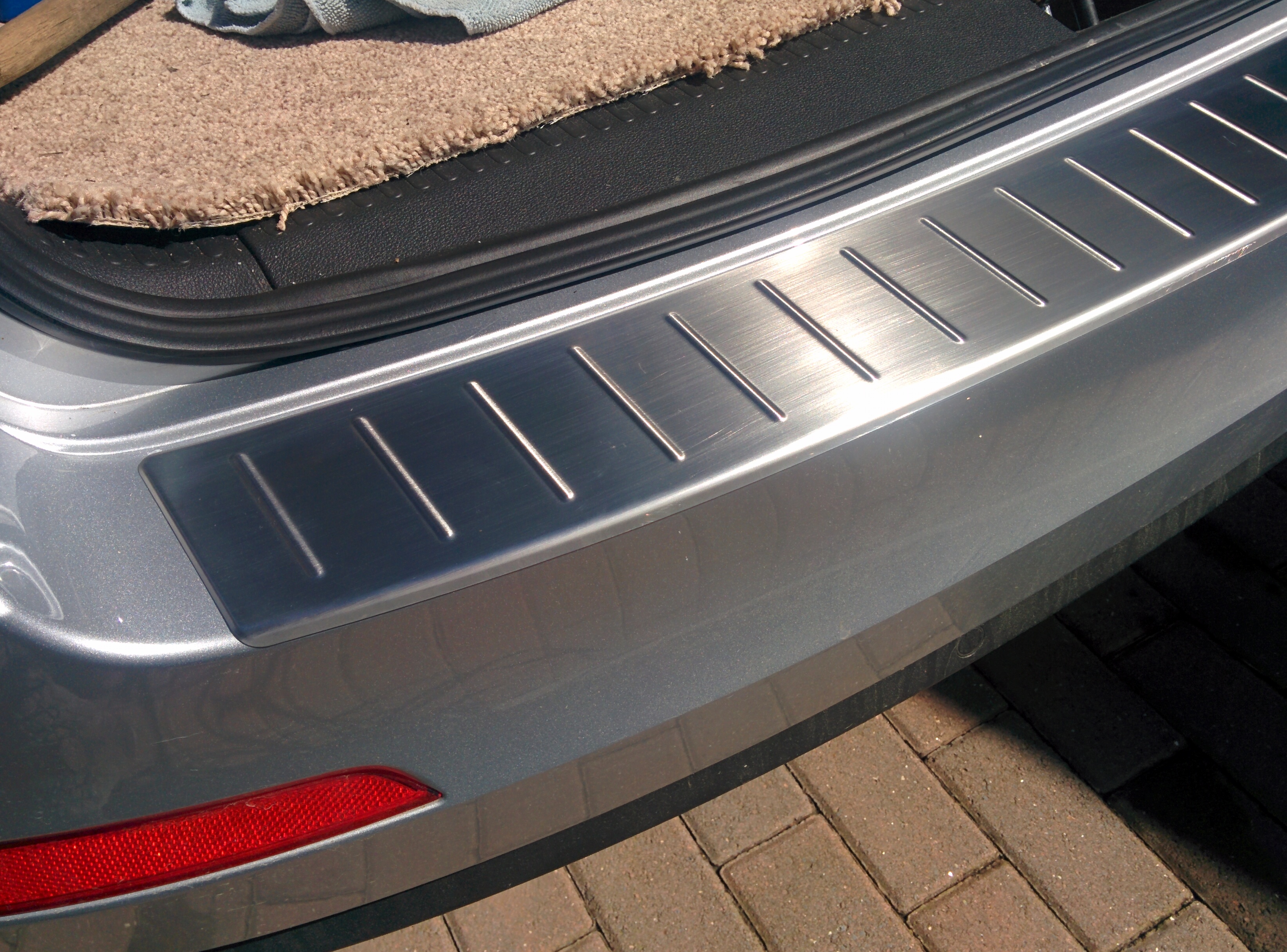

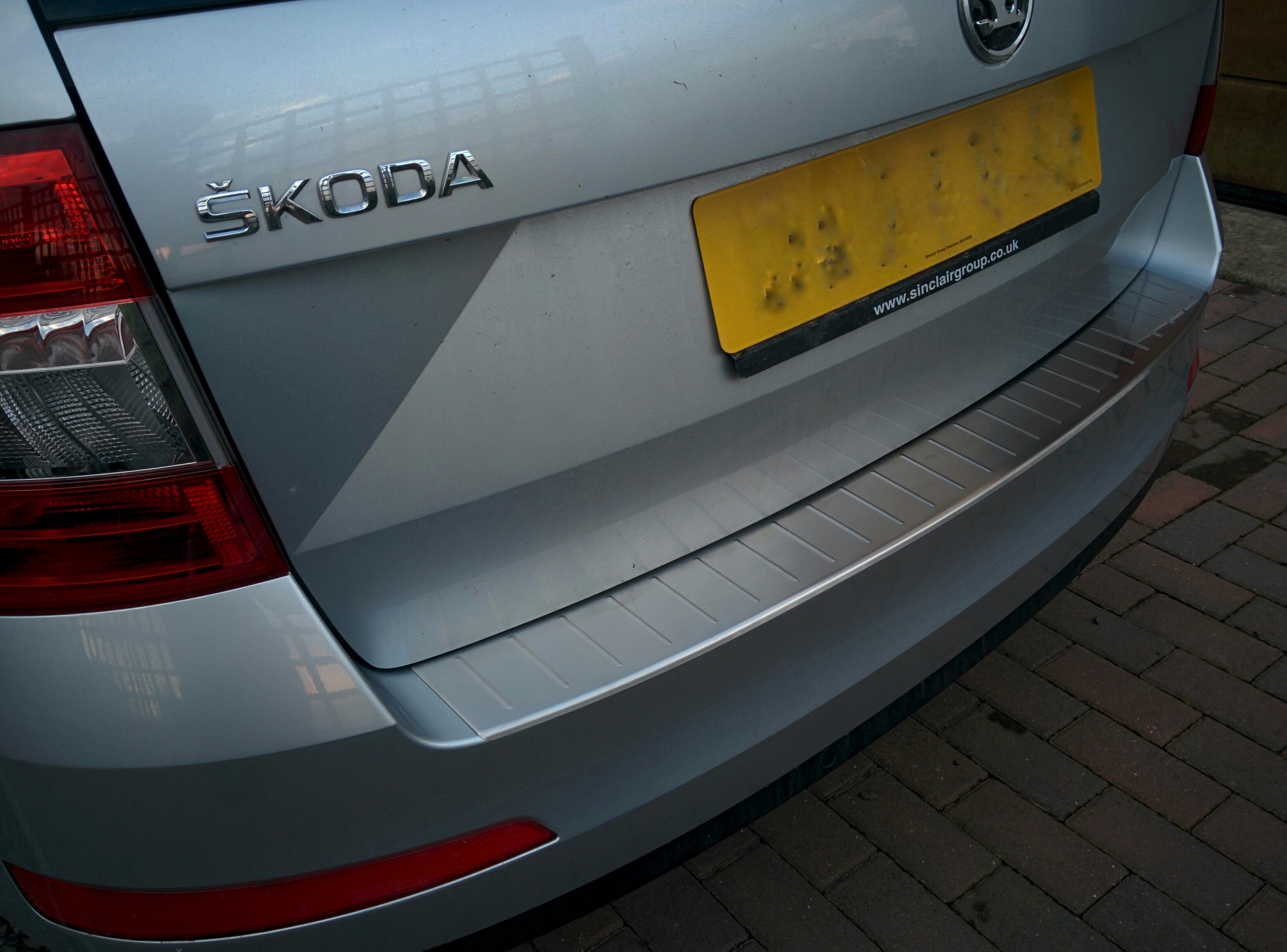

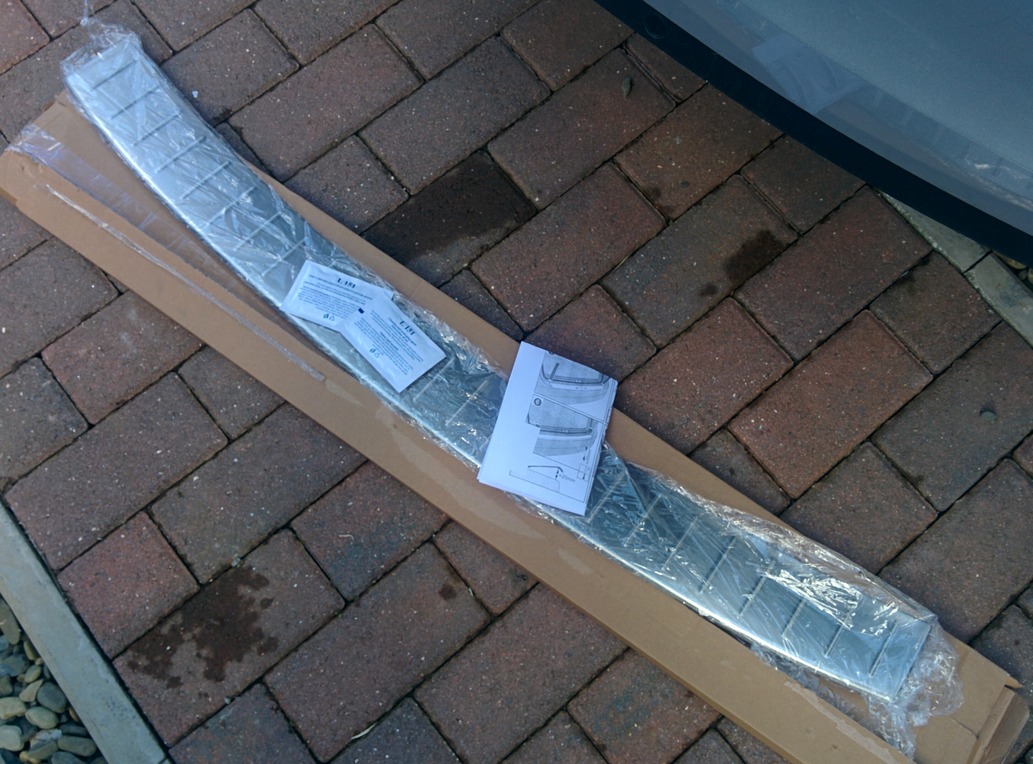

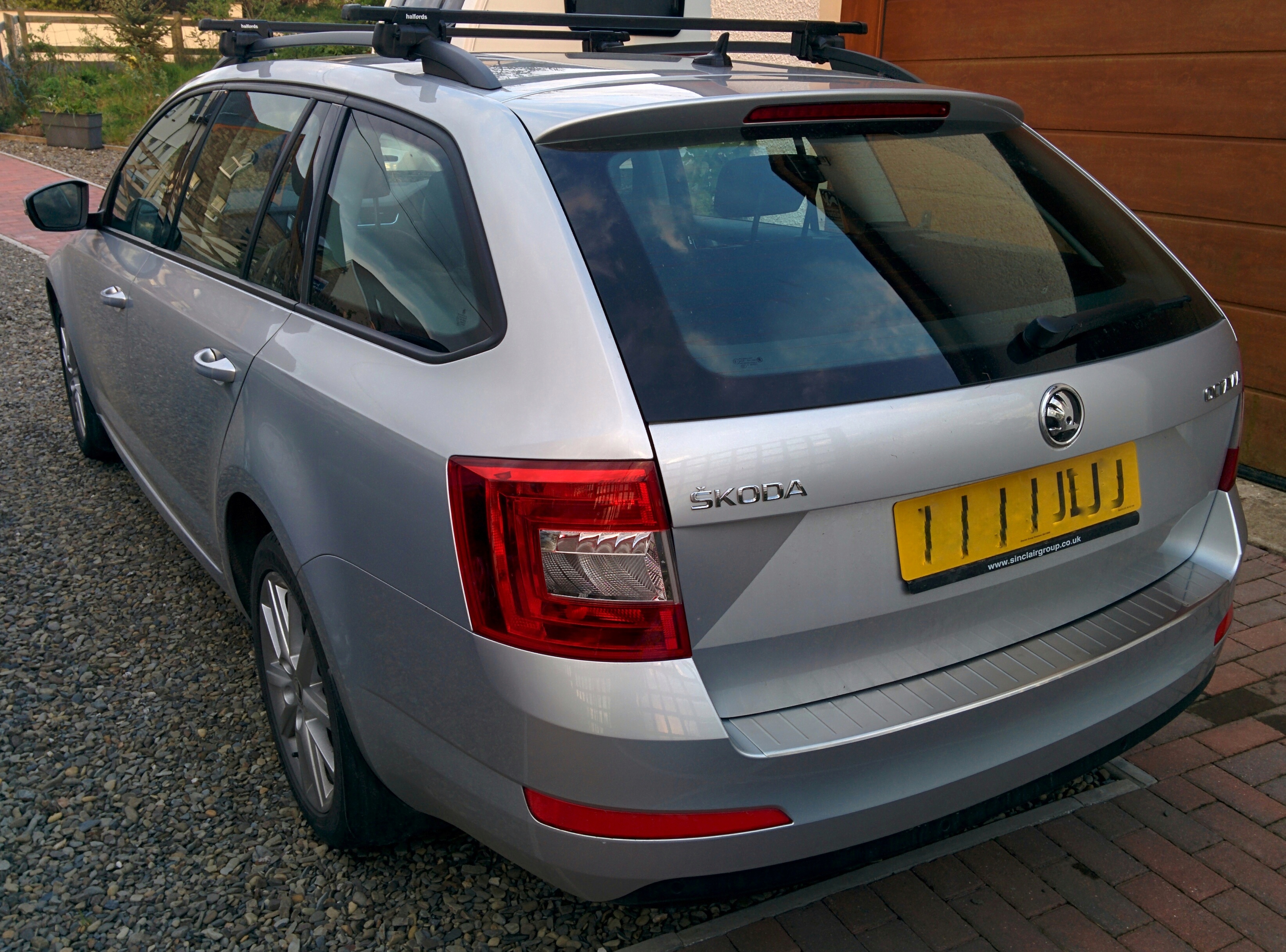

I ordered a stainless steel rear bumper protector (O3C-RBSILL-V2-RS6) from superskoda http://www.superskoda.com/Skoda/OCTAVIA-III/Octavia-III-Combi-massive-stainless-steel-rear-bumper-protective-panel-V2-RS6-MATT-version
Most protectors don't seem to protect the edge of the bumper, which i think is at most risk of damage, but this one does.
Frustratingly when it arrived there were no instructions or primer as mentioned in the advert, although they did then send these out separately when I complained!
It has taken a while for me to fit as it needs to be attached when the temperature is above 18'C, so summer or warm garage only.
Check for sharp edges, and wet and dry these smooth now, especially the edge that curves over the edge of the bumper. Trial fit it to get the placement right, and mark the edge with a pencil so you know where to position it later. There is a gap between the inner edge of the bumper and the steel plate, so don't butt them together as the lip won't sit on the edge!
Clean the bumper, they advise using benzene petrol, and not meths. Then wipe with the primer wipe, one direction with one side, then again with the clean side.
Peel off the adhesive strip backing, line up the back edge and slowly lower on to the bumper. If you make a mistake it will come off with a hefty leverage. Press it on tightly.
I think the stainless works well with the silver, and there are a few other rs6 style accessories you can get too.
