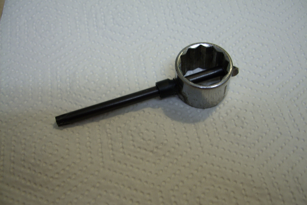

Fancied fitting a new one of these rollers on mine so I bought one. However, it's so close the the side of the engine bay that you can't even get a socket on the bolt. The bolt head seems to be 21mm and it may be possible with a cranked ring spanner but I don't have one in that size. Even then, the bolt is 19mm long and I doubt it would clear the side of the engine bay. I'm going to have to remove the arch liner and lower the engine to get a socket on.
Bingo! I made a tool to get the bolt out in situ. I cut an old 21mm spark plug socket down and drilled a hole through it to insert a rod (an old Torx key). I used a bit of tube as a lever over the rod and it got the bolt out really easily. I can confirm that there is just enough room to pull the bolt out. Obviously you can't use a torque wrench on refitting with this method but you just sort of know how much to tighten the bolt. Whatever you do, don't forget that the bolt is left-hand thread or you could snap it or strip the threads in the aluminium timing cover. And use Loctite on refitting.
Once the bolt was out, the pulley just slid off with the fingers.
Interestingly, the brand-new VAG pulley bearing makes a sort of moaning noise (regardless of belt tension) a bit like belt driven PAS pumps. Can't hear it once moving on the road though.
tony_gardner - if you want to use my home-made tool I will happily post it to you. Just message me here.
