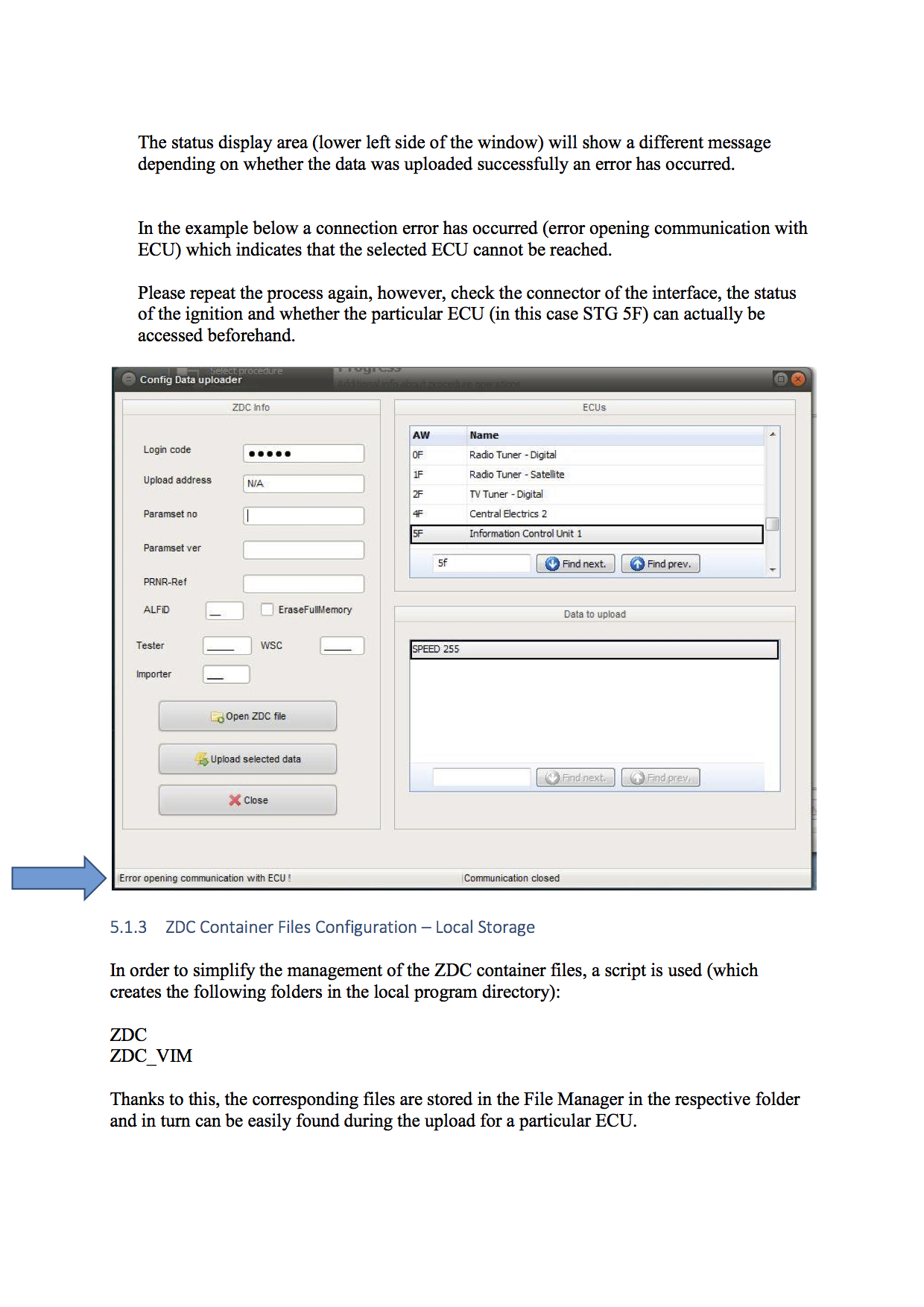

I tried to unlock the VIM with Vag Can Pro but I can not get it because of this error "error opening communication with ECU"
how can I do?
I put the picture of the error
Octavia 3 2013 / columbus mib1 / VCP 5.5.1

Are you using genuine VCP?
I have only done this on 3 different models (all MQB) but all took the coding without issue. (following the instructions)
you will need “VCP Pro + VIM"
The cable I do not know if it is genuine because it is not mine, I lent it to him, I know it has version 5.5.1 and you do not upgrade!
I suspect there is your problem then... it’s a hacked copy
Alas - VIM manager on my genuine cable works flawlessly...
