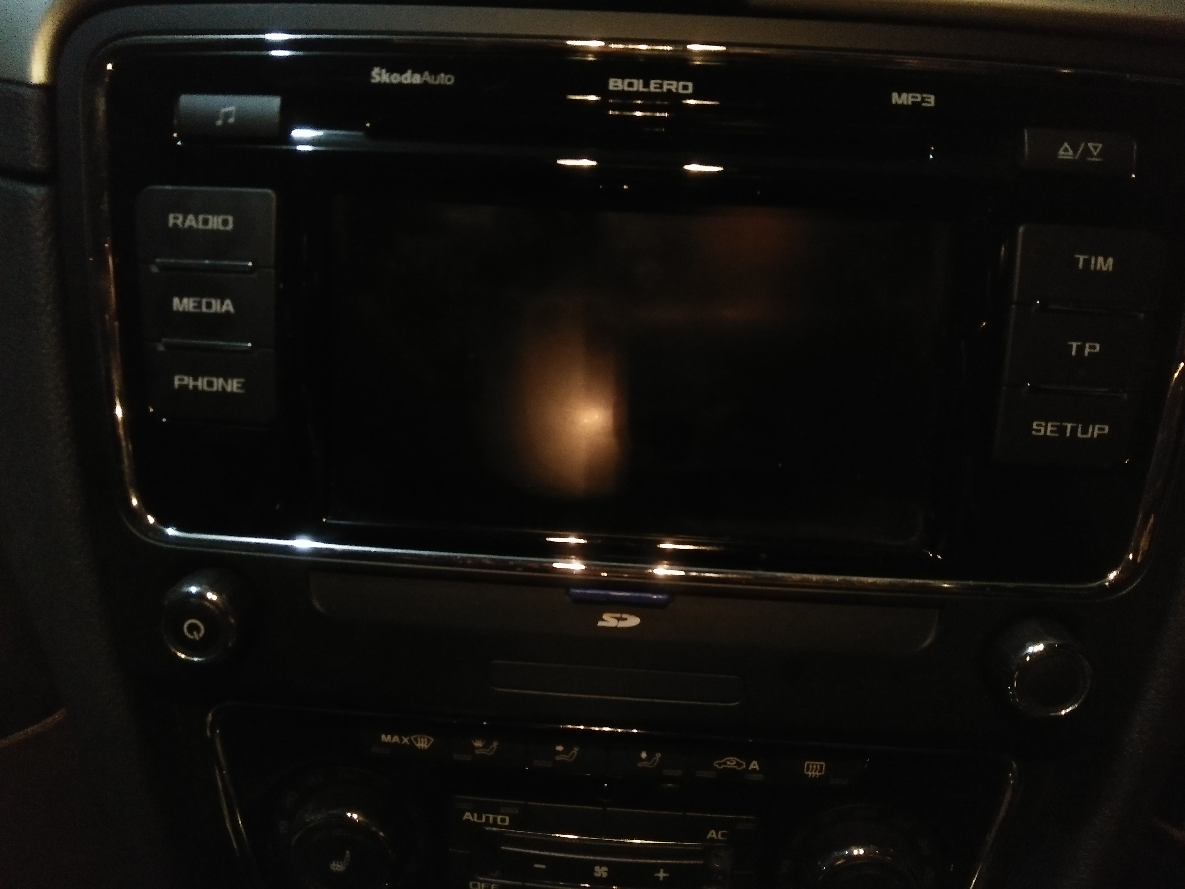

It's 2011 Skoda Superb 1.8 Petrol. I've attached the pic of stereo.
Hi,
You can upgrade up to a Skoda Columbus headunit which will give you nav and Bluetooth (will require an additional Bluetooth unit unless already fitted) or you can install a Android unit like some of us have done.
