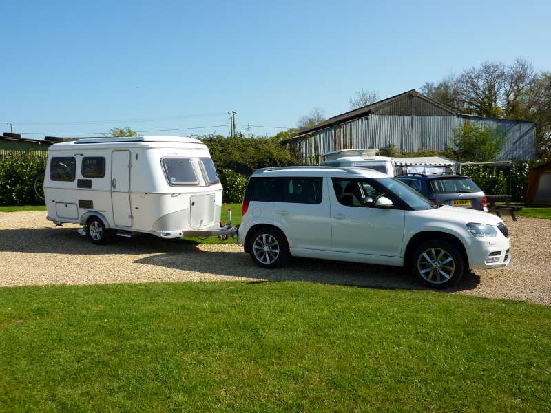

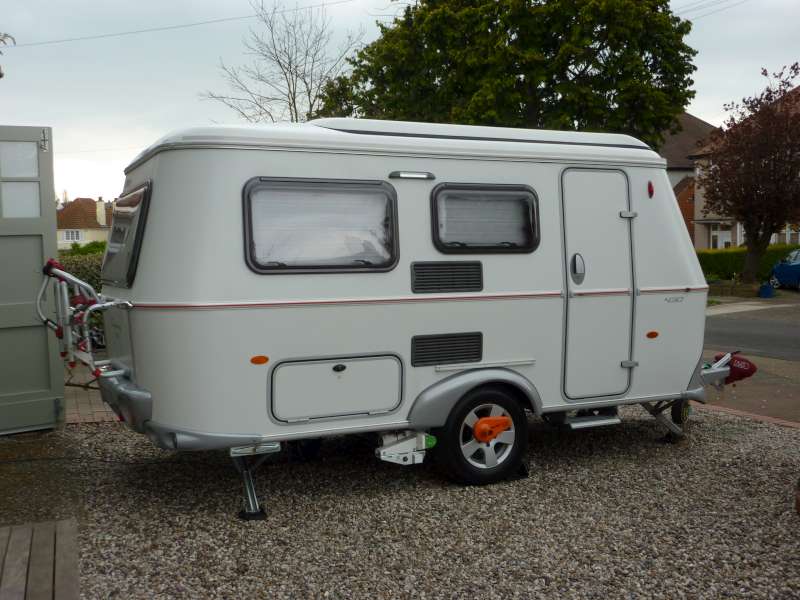

As that Mr Gumdrop I [still] tow an eriba but with a 110bhp 2.0L diesel. The current van is 1200kg fully loaded, but running around 1050/1100kg I have got 38/41mpg at UK speeds. This is similar to the mpg with previous 900kg eriba.
I did consider the 1.2tsi engine but eventually decided against it. I believe it would "cope" but no more. The current VW 1.4tsi though would make me reconsider. It has the same torque as my diesel and across wider rev ranges through the gears.
If you want a lightweight caravan have you considered an eriba. As well as looking interesting, being well built and easy to tow they go up in value. I have sold my previous three for more than I paid for them.
