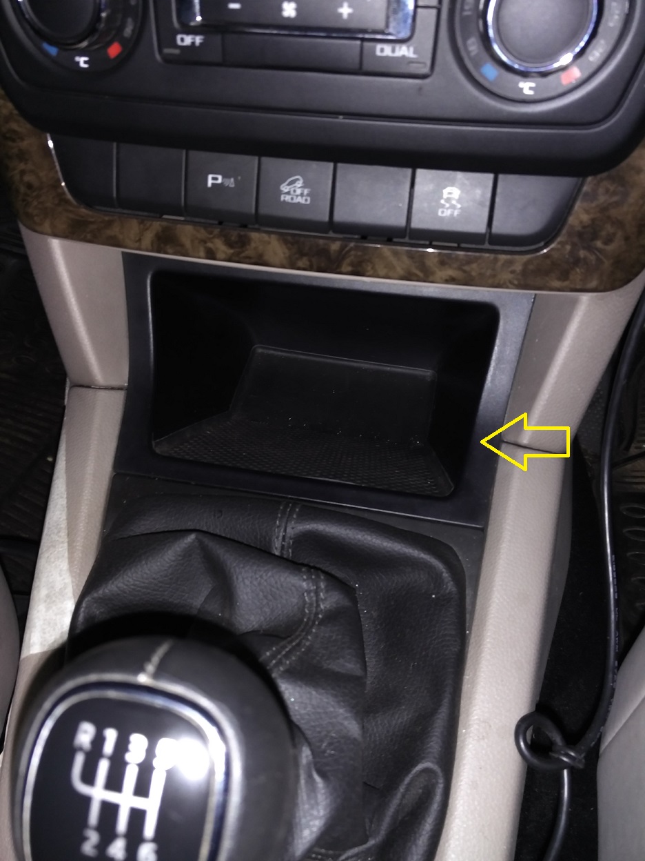

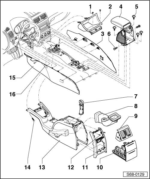

Could someone give me an idea about how to take the little storage box out ( The one below the off-road buttons and in front of the gear stick )? Skoda Maintenance manual shows the parts, but does not explain the sequence to dismantle them. I am confused, where to start !
Looking at the breakdown pictures, you need to remove 13 first, as the bottom screws are below that.

Think  he means the one under the dash!
Just unclip the gearstick gaiter to reveal 2 x screws, remove these, and the the box slides out!
Thanks . It works.
