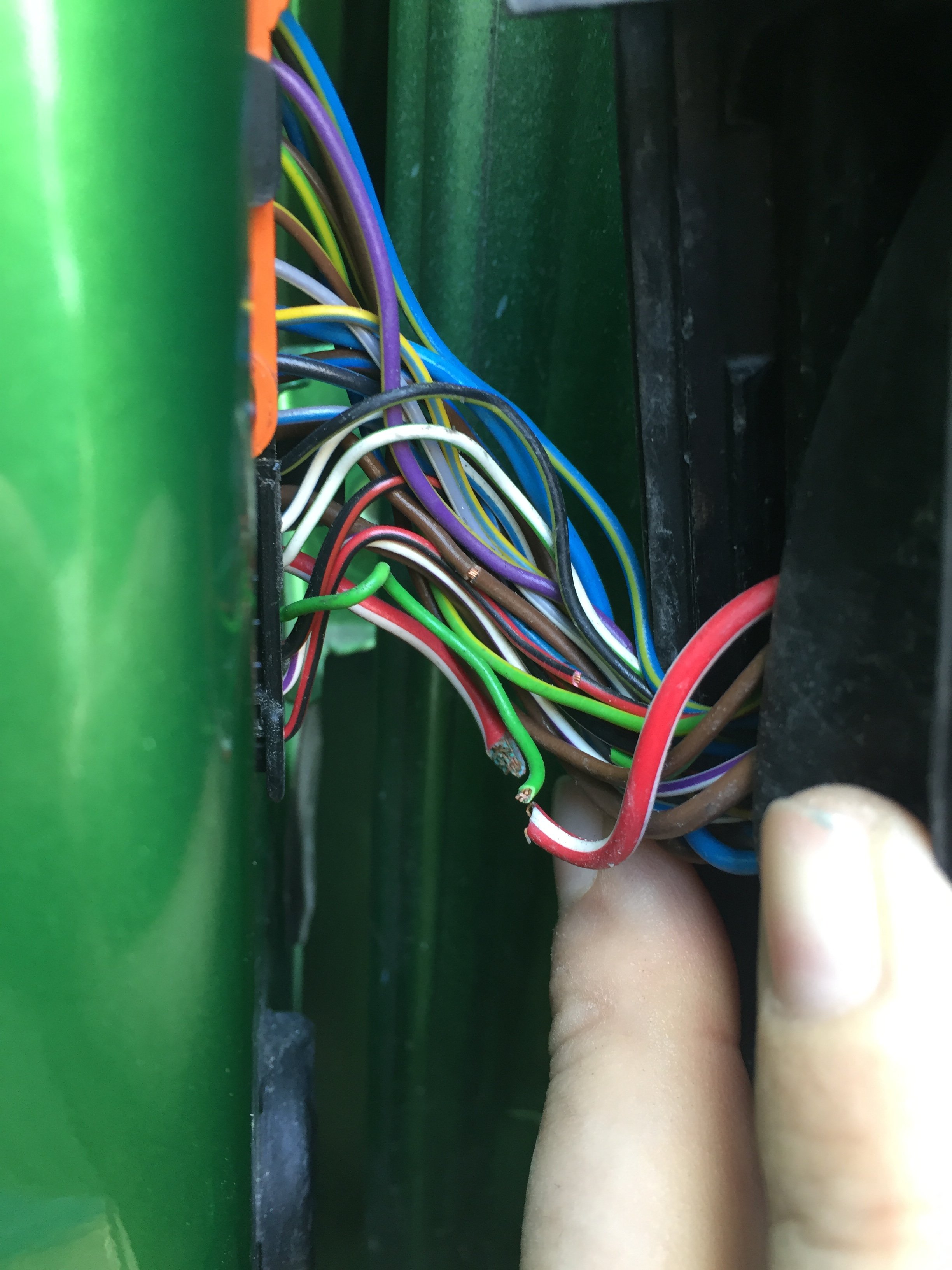

Just an update to this. Been out this evening and had the door card off. The car gave implausible signal on all doors prior to this.
Have checked and two wires had frayed insulation but not broken.  Have reinforced the insulation and put it all back. No errors yet. I suspect i will be taking the loom back out at some point and soldering them up. But good enough to get the wife sorted till I get more time.
Much easier to get the card off than my old superb!
Yeah mine need soldering up......!
@S27VEJ that is significantly worse than mine! Might be easier to whip it out and do it on the bench.
Im not doing it....electrician friends guvvy job for the weekend!
