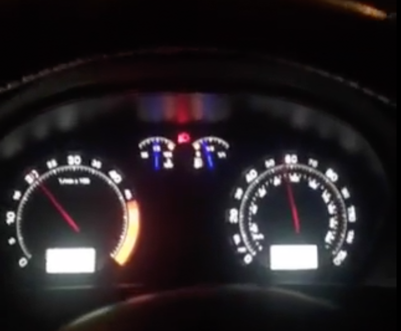

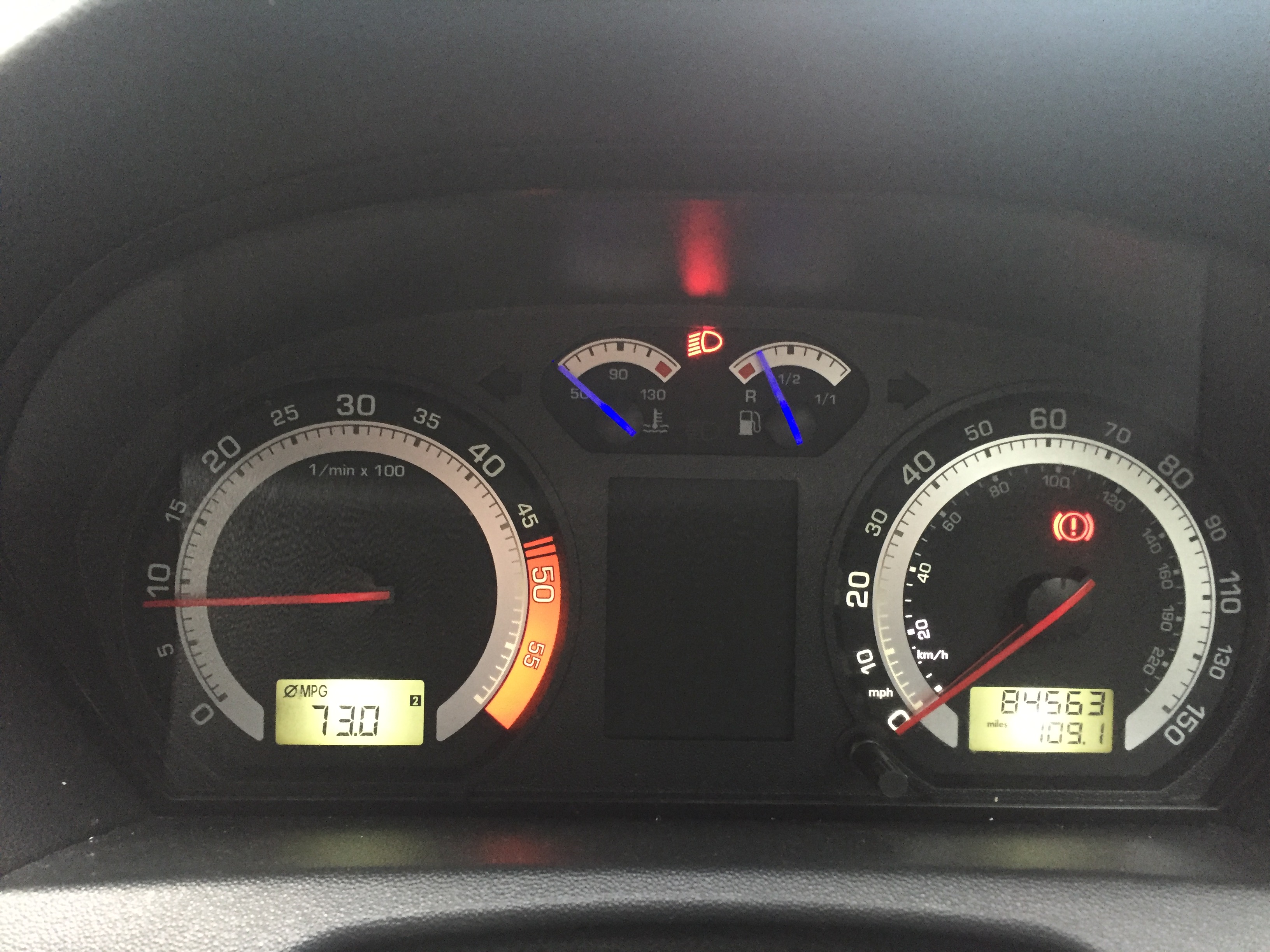

The clocks, window switches and door lock led have all been colour changed mainly to bright white lights and red for the indicators. Whats involved in reverting these back to standard?

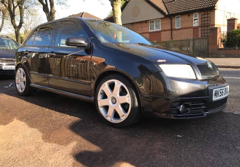

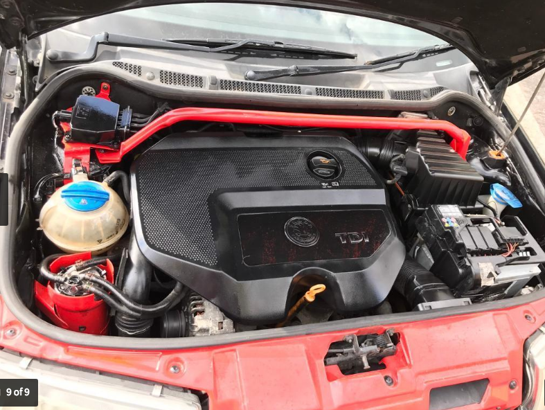

On the hunt for some standard VRS alloys, the Audi ones will be up for sale and the engine bay trips returned back to black rather then the ghastly red! Lowering springs have also been removed for now back on standard suspension.

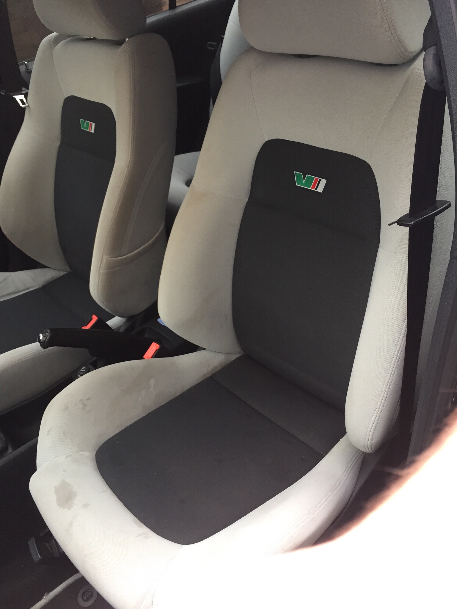

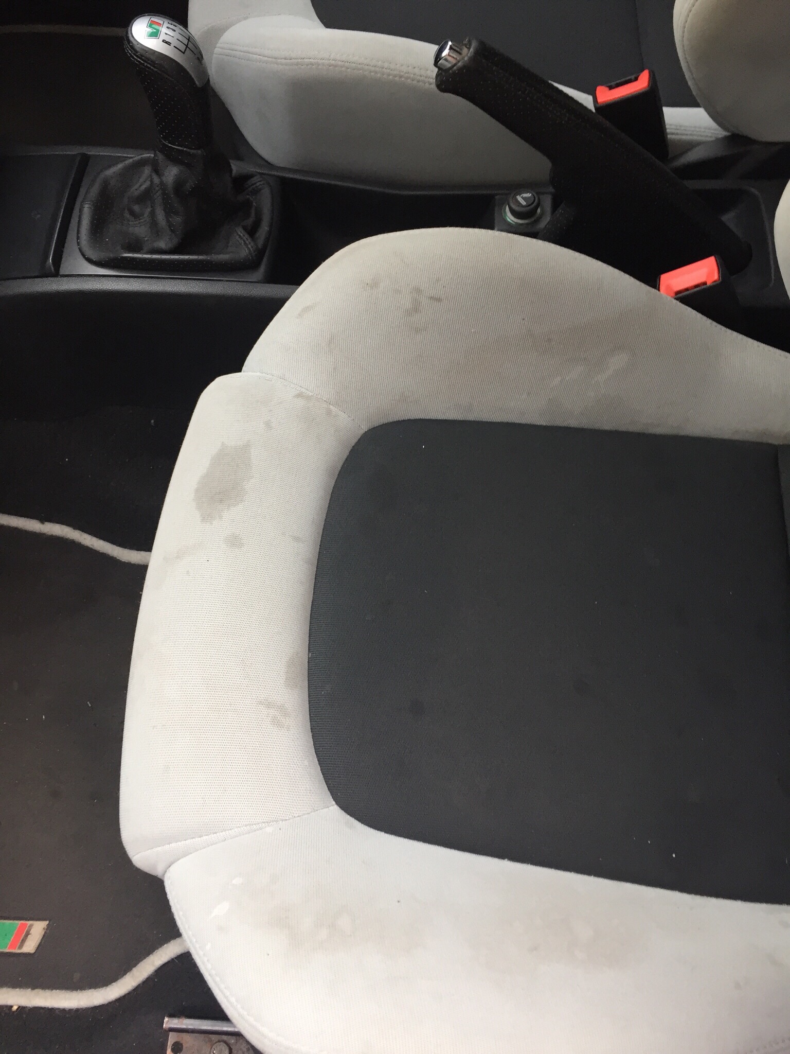

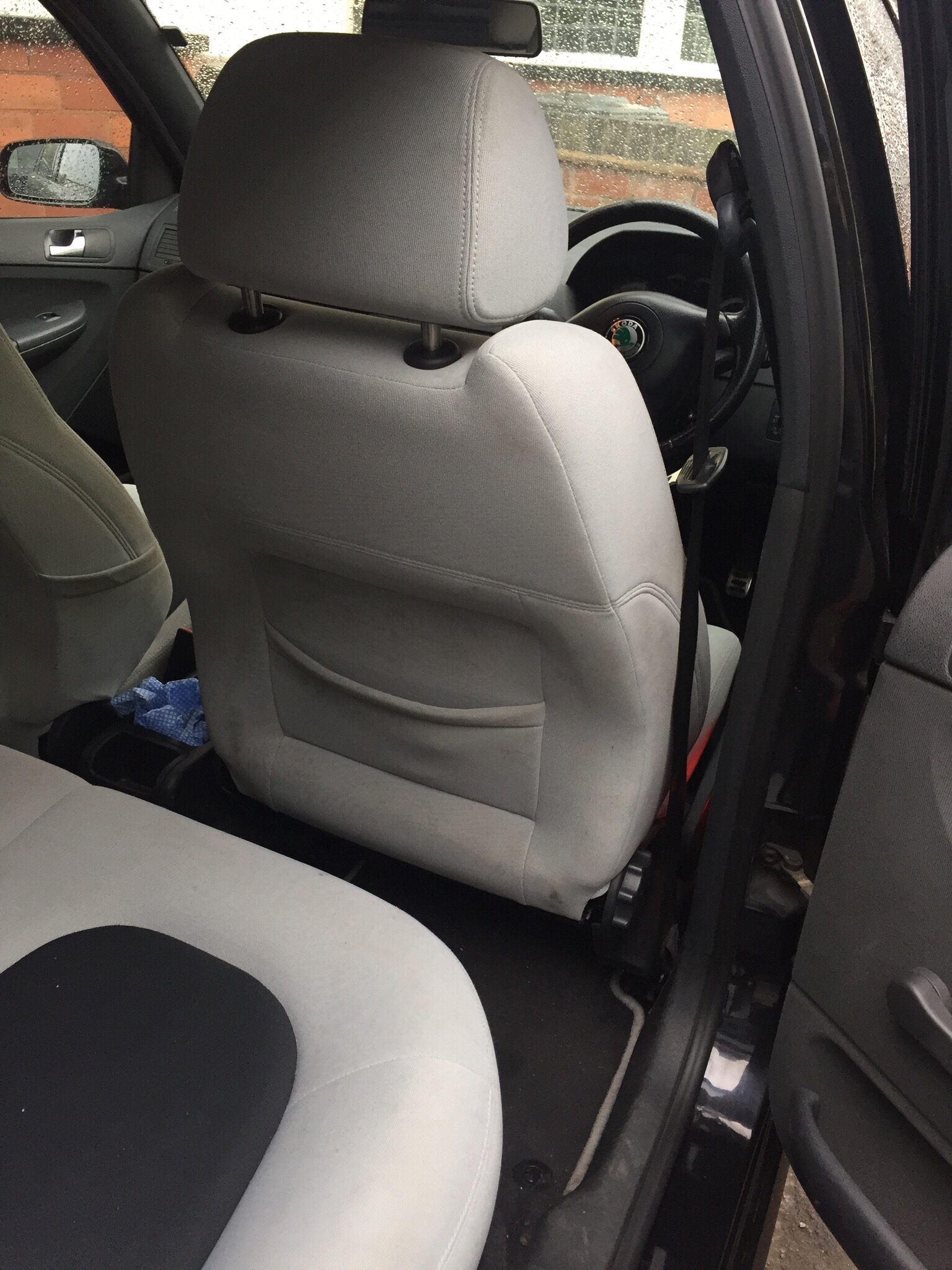

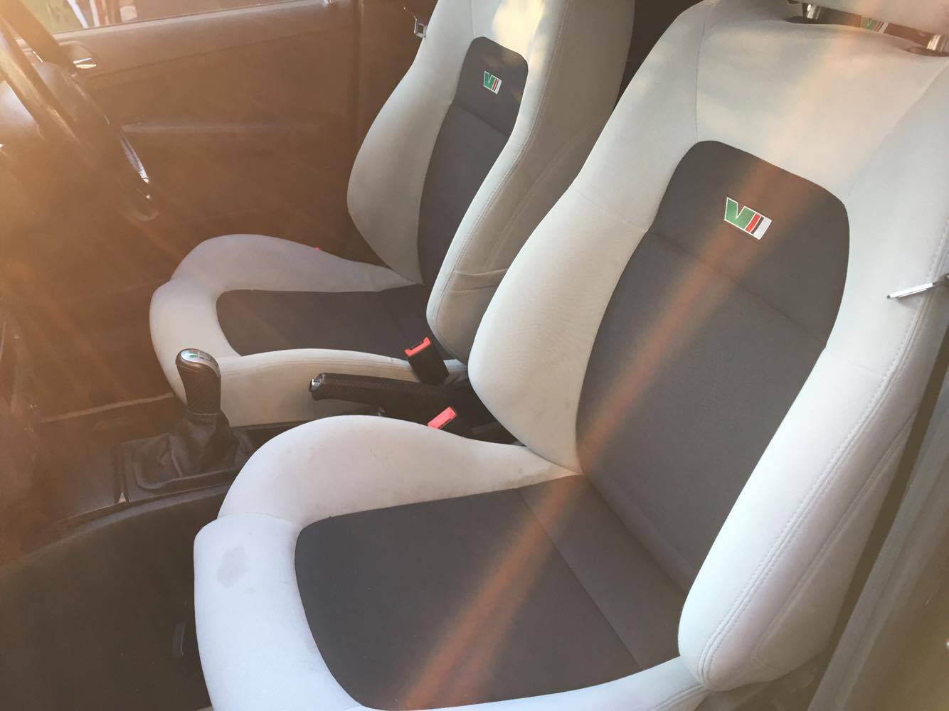

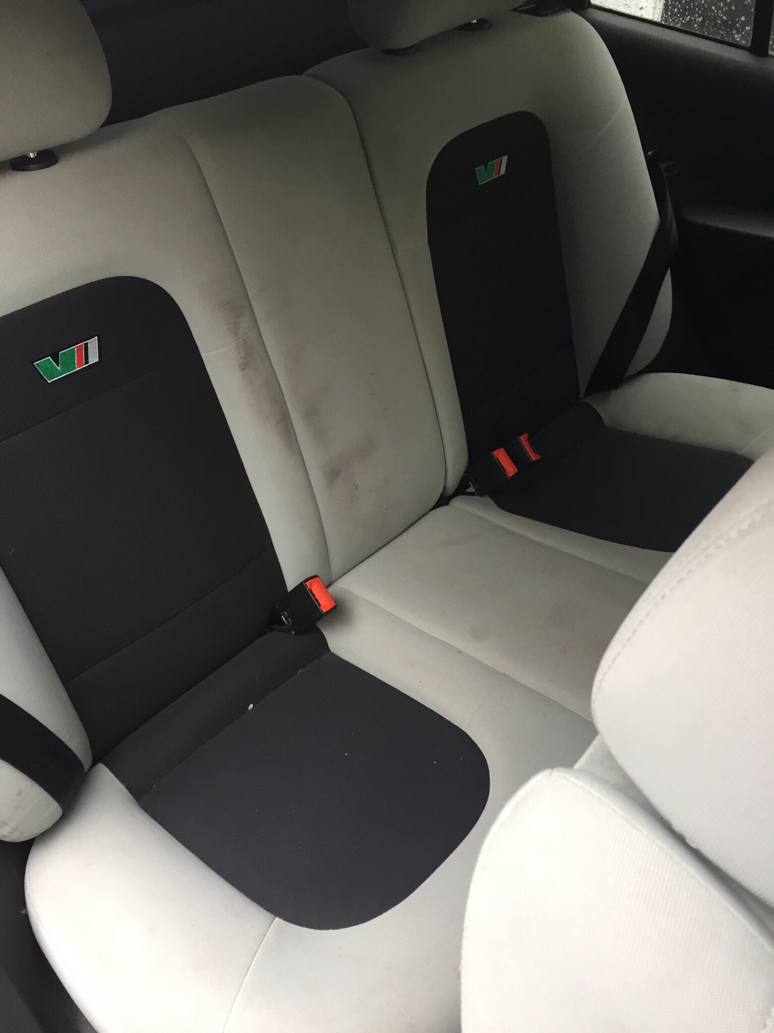

Also on the to do list clean up the rather stained original VRS seats, professional mop/polish of the terrible paintwork and restore the headlights with some sandpaper.

For the speedo lights, window switches etc have little bulbs behind them, so removal and change these back to the standard bulbs.
Check the for sale section for the standard wheels and sign up to Freedom Membership to sell whatever bits you don't, want like the Audi wheels.
If you're keeping her, I would invest in a Vax multipurpose cleaner for about £50 off Ebay as this will save you money in the long run. Very easy to take the seats out and do it properly.

Not the worst I've seen but will be giving the vax a go this weekend.

Back to standard height, dam these wheels and clocks are nasty!
New fronts and read pads, drop link, some vrs wheels and two new tyres.
Not conventional bulbs though. They are 3528 SMD (surface mount diodes). They have to be unsoldered from the cluster PCB and new ones soldered in. Not a job for the faint-hearted as they are tiny (I'm normally good at this sort of stuff but I buggered mine up when I tried to do it).
Pics showing the SMDs...
http://www.instructables.com/id/Skoda-Fabia-mk1-LED-dashboard-lighting-conversion/

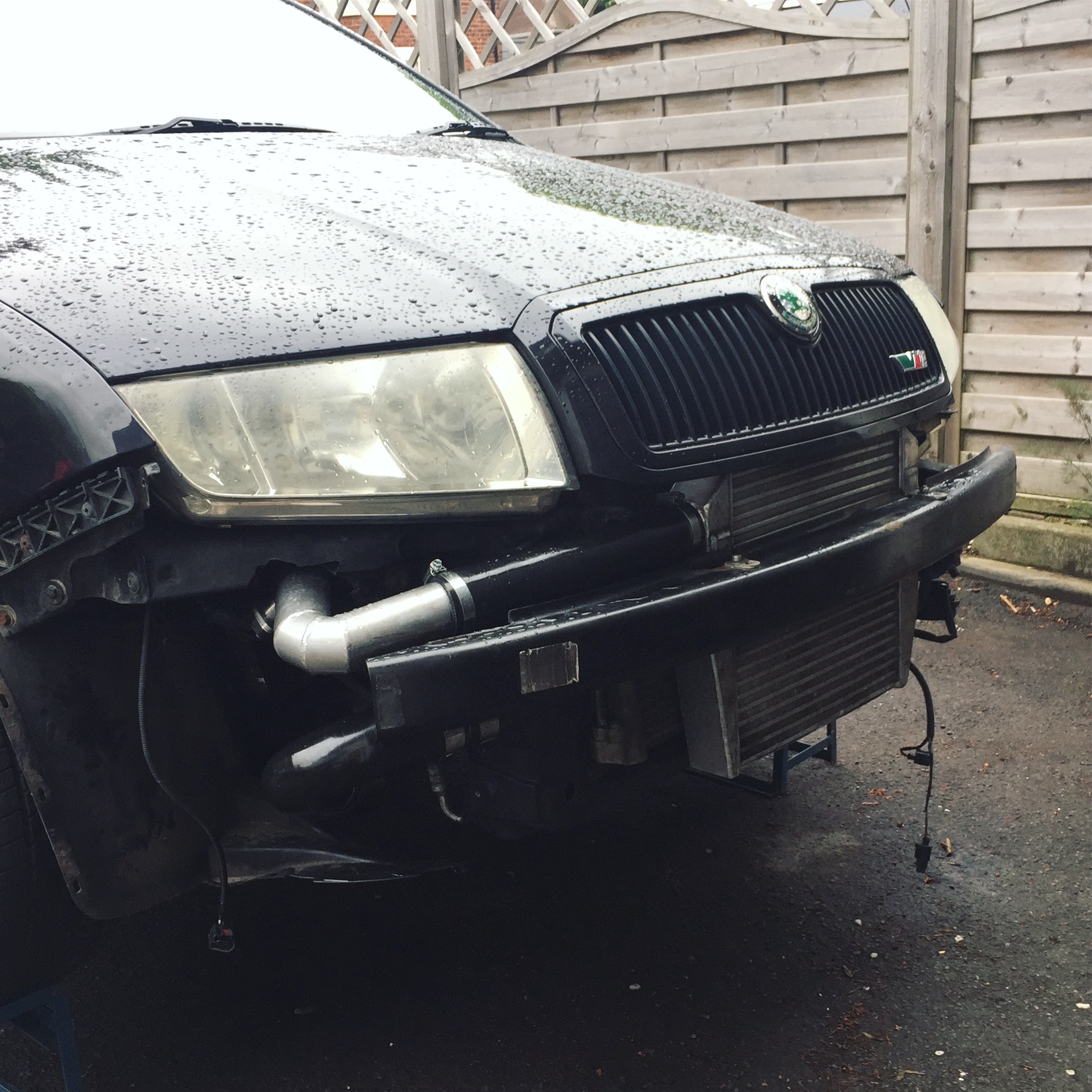

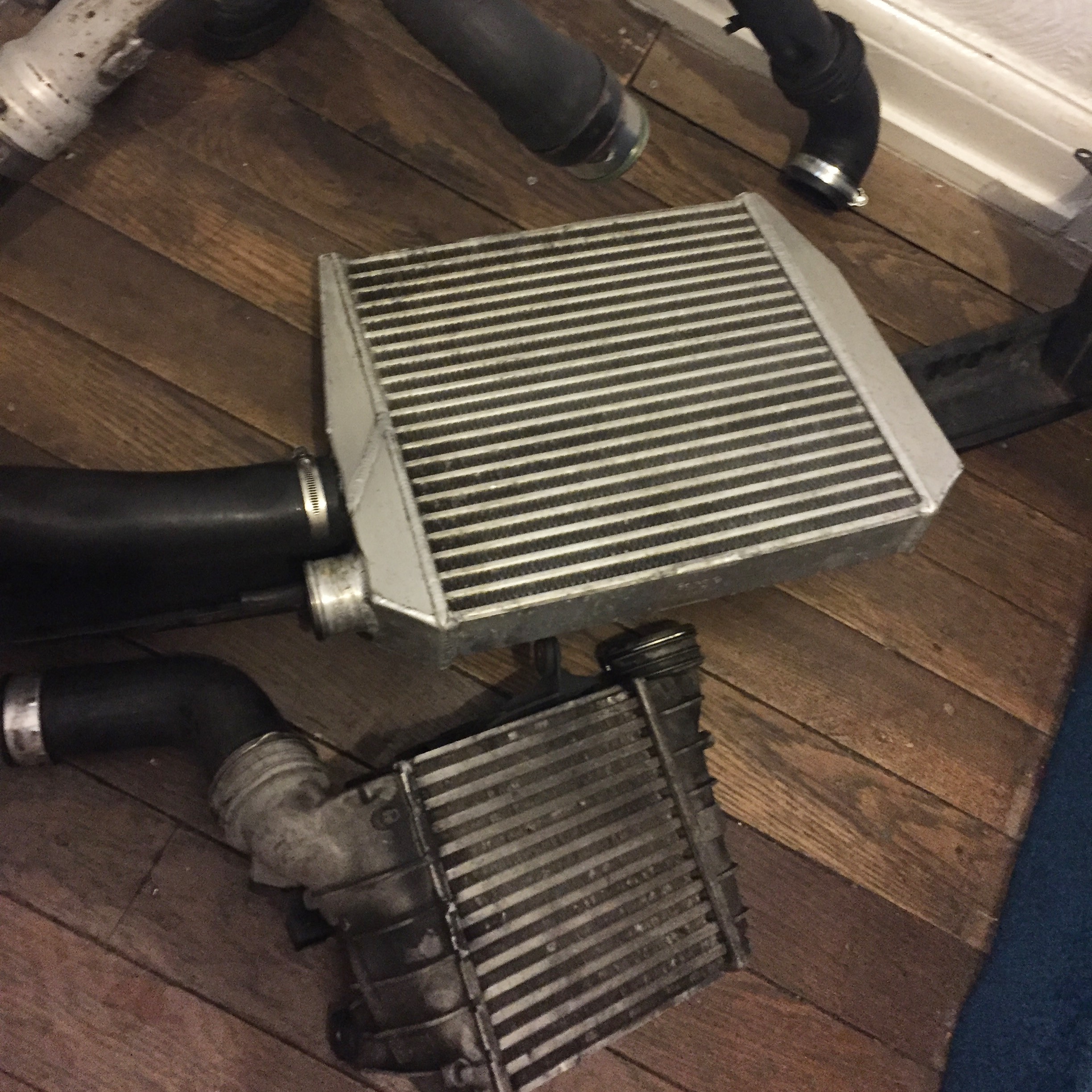

After 10 miles back on the road the lower intercooler pipe started popping off, good excuse to swap to this forge fmic ☺️

That was the plan, hey it needed upgrading! Not all smooth tho the water pump decided to start leaking today a few miles after leaving for work, thankfully not too bad the low level only came on as I pulled on my drive then filled it back up.
Booked in for a waterpump and cambelt next week. Also picked up a 14 Fabia 1.6tdi this week so this might be up for sale soon! Least the new owner will have a new belt, pump, pads, fmic and several other bits!

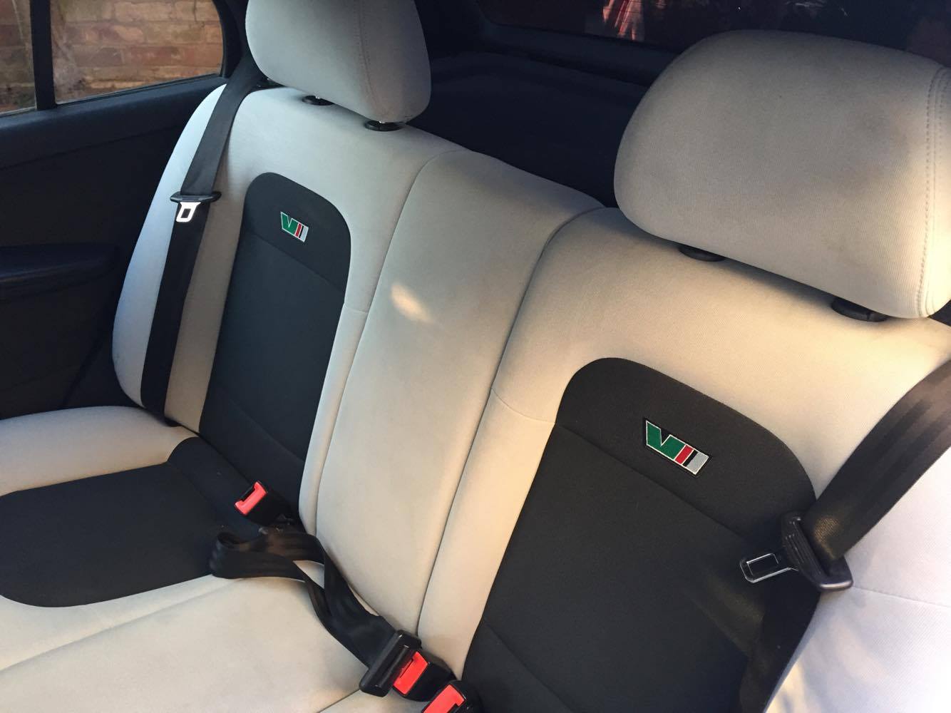

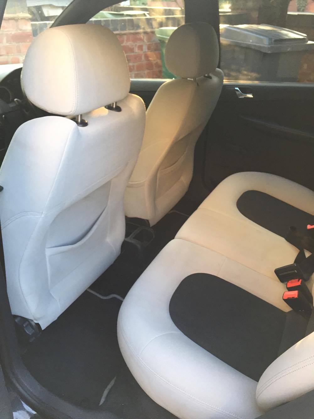

Should also mention the seats cleaned up decent
