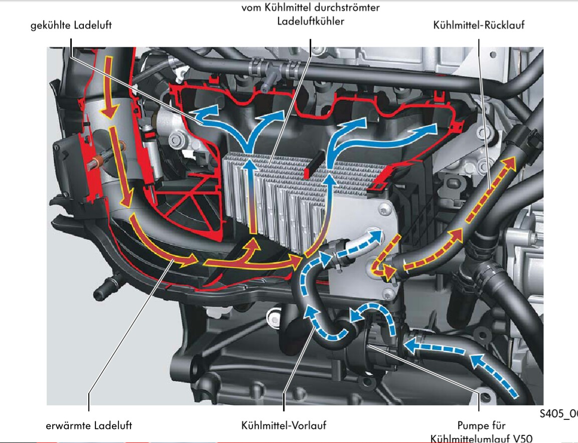

This one is. It is positioned on the aft side of the engine. The pipes you see going to/from the radiator is the separate coolant circuit for the intercooler. So it is the coolant which is cooled in the radiator, not the intake air.

The picture is showing me the air travel through a secondry intercooler built into the inlet manifold, the hot air is coming through the throttle butterfly, through the cooler and into the intake ports.

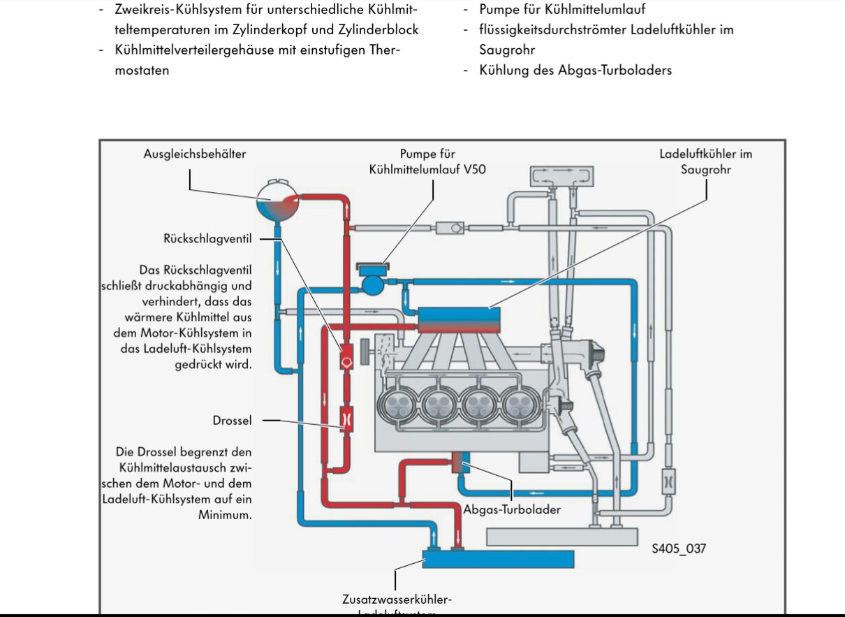

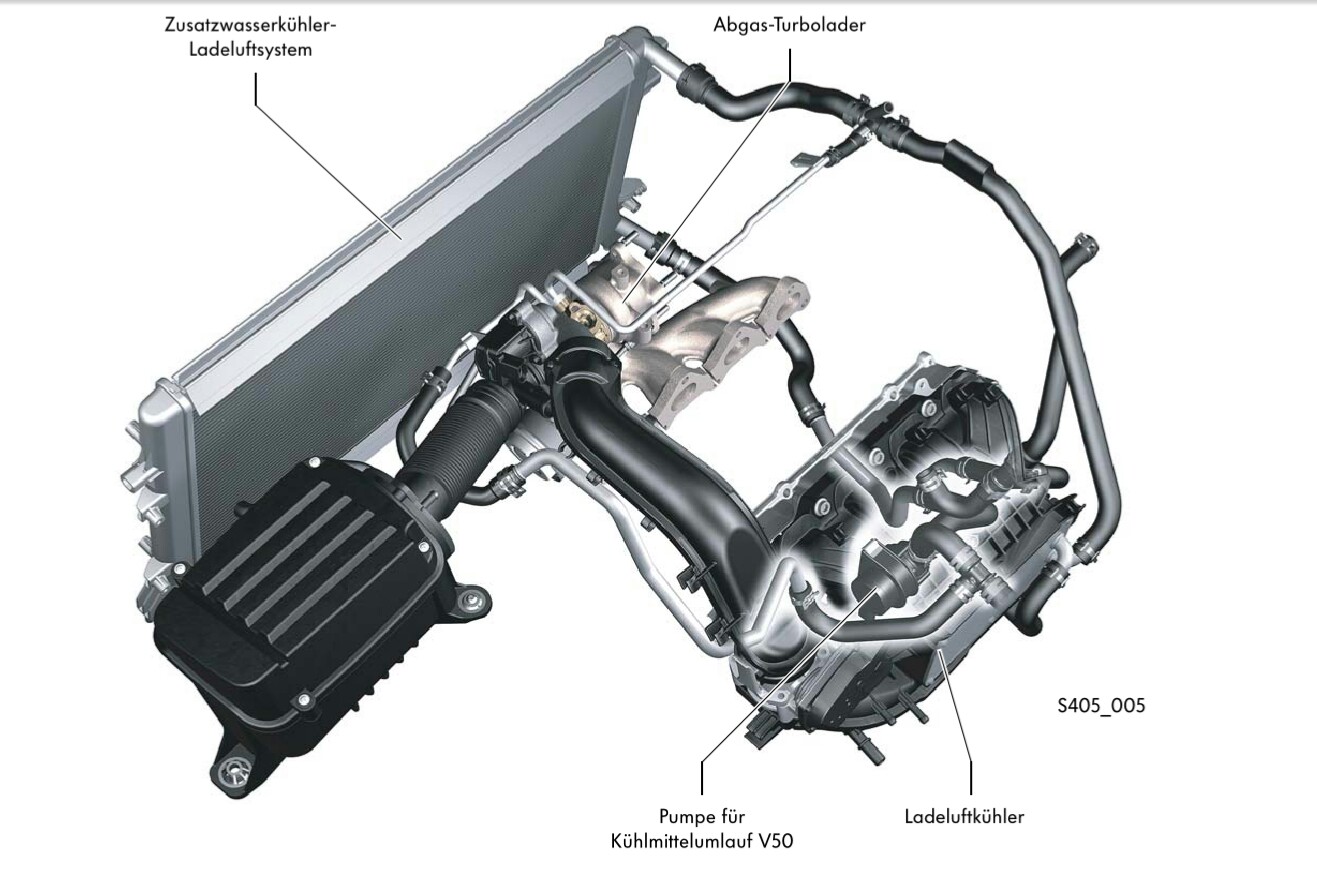

Well, my reference is VW Service Training program and it is quite clear that the intercooler of the 1.4 TSI 90 kW is cooled by the engine coolant (unfortunately this is in German). I cannot understand that Skoda will alter the engineering. And it will explain the OP's problem, as the head gasket has been proven to be ok.
