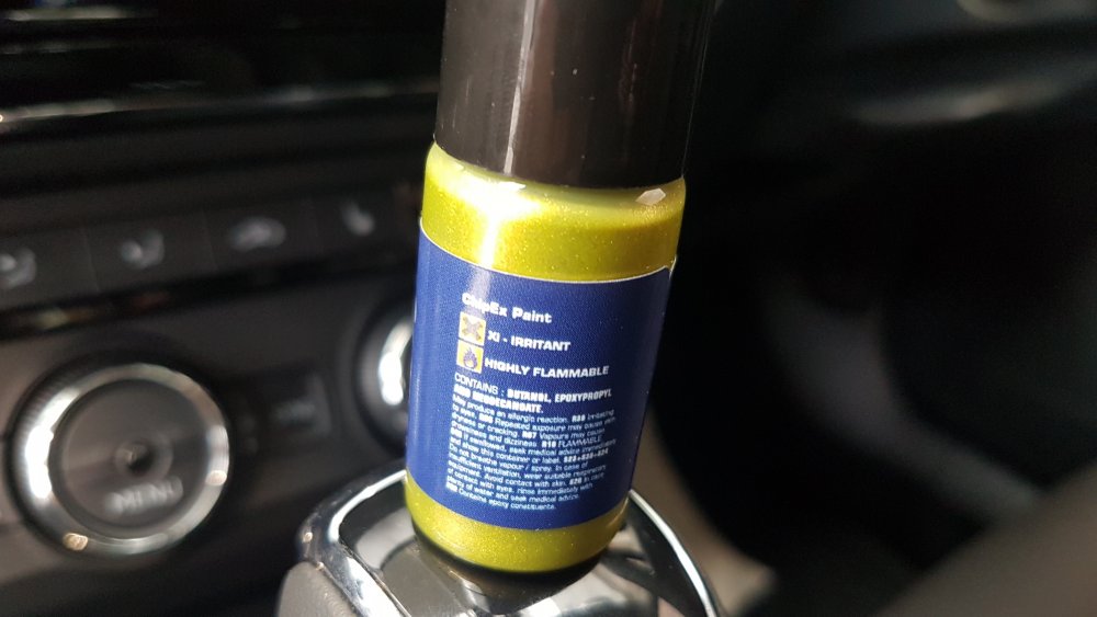

Not yet. ChipEx tell me they can do the colour but not yet ordered.
Confirmed! £32.94 inc delivery.

Once I've got it, I'll post some pictures..
T-up landed and... looks O.K.
 Just waiting for the weather to clear...
Yep ChipEx gets my vote, bought loads in a variety of colours for various brands and all have been a very good colour match.
It's also handy that the clearcoat is part of the colour pot which saves faffing about a few hours later with clearcoat as you would do with a manufacturer supplied kit.

Hi. Can you tell me what product that exacly is and how it looks when you aply it to the car. Many thanks. I need one too..
