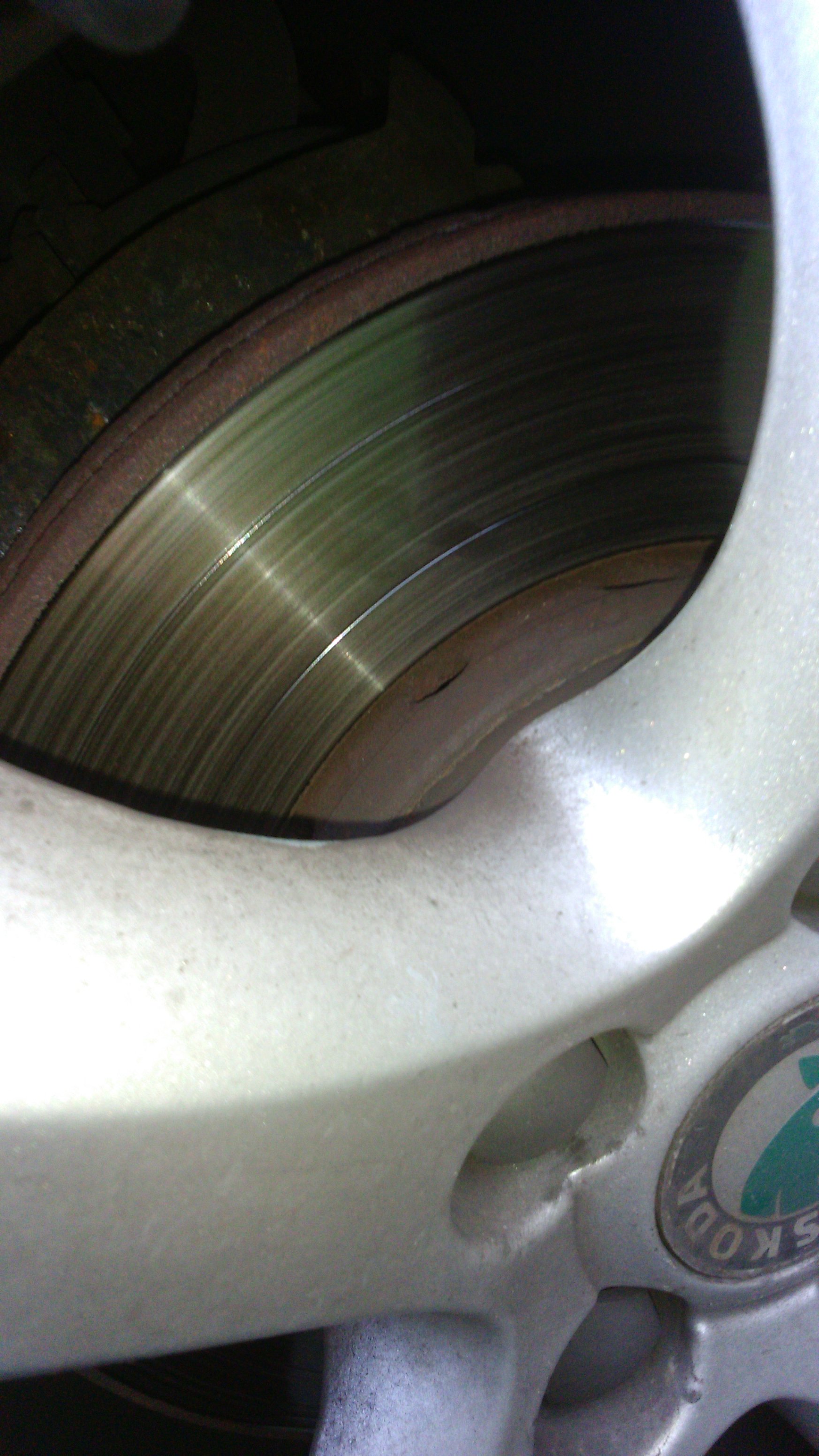

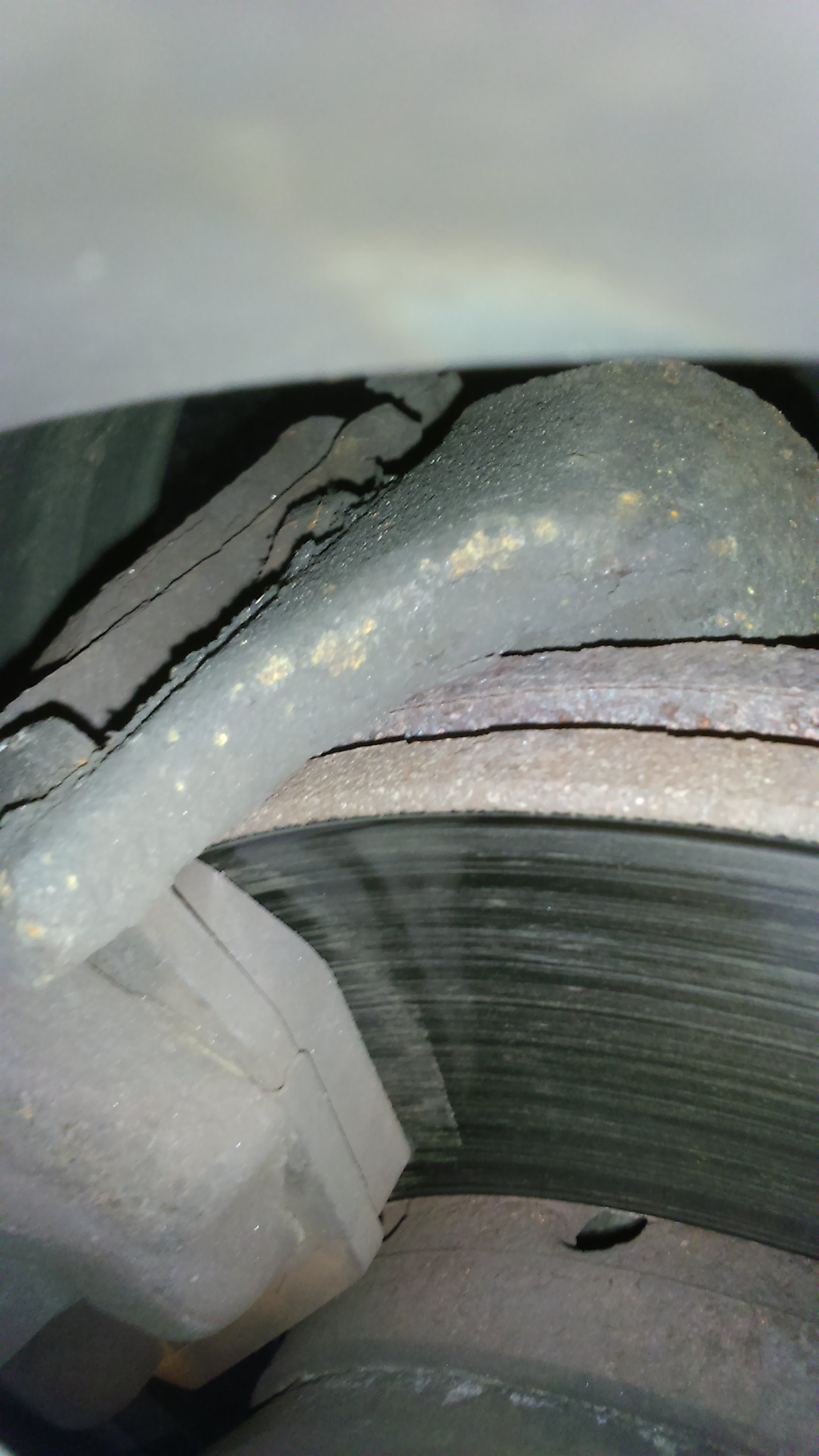

brake discs looked scored quite abit but pads dnt look to bad. I do avoid harsh braking but when ya live in bradford its not that easy most peeps around are nuts. Had my other car 3 weeks before i got tboned. Frist pic is driver side 2nd is passenger with pads showing.

Yeah, I'd bin them. Think a bit before replacing the pads. They might be fine but they might re-score the new discs. I think I'd fit new, keep them ones and re-fit next time round so the pads and discs wear a bit more consistently. Either that or just bin the pads too but thats a little wasteful. Don't forget to copper grease the sliding caliber pins and the back of the pads. Re-fit any anti-squeal shims if necessary making sure not to grease the fronts of the pads or the discs.  There is a tool you can get for helping undo the calliper bolts as its quite fiddly getting a tool to fit otherwise. Its a bit like an allen key, with a plastic grippy handle.
Thank u mrgf. I have 2 kids in car. 1 is a baby so on that note i will just change both pads n discs. I rather know that everything is at its best. Especially given how many nutters i have to deal with every day lol. Now i jus need to decide whats going on. I have looked on ebay and found some delph, brembo, bosch. But it says on some no wear sensor which concerns.
Replace both pads and discs as a set, never ever re use old brake pads with new discs as it causes more problems. Pads and discs can be got at fairly cheap prices for brand names.

I agree with the changing together but pads are ok if inspected but they will run different grooves and need bedding in etc. I only suggested re-use as a later resort. Most people will either stick them straight back on new discs, causing them to wear quicker too or bin them as they are too low a value to store. Really last resort to re-using but people do and if they are fairly new, CAN be re-used. (I wouldn't, what does that tell you)?
