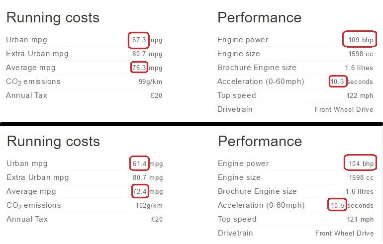

Would anybody know where can I find list of all engines for Octavia Mk3? I`m looking on Autotrader and two identical cars seem to have different engine specs. Both are 15 plate, both 1.6 TDI CR SE DSG 5dr.

Hello, the 1.6TDI did have a modest increase from around mid 2015 from 105 to 110ps. I have a 110ps and providing I don't thrash it, it easily returns 60+ mpg. If I was you, I'd definitely go for the bigger power. Not sure why there was a power increase as the torque figures are the same. Might be something to do with Euro6?
Both are first registered as 15 plates, when where they built though.
Must have changed the specs midway through that period?

V5 says 77kw, but Autotrader by number plate says its 109 bhp model (should be 81kw then on V5 ?). I have VIN number, anybody can check out? Built May 2015.

On 110 version torque kicks in a bit earlier, gives feeling of a bit more jumpy engine/car at lower gears. I have 110 and my friend has 105 and he's the one noticing it. 1.6 105bhp driving experience is more like old 1.9 105 bhp TDI's ...
Is the 15 plate with 110 bhp an greenline? I think 110 version was in general (for all models) released with MY2016, but for greenlines earlier.
