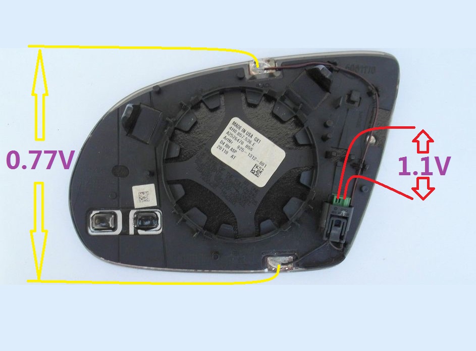

I've simulated the working condition by parked the car in a garage and turned on the interior reading light, then checked the voltage of both the door mirror. The driver side mirror was fine, with a voltage of about 1.1V when working, but the passenger side mirror has a 30% loss, with about 0.77V. But if I unplug the mirror and test the plug directly, it has 1.1V, which means the wiring was correct and there's something wrong with the mirror.
The photo demonstrates the voltage I tested. The mirror in the photo is not the same part on Octavia MkII FL but has the same mechanism. The plug I tested (as red line indicates in the photo) was from the car's wiring, not the one on the mirror.
