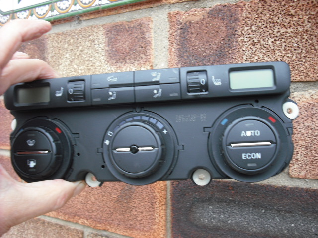

Had the car fixed by the excellent independent German Car Specialists of Doncaster 01302 890434. It was a fault in the A/C unit.
£38 for a 2nd hand unit off ebay.
