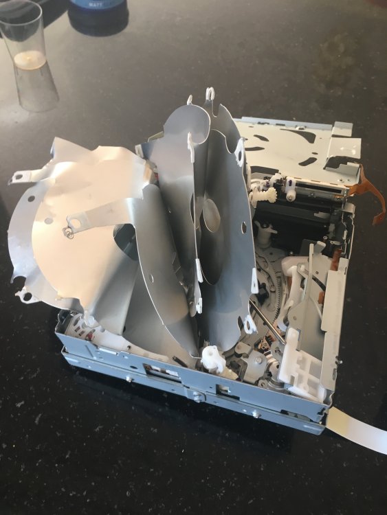

Yeh I tried the electrical reset to no joy. So went down the surgical route and saved the CDs. As you can see the CD changer is no longer viable! Fortunately the SD card still works.
