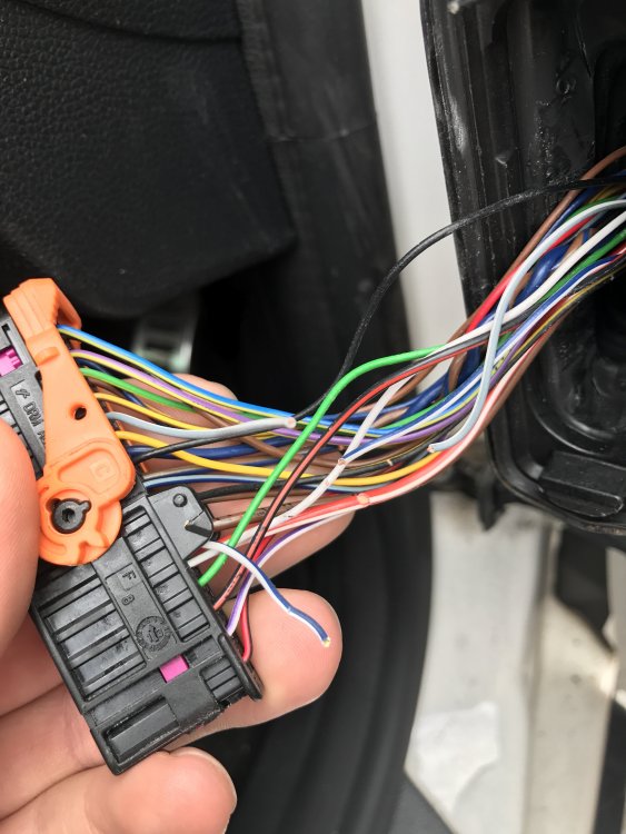

I believe there is some sort of convenience module etc inside the door. Have a look at the wires in the door bellow first though as they often sever!

Yeah have a look in the door shut for broken wires. Mine worked then I realised that it didn't go down when the door was open.
The wire was already broken but touching when the door was shut.

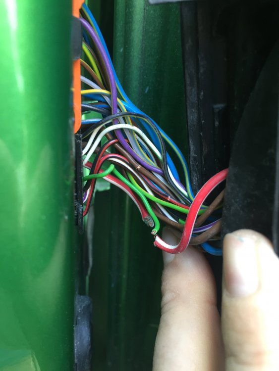

Problem found!
Two severed wires and another four that are well on their way!
Time to get the wire and soldering iron out.
I know the red and white is to the window motor....
All sorted now and works Just as it did.
