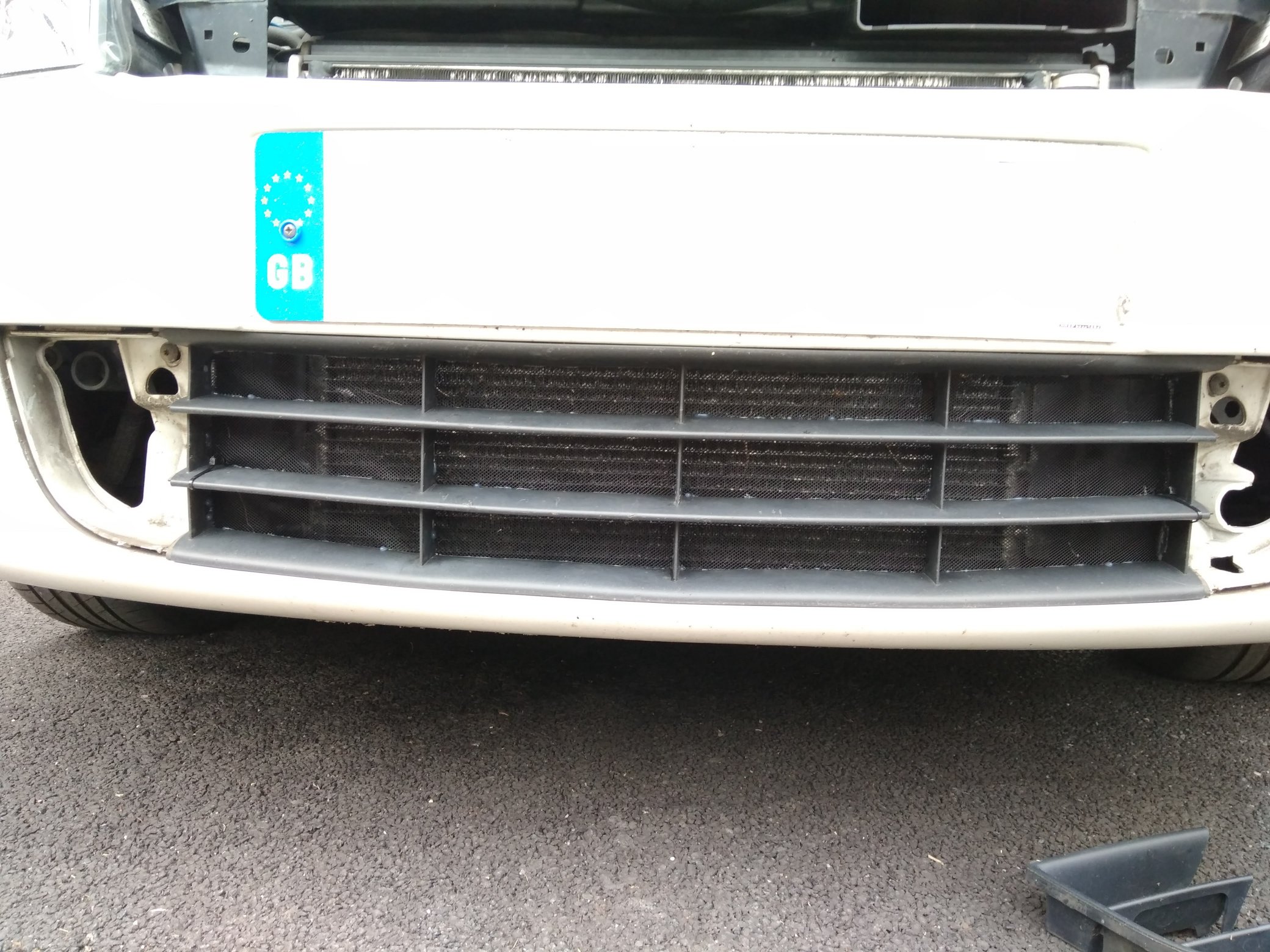

I've just bought a 2012 Octavia estate, very happy with it apart from a couple of things, the first being aircon not working. The dealer I bought it off says he's going to fix it, he's going as far as to get a new compressor, but from what I read it is much more likely to be the clutch on the front of the compressor or the condenser. I should just say "hey, his problem, it's under warranty" but it's a sixty mile trip to visit him, so I'd rather get the problem identified right and solved in one trip! The condenser has quite a bit of a superficial damage, including a bit of corrosion but doesn't obviously have holes! I'd like to upload a pic but can't quite work out how yet! What do you guys think? What's most likely to be wrong do you think?

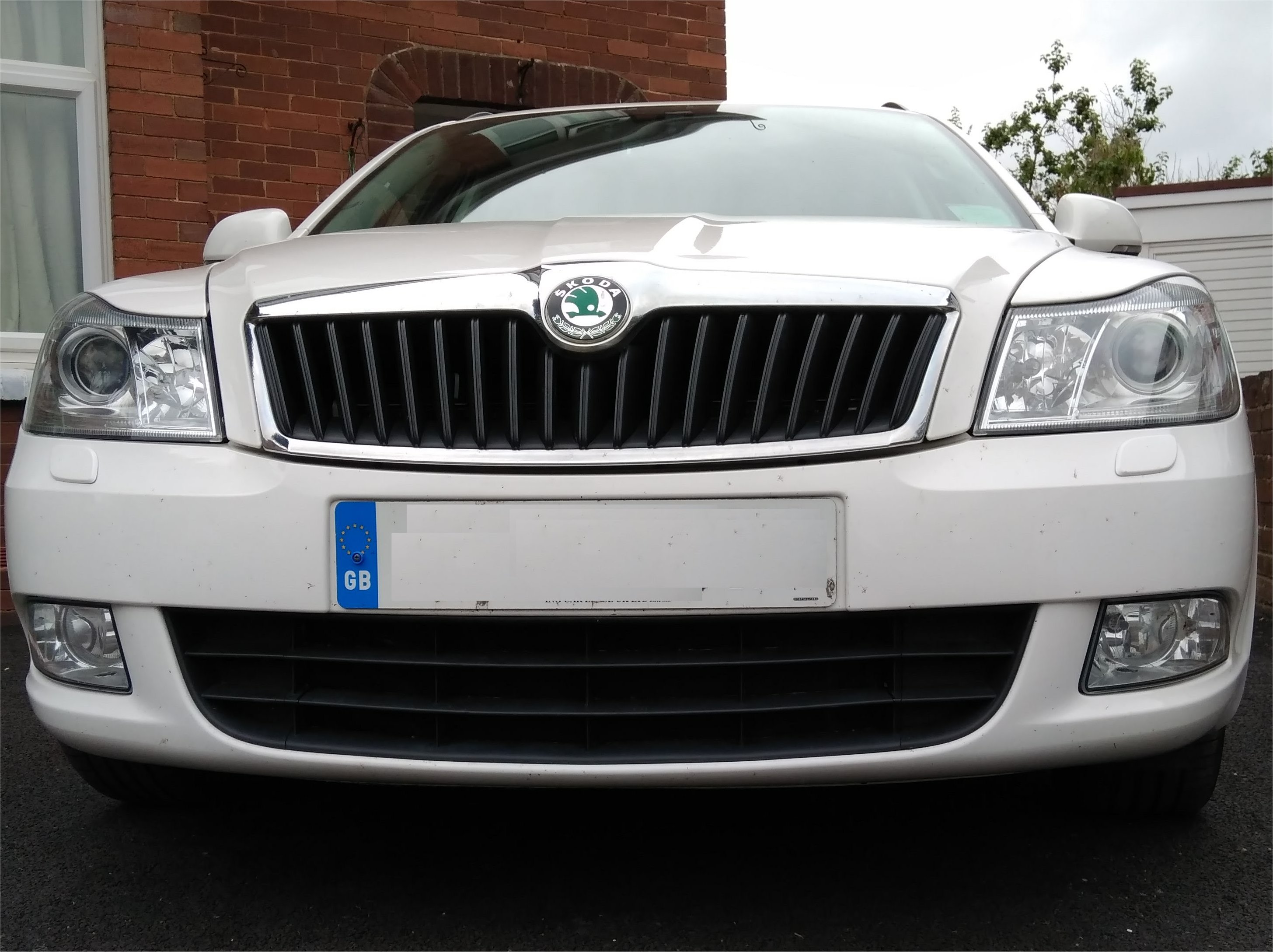

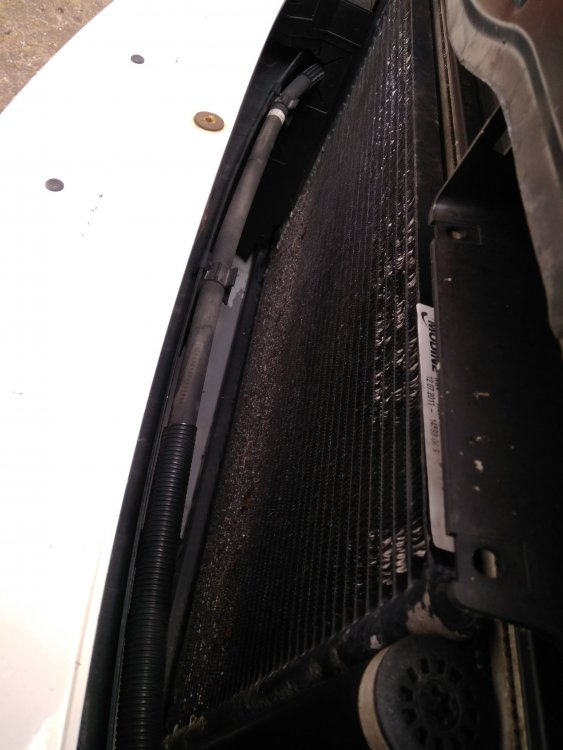

BTW, I think I've worked out how to upload photos now - please see the attached photo of the condenser with the bits of damage to it - do you think it looks bad?
Thanks again!
Cheers
Neil
That's just the fins on the condenser to aid cooling. As long as it hasn't got a hole in the core it'll be ok. The condenser on my son's Octavia is a lot worse than yours and his A/C is freezing!! Still worth cable tying some mesh to the lower bumper grill though.

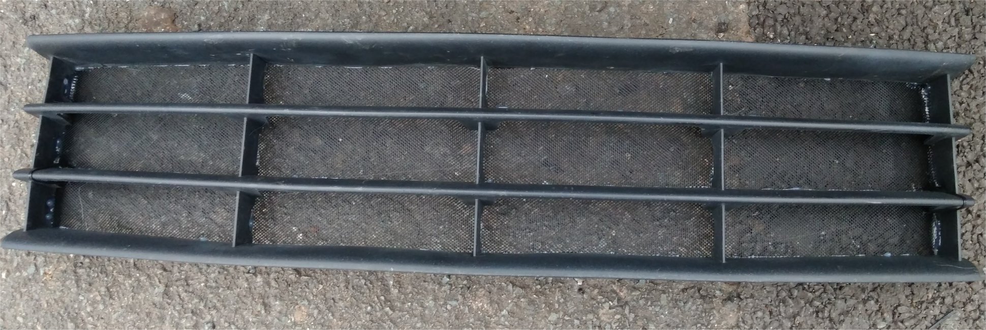

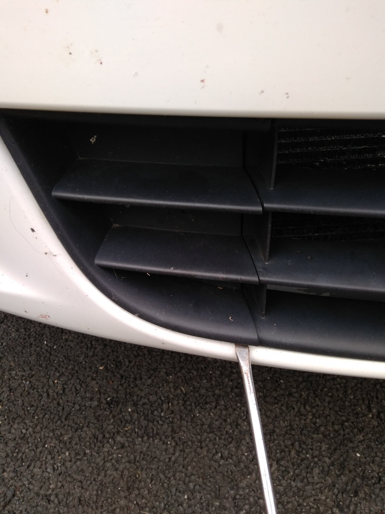

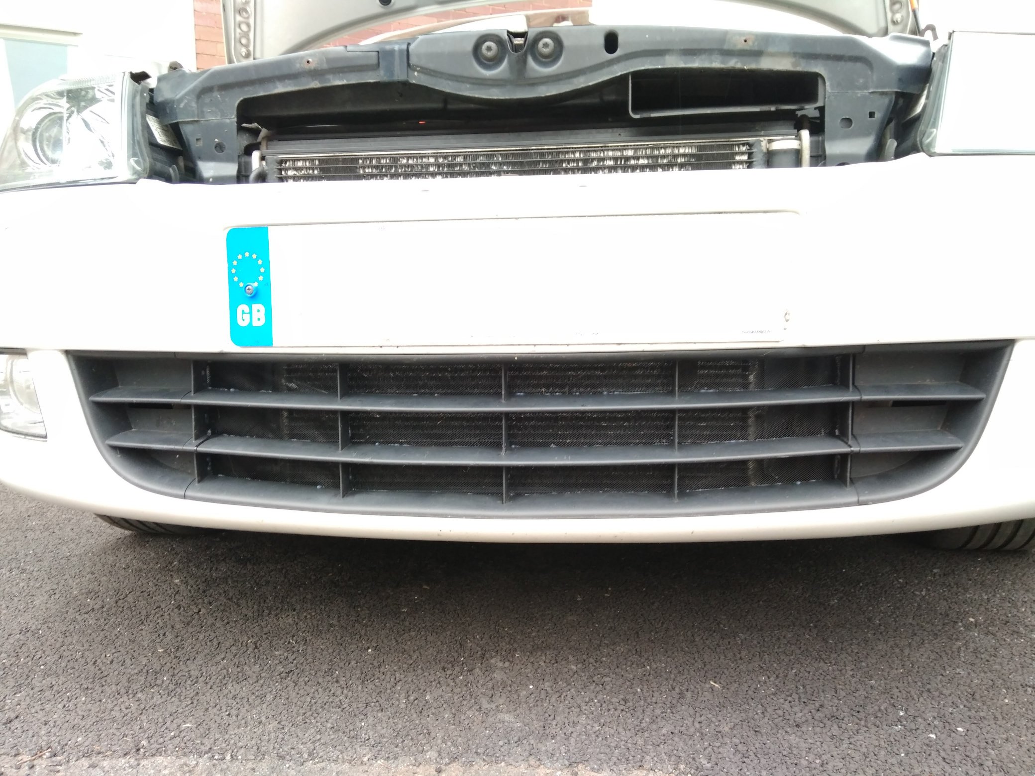

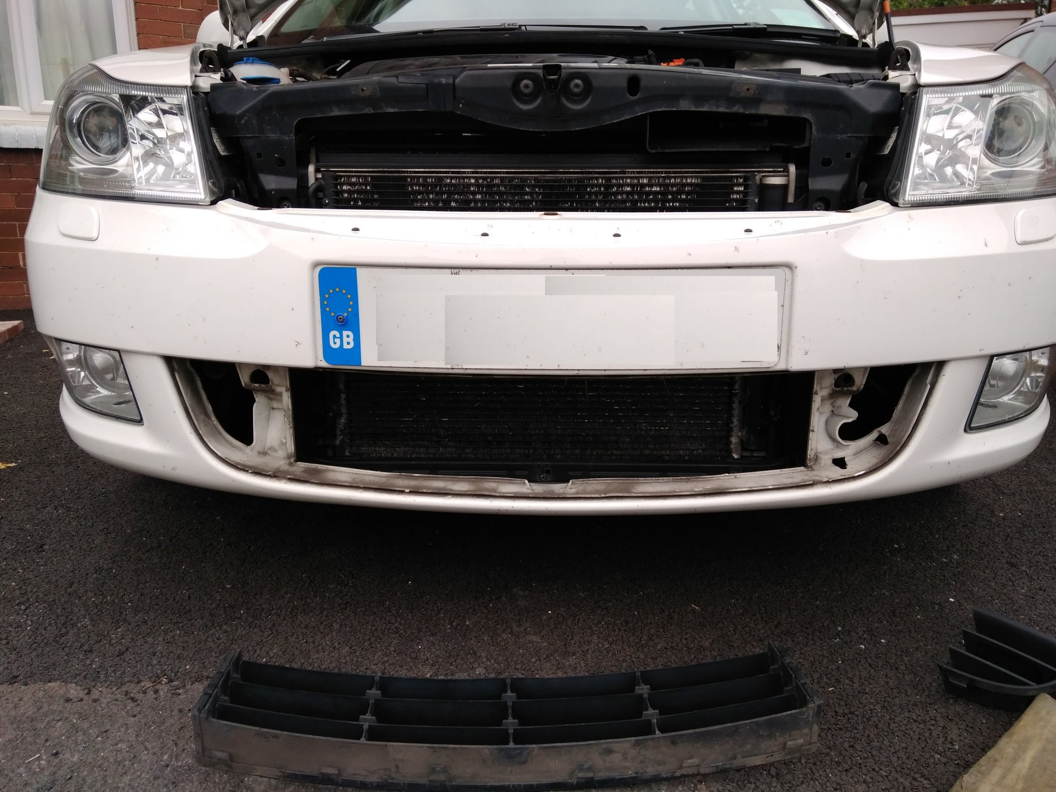

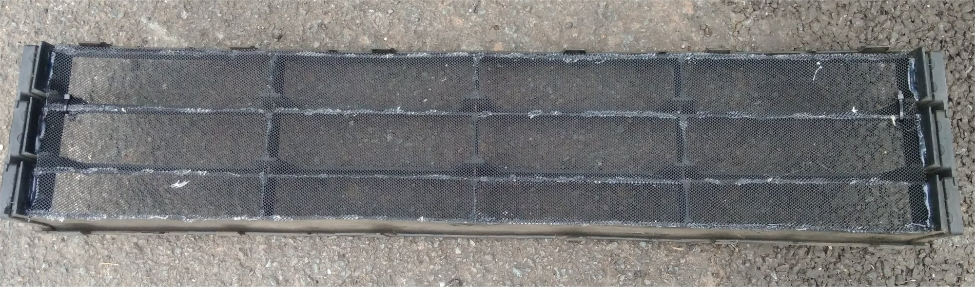

Following the recommendation from pikpilot and meaty101 I have purchase and fitted the mesh to my front grill. I don't know if it'll help anyone, but I took some photos and this is basically what I did:
First, I prised out the side bit of the grill as it looked like they went in last and would hold the middle section in.  I took out both sides.
Next I took out the middle grill section using the same technique, plus a bit of prising along the top of it. It came out pretty easily.

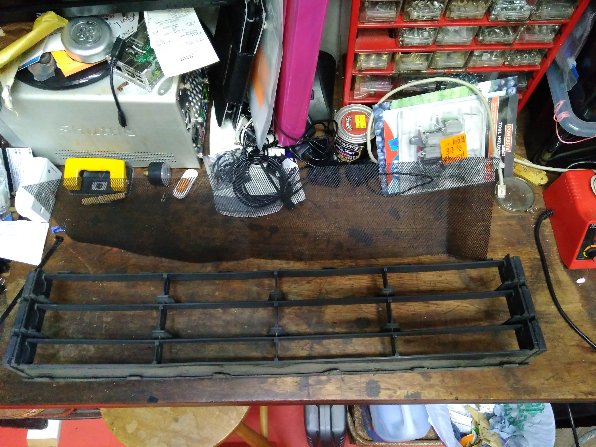

I took it into the workshop, gave the back side a wipe down along the spars and offered up my mesh (from the eBay supplier above in this thread).  (Please excuse the mess in my workshop!)

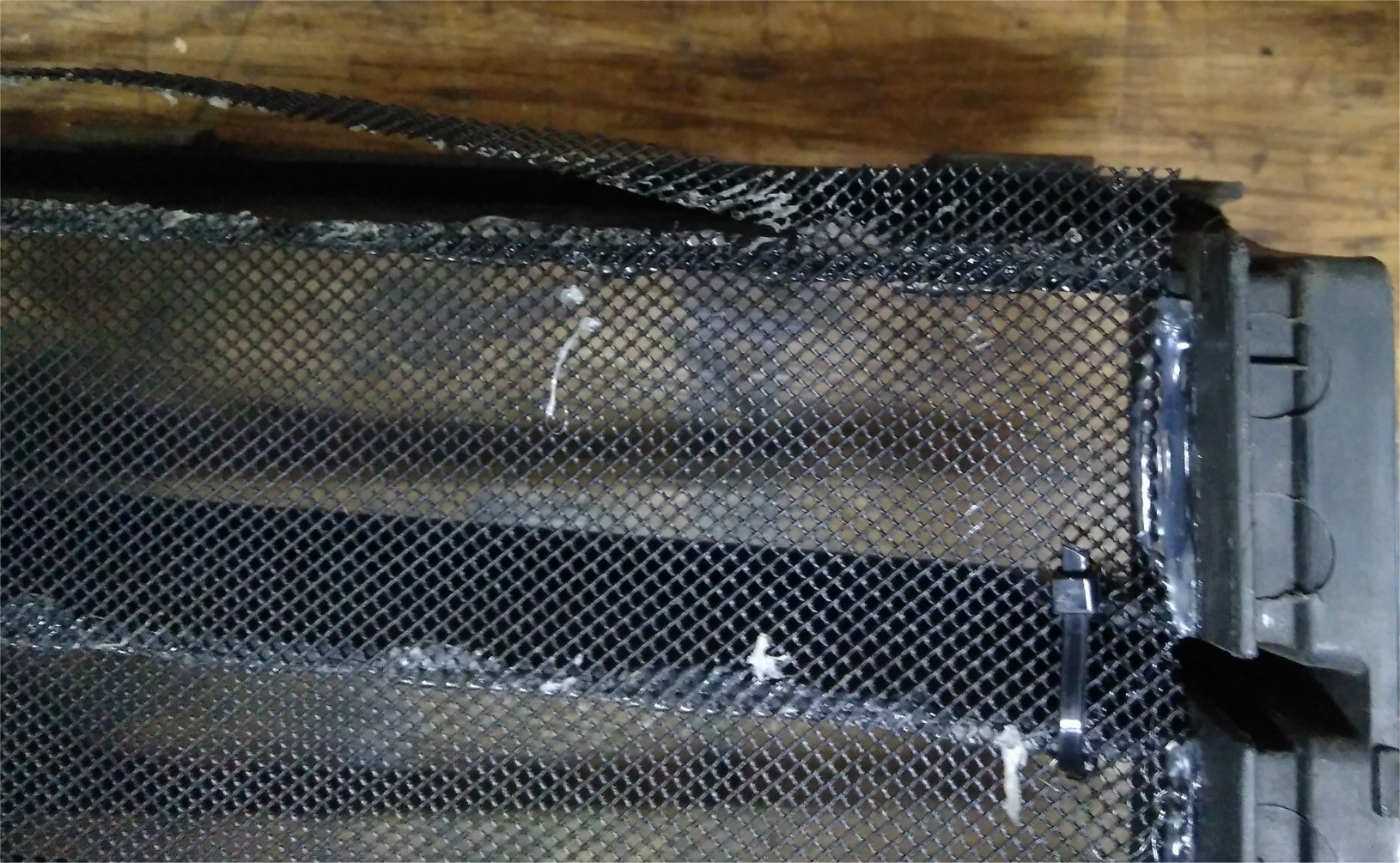

With a hot glue gun I laid a bead of glue along the four spars on the left hand quarter and the vertical bar at the edge and 1 in.  I then laid the mesh into this and pushed it down before continuing to do the same on the second quarter and so on.  I punched a little hole through the mesh on the second from bottom spar and put a cable tie through.  I did this at both ends (belt and braces really, the glue will hold not least because it squishes through the mesh and gives a good mechanical interlock). I put a bit more glue at either end having trimmed up the overhanging length of the mesh.  Finally I trimmed up the overhanging mesh top and bottom with a knife:
The finished result was pretty tidy: (Back side)
(Front side)
I popped it back into the front of the car and added the side bits.  They needed a gentle thump as to get the little clips in, but it wasn't hard.

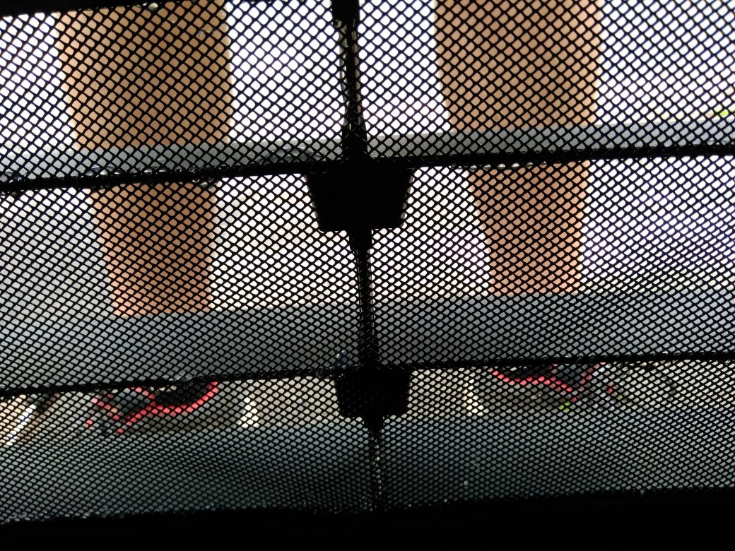

The mesh looks good from the outside, it'll stop stuff flying in easily and I don't think it's going to reduce the airflow much.  (View looking out)
View looking in:
Tidy job! :)
Thanks again for the the advice to do this.  It took all of half an hour and I reckon it'll save me getting the condenser replaced for a while.  It's a big gap without the mesh!

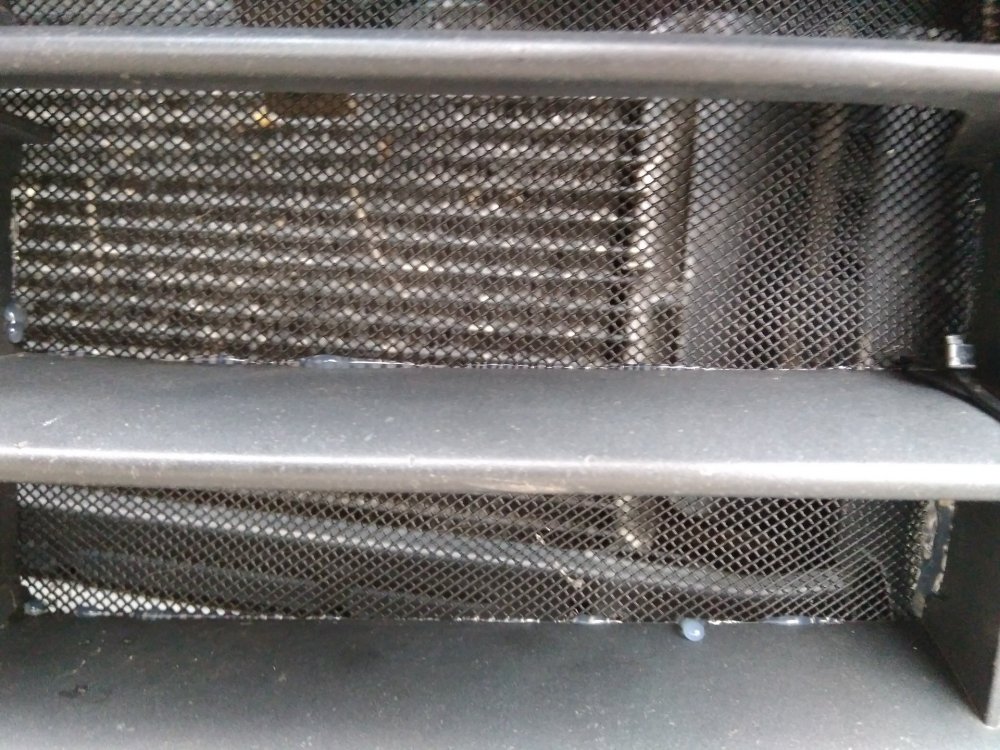

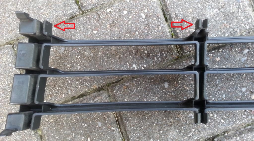

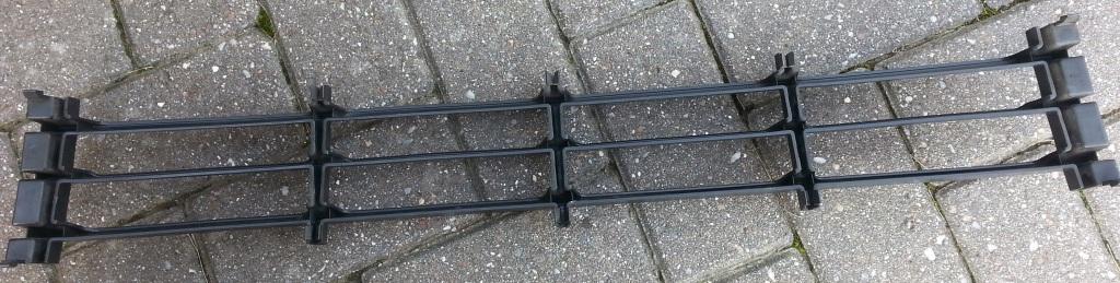

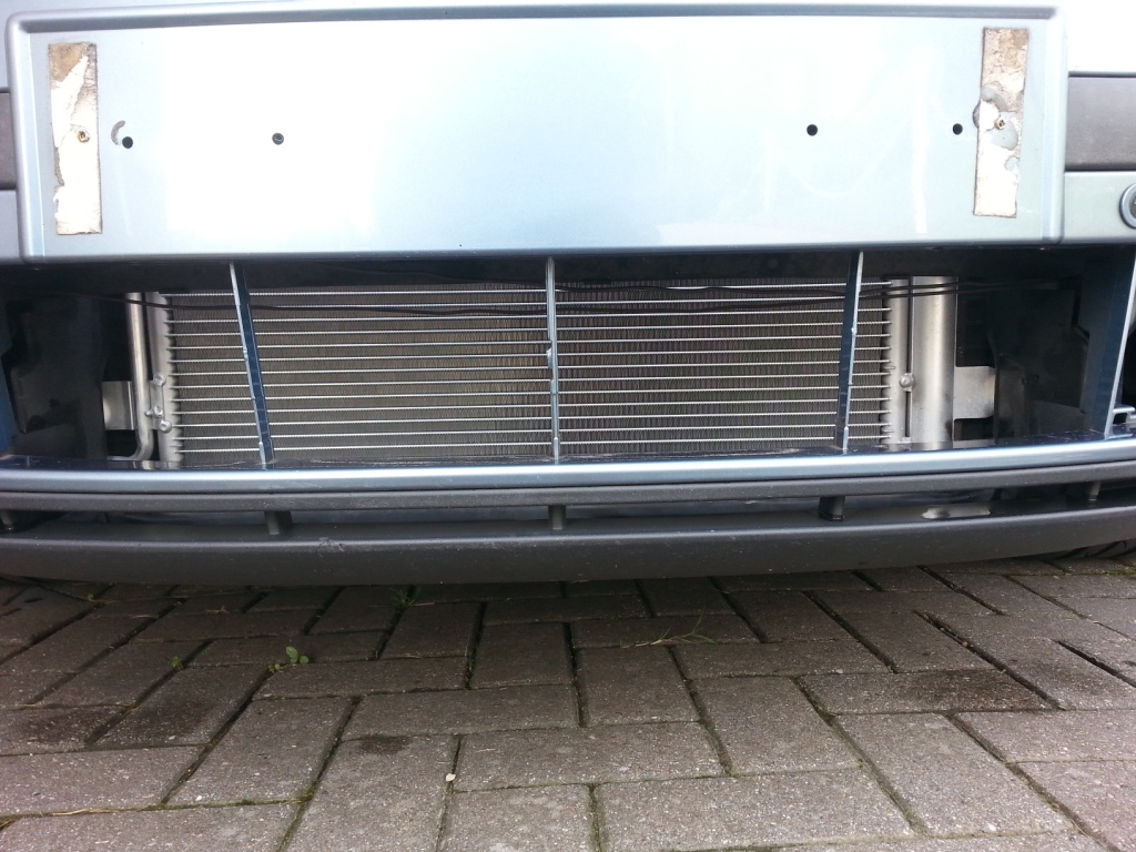

Hi NeilInExeter. Great pics and info for fitting mesh to front grill. I've been having aircon problems over the last two years. Won't go into full details of what, where, how, but pressure testing and nitrogen test couldn't find anything. Finally narrowed down to condenser which was replaced 4 Sep 2017 at a cost of £611 (ouch).

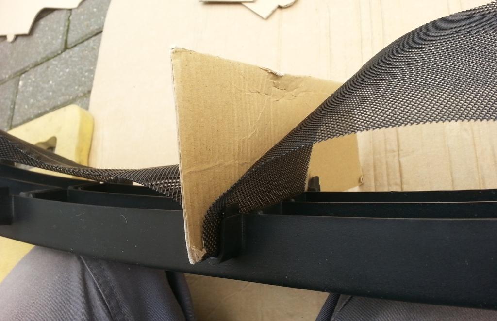

I removed my front grill and found that my panel is slightly different from yours (mine - 2008 L&K 2.0 TDI PD Octavia Estate) so for others I attach pics of my version. My grill opening has 5 suporting uprights (4 shown in Pic) that the grill clips onto.
This threw up the problem that the mesh couldn't just be fitted over the grill panel but had to be pressed into the recesses of the supports.
Solution: cut the mesh about 4-5 cm longer than the grill and using a piece of stiff card press the middle of the mesh into the central support. Flatten out the mesh along the grill and using more stiff card push the mesh into each support until all done. Important point: keep the mesh at the same height as the grill in order to retain the coverage when re-fitted. At each end just fold the mesh into the gap, but along the other uprights you will need to cut out a space (top & bottom) for the "press clips" to enable them to "clip" into their recesses when re-fitted. I did the same as you with a hot glue gun and mine seems to have held without the additional cable ties.
59b5758a15185_Pic03.thumb.jpg.569fc3c0018453f2b6a8e14d3beb9e58.jpg    59b57b440ead0_Pic04.thumb.jpg.09d1b4c4eacf82b28cc632e953739e79.jpg

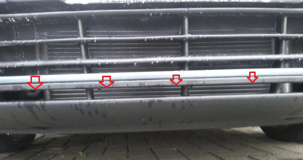

The only problem I have is that, once the grill is re-fitted, there is an additional gap below the grill with no mesh, it being part of the bodywork. Having said that, the car managed with the full gaps for 7 years without any problems so I'm hoping the much reduced gap will be a benefit. Car now on 121,600 miles and still on original front disc pads - really pleased.
