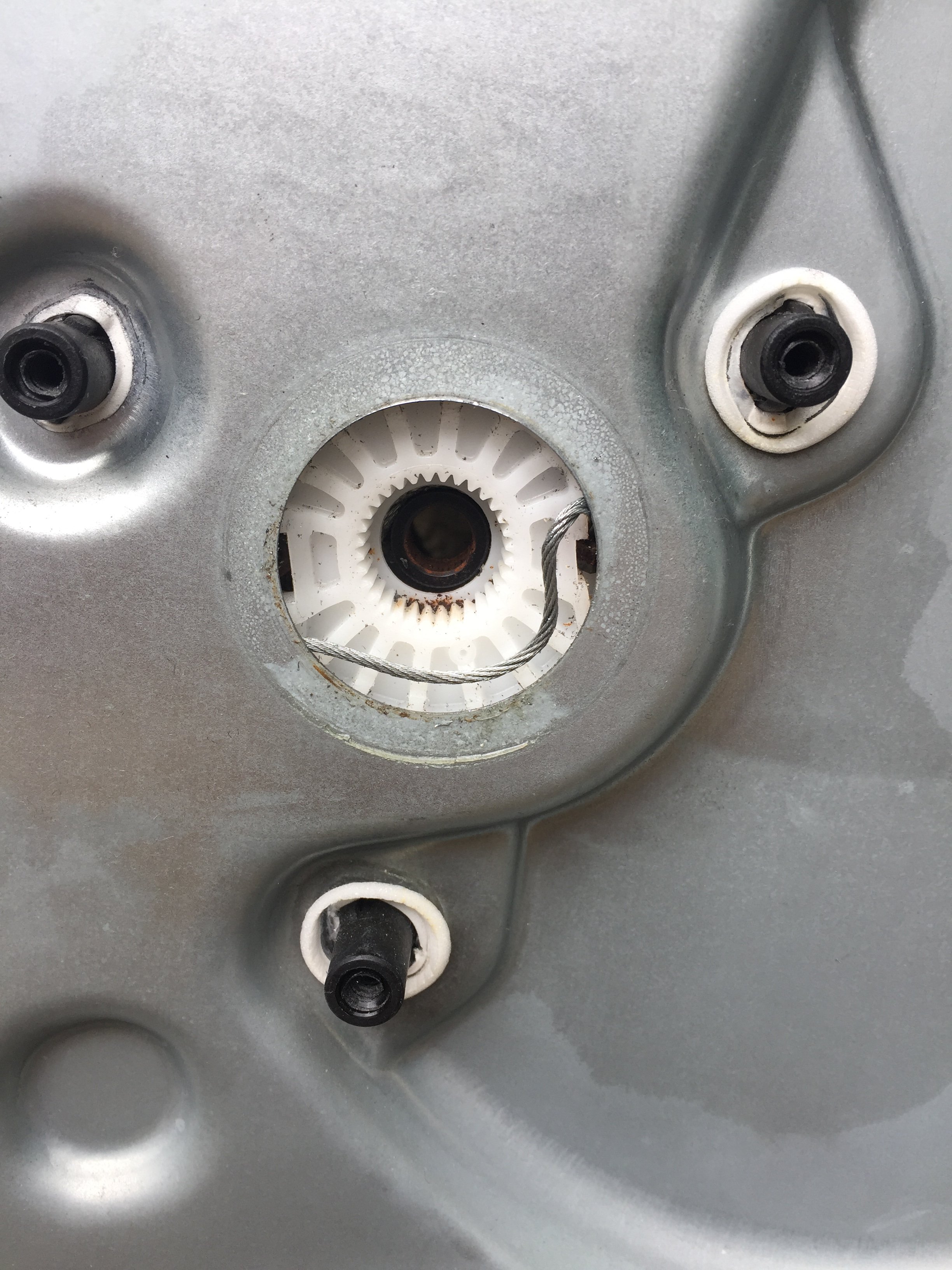

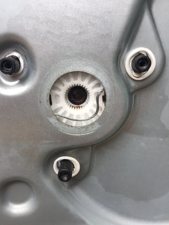

All done :biggrin: thanks for all the help.
Re-fitting the door carrier over the lock rod was a bit awkward to say the least!! Root cause was quite obvious once i'd removed the window motor :o

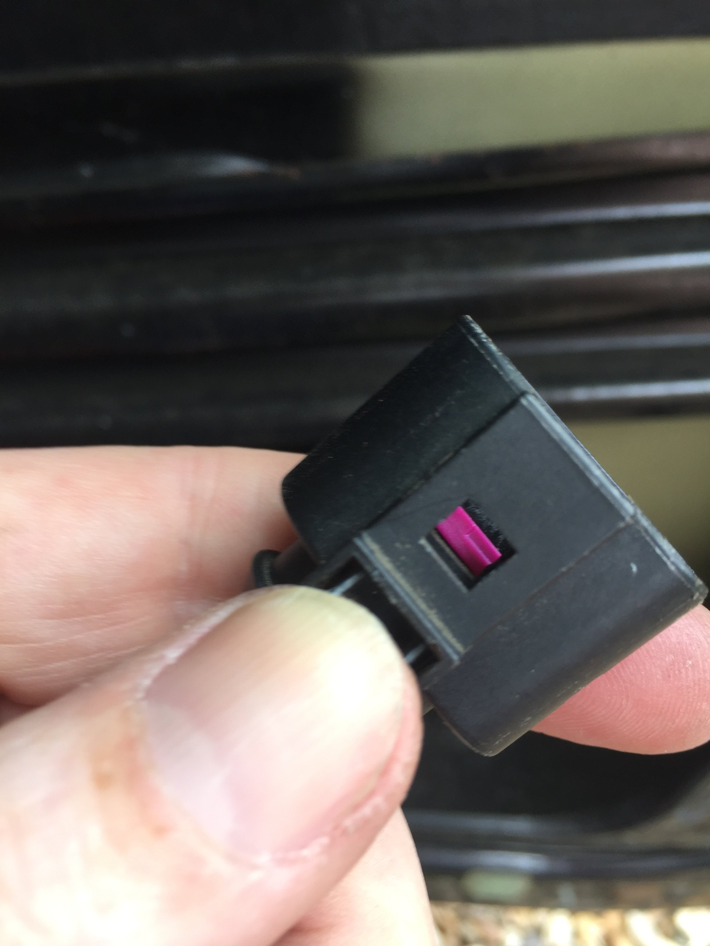

Read a few posts where people had difficulty removing the plug from the door lock. However if you push the clip down fully it will pop-off the connector :-
