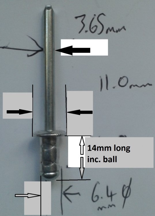

Looks ok to me, the key thing is that it can take the thick shaft of the rivet, which according to my piccy here is 3.65mm - chunky!

How many 6.4mm 'carrier to door' rivets (p/n N91078801) do i need to order? I'll get a few more just in case.
  • Sponsor
10 I think mate.  First piccy in this thread shows ten bolts, as far as I can judge.
Cool, thanks chap. I'll order a couple more just in case.
