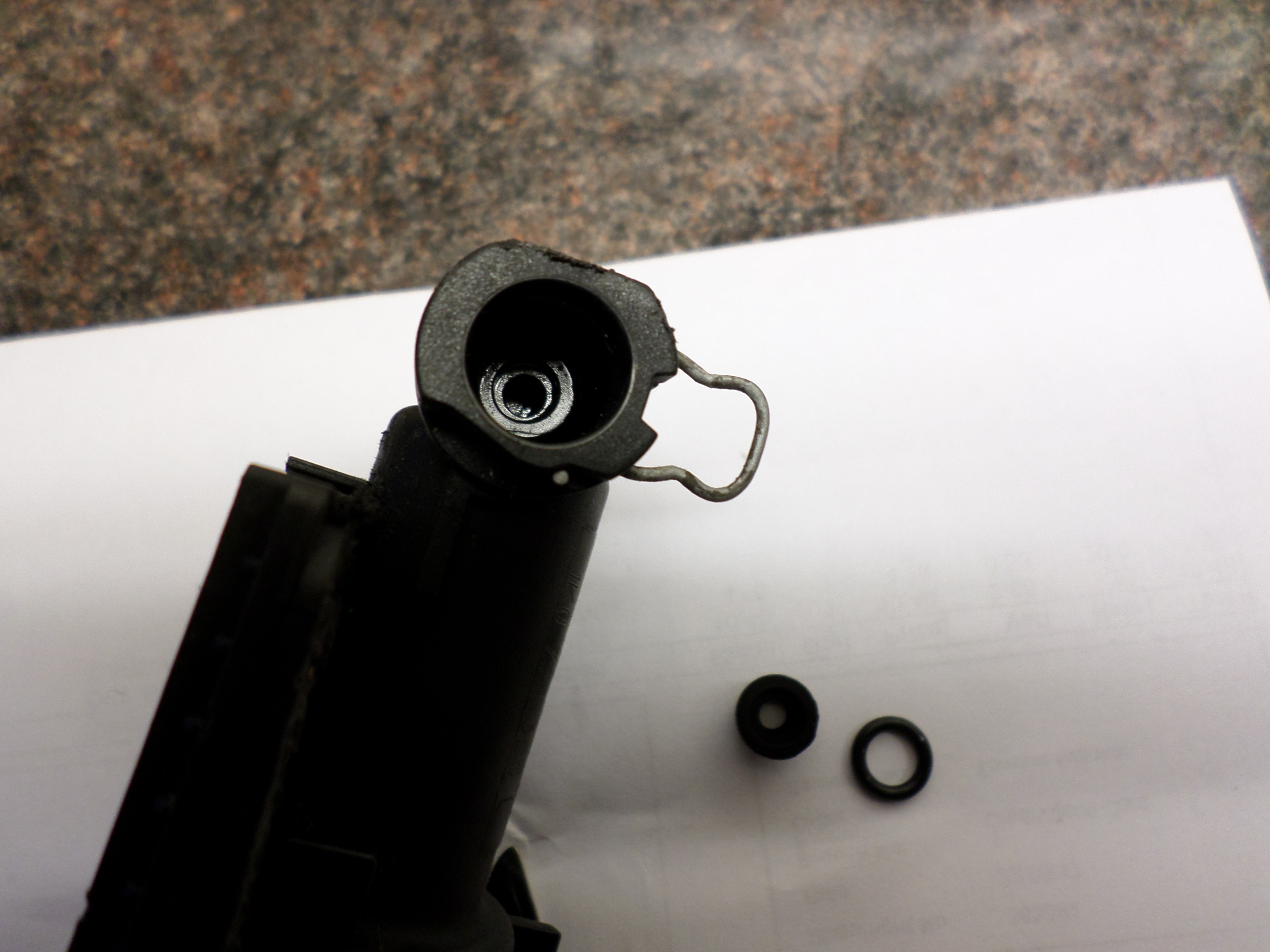

I have just fitted a new clutch master cylinder to my 2006 Octavia 1.9tdi following the "pedal stuck to the floor" syndrome.
Try as I might I cannot get the hard pipe to master cylinder connection to stop leaking, God knows where the old seal disappeared to.
I never once saw the old seals, I assume they jumped off and are somewhere on the undertray?
So today I fitted a new seal, (the "top hat" shaped one only), pushed the clip retainer back in, pressurised the system and and it is STILL leaking!

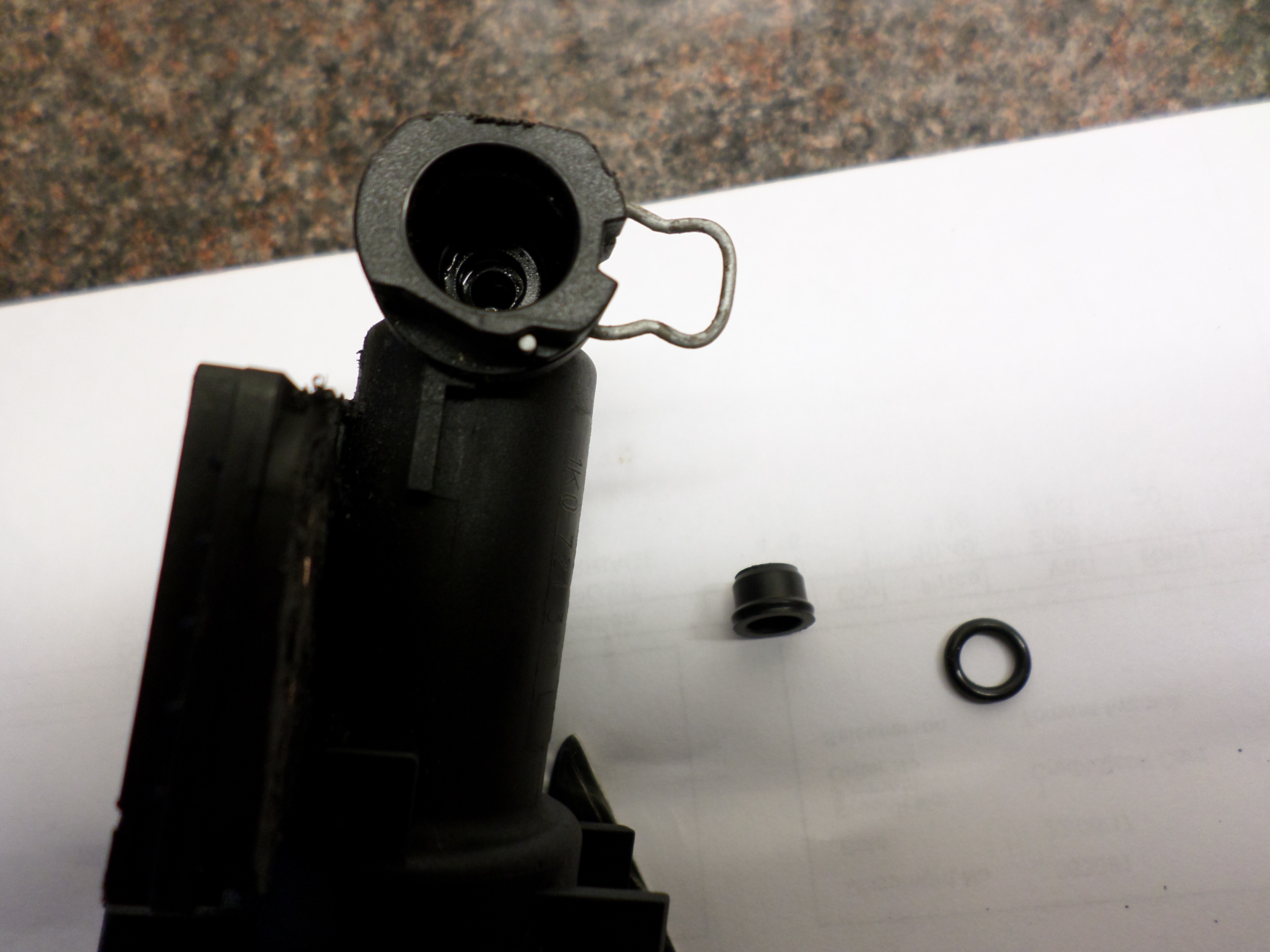

See the attached photo of the new seals I got, The "top hat" shaped one fits neatly on the end of the hard pipe so that seems ok, but where the heck does the O ring go?
BTW the cylinder shown is my old one, (you might notice the electrics bit is missing, that is another story)!!!
