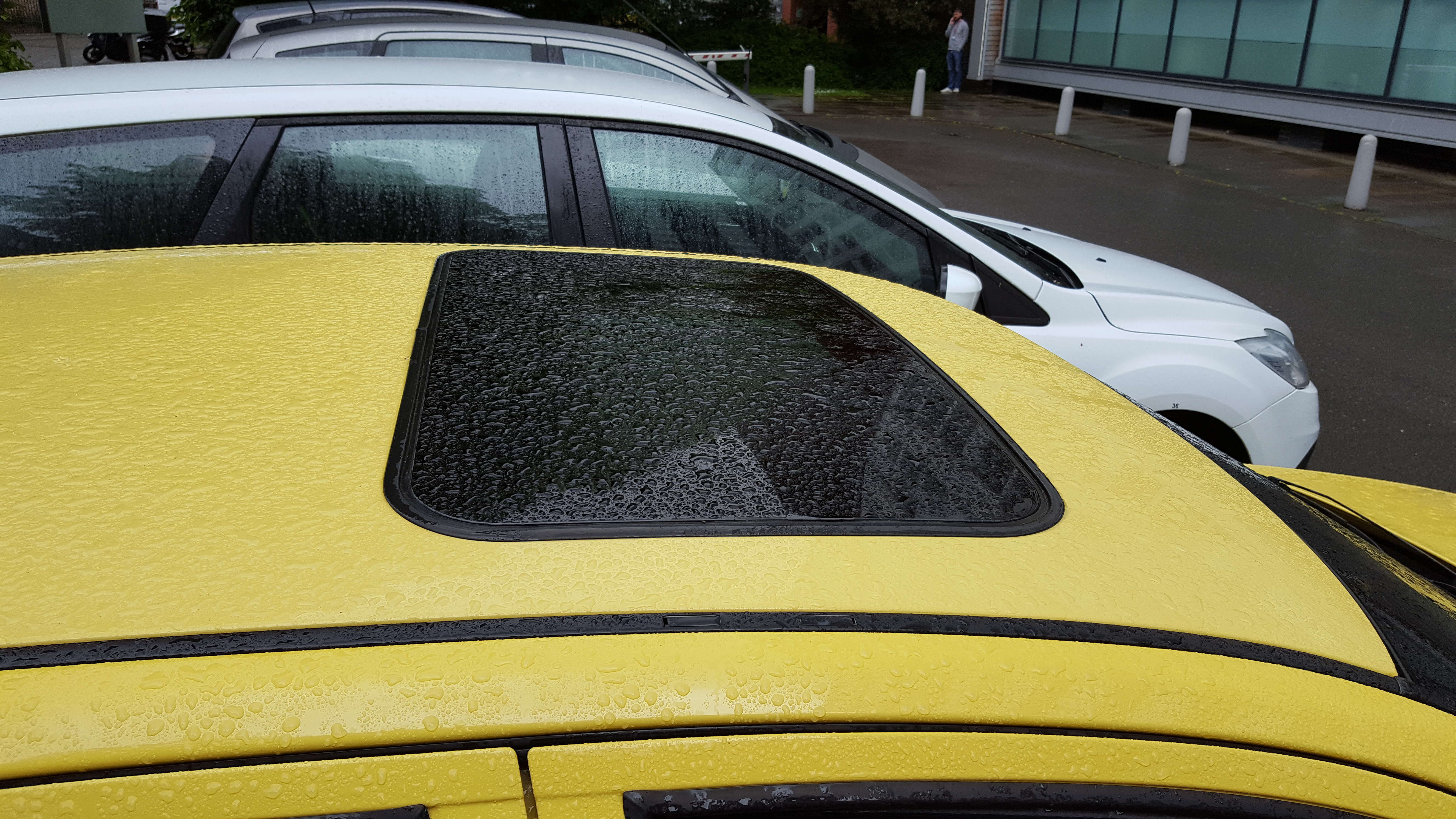

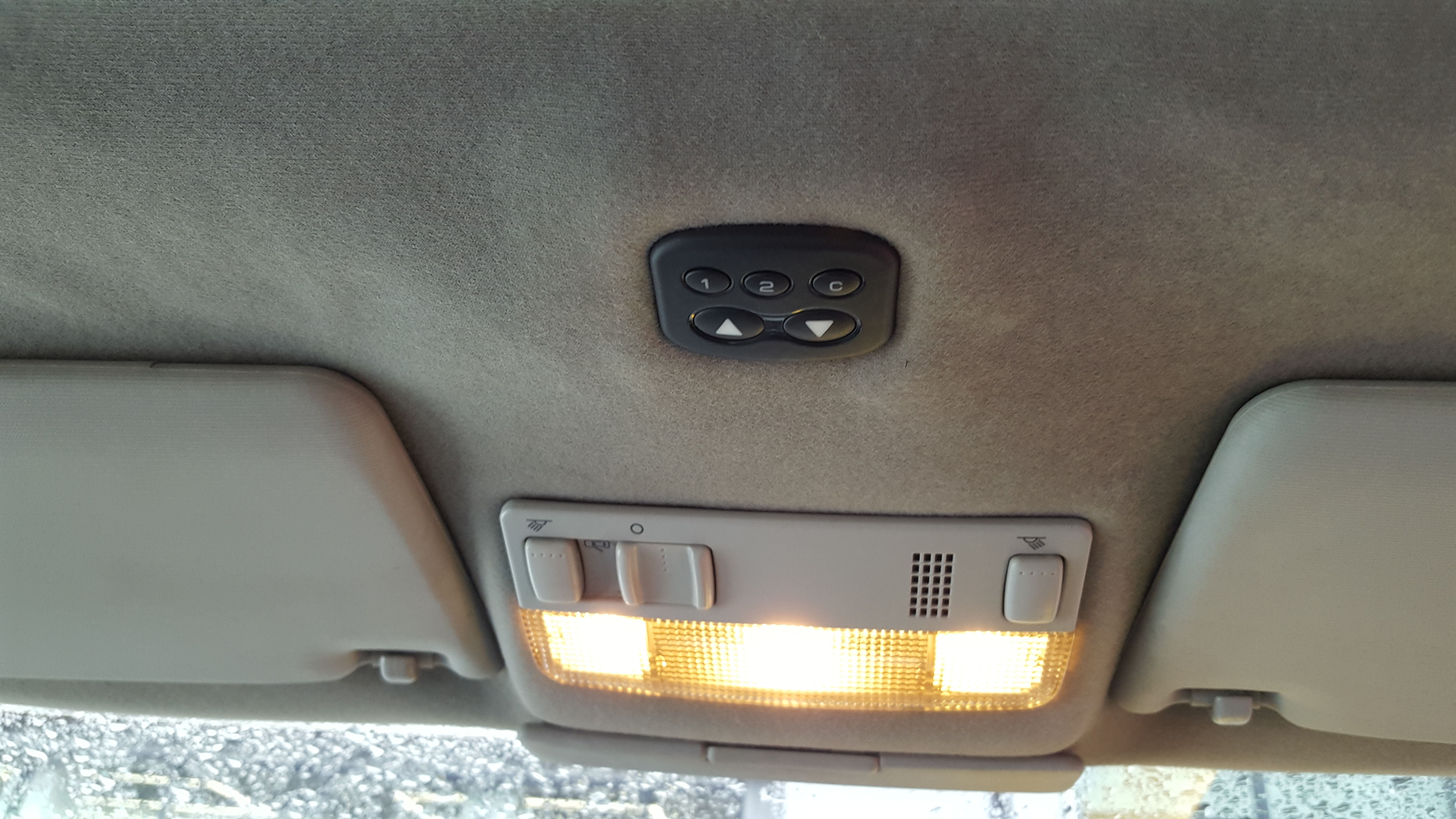

I have faulty rear parking sensors on my Lemon Yellow RS mk1 that went wrong last week. The speaker comes on in reverse but gives just one long beep and that's it, regardless if I am close to an object or not and then switches off. The sensors on this are dealer fit DIY as in bumper strip and wire crimped into reverse light wire. The same skoda has a Dealer fit DIY sunroof with white headlining. I herd that's RARE, sunroof in white headlining. The sunroof controls are 5 buttons not a turn dial if anyone wanted to know or interested and the glass is same make as OEM Skoda Splintex.
