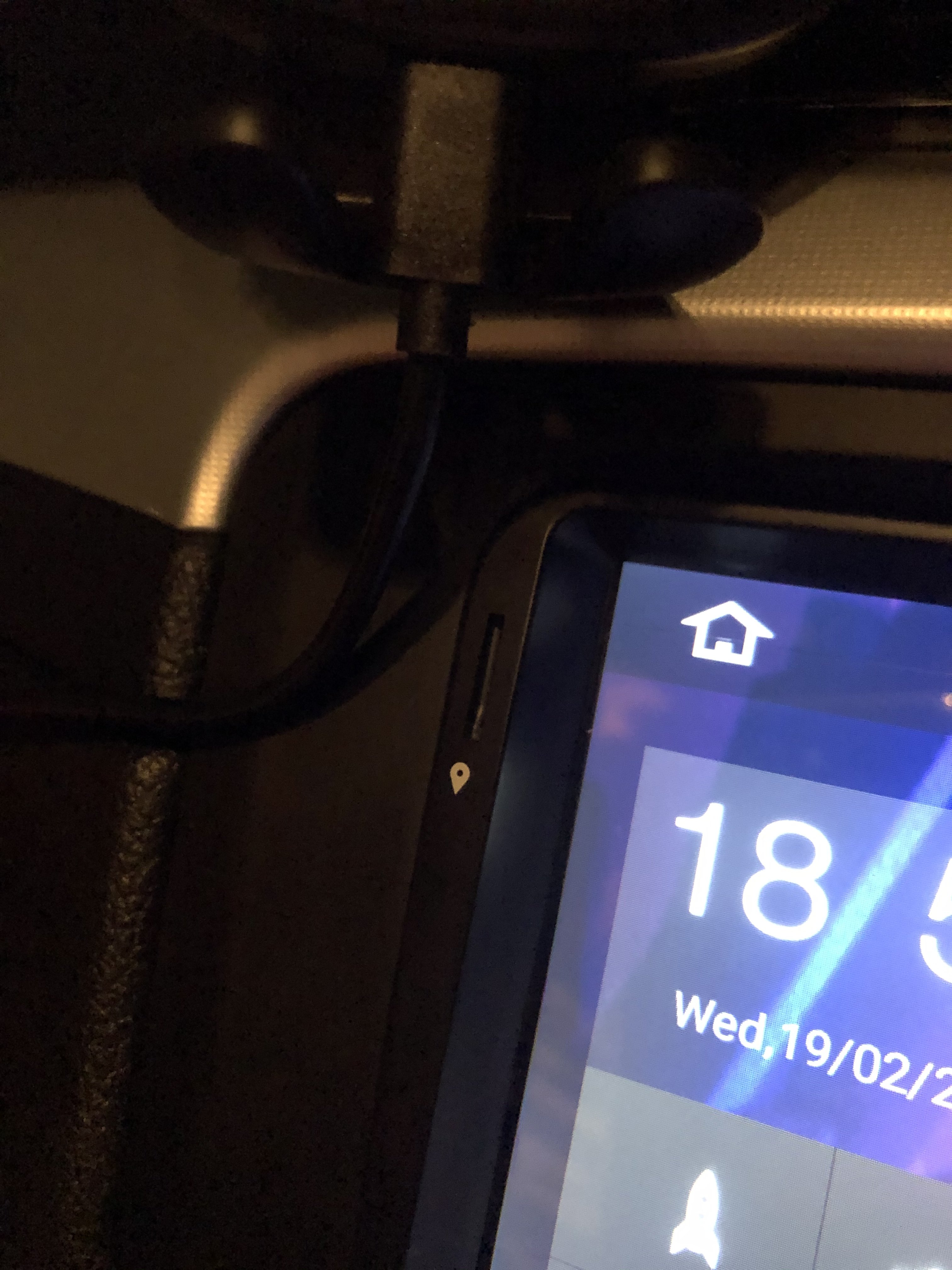

3 - What's this slot (pictured) for? A memory card or sim?

The slot is for a micro SD card. I got the impression it was something to do with GPS or map data, but haven't yet worked out what.

Ahh okay, it has a location symbol next to it, so I wasn't too sure. Thanks for clearing that up. I've just ordered a reversing camera to fit to it :)

mine came with Sygic pre-loaded on SD card although the slot isnt marked as yours is

mine is a standard SD slot for music etc
