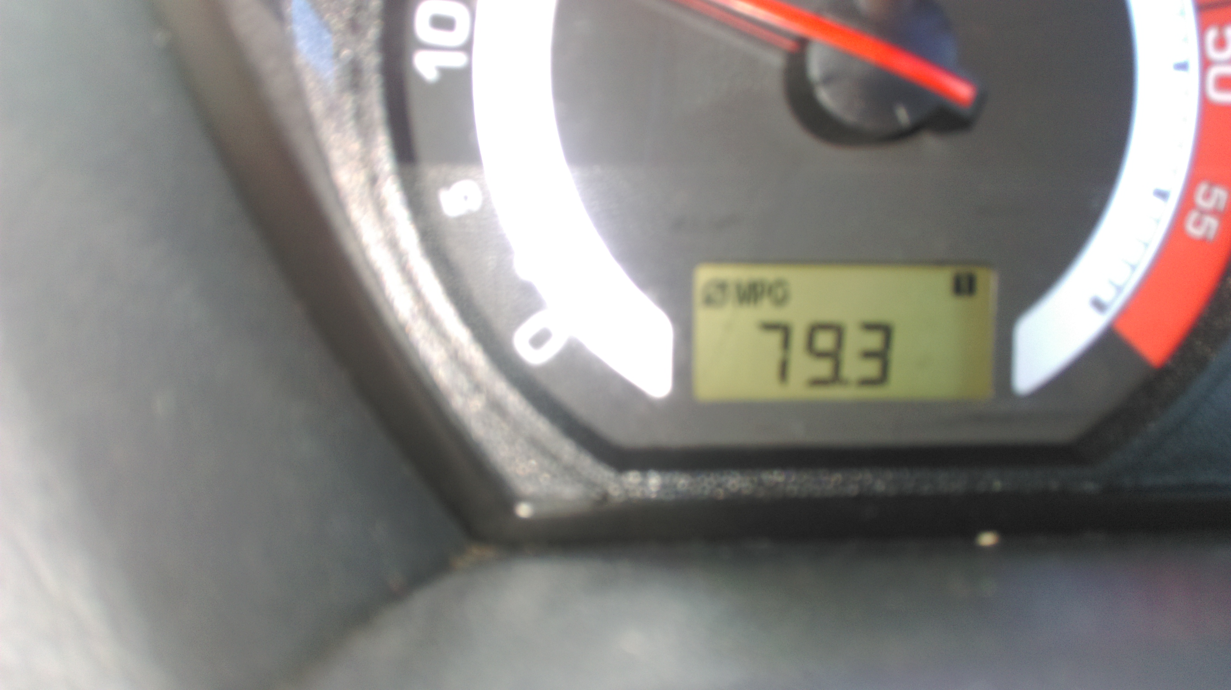

The 5 speed 1.6 diesel Greenline was the most economical. I often saw 60+ mpg on the maxidot and over 70 on some leisurely trips.
