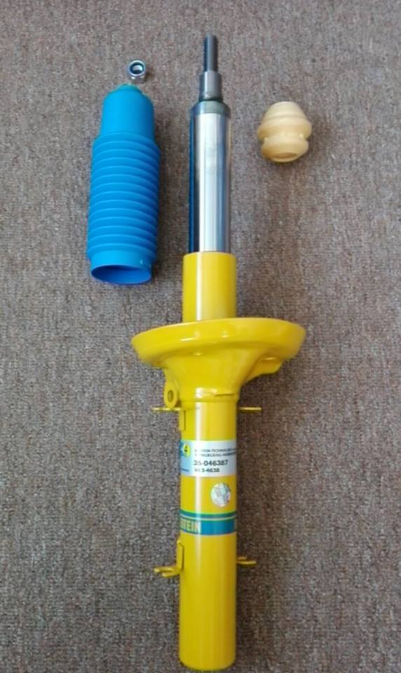

Ok, i have B8 dampers at home, but am i need this (orig. vrs)? Because i dont know how can it fit.
20496268_1527849690616008_1878427995_n.thumb.jpg.79fb7e8588583236511c0537536c094d.jpg
