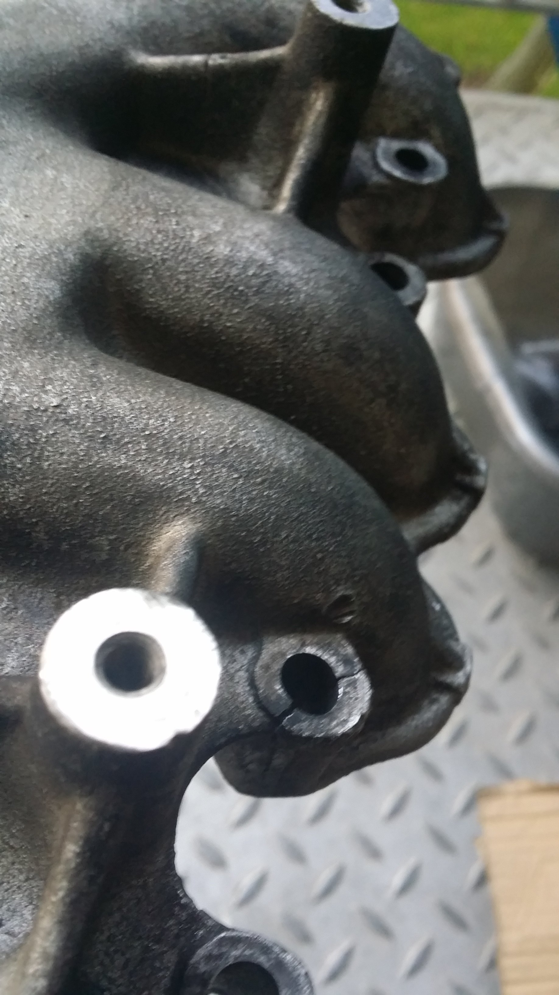

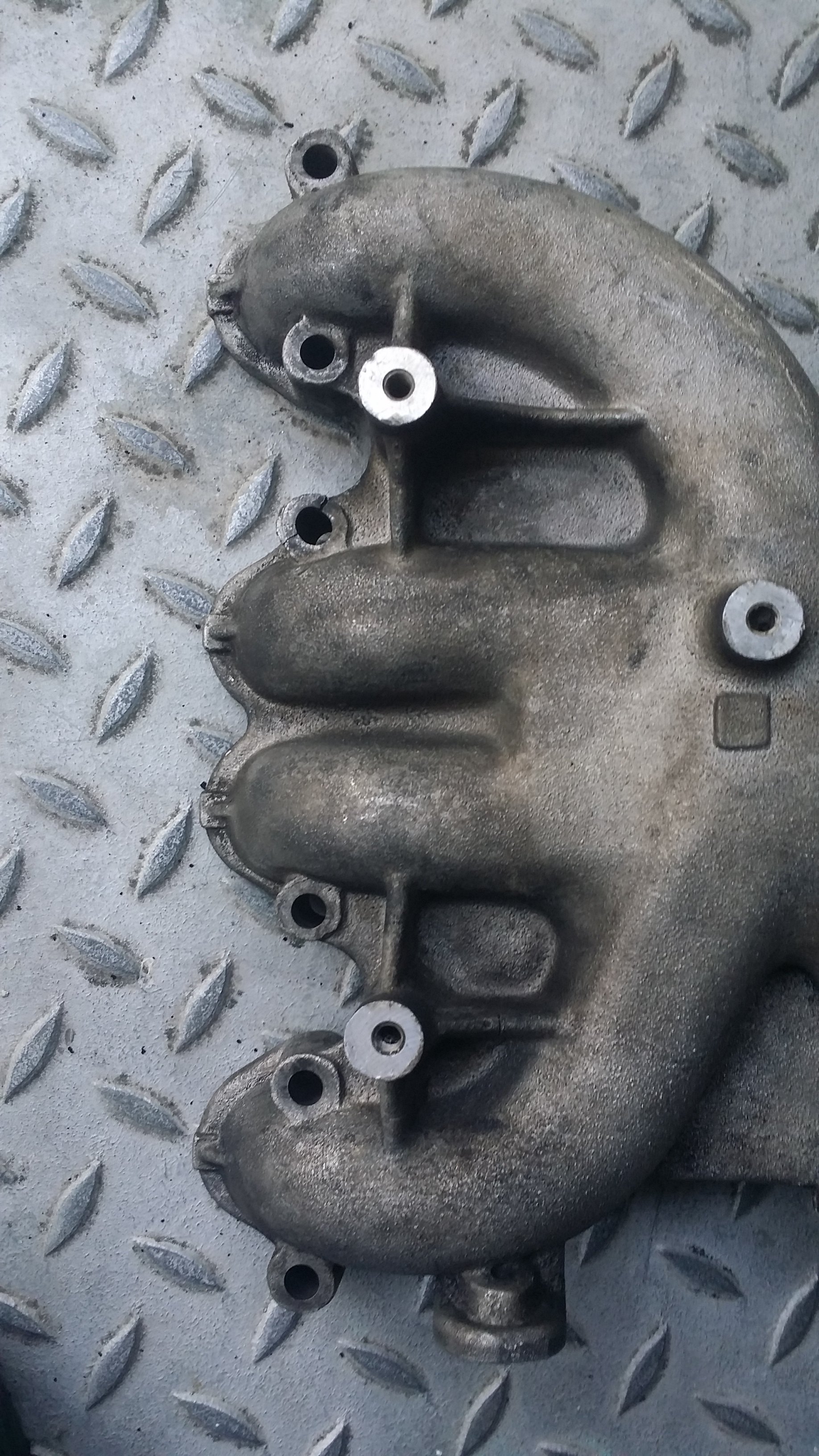

Well.. crap. I'm not sure if this was pre/post cleaning. I forgot to check the intake manifold properly after shipping.
20170731_194121.thumb.jpg.faafff5d13b17b9181ef8536b830fb72.jpg20170731_192615.thumb.jpg.d9e9a3e91a4e4a9e68dc85952685fffb.jpg
