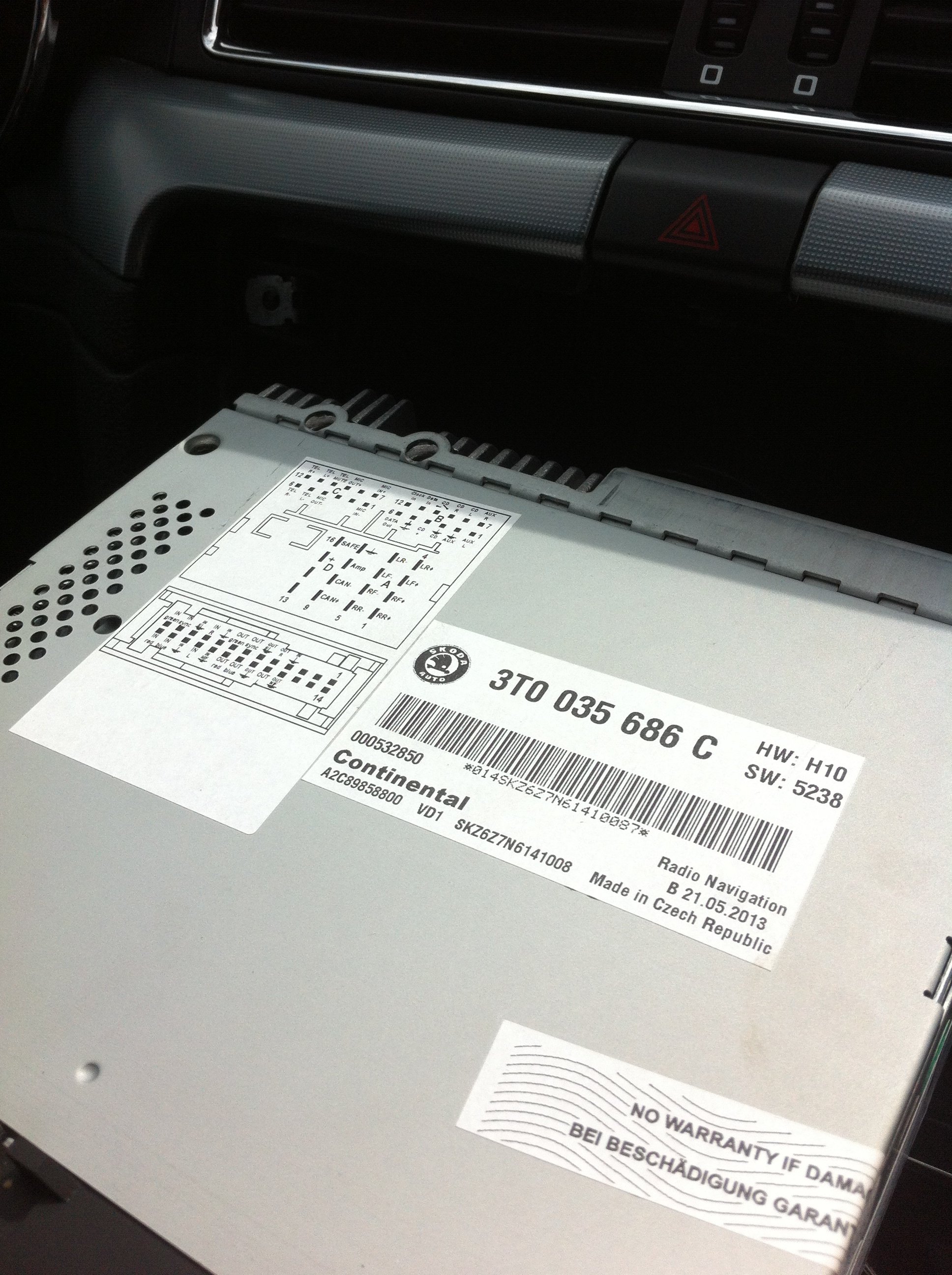

Hey :) i just bought me a 2009 Superb 1.8 TSI, love the car, but my DAB radio dont work, all the channels are quiet, its only DAB and not DAB+ i think so that could mabye be the reason.

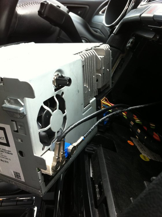

I removed the columbus and here i see that its from May 2013, so it has to be replaced. But i wonder if someone knows what the black port in the top of the Columbus is, could it be the for DAB antenna??
And under the GPS antenna (blue and white contact) i see that there is a big port, and i wonder what that is? Could it be possible to install a USB port from that? any experiences?

Black connector is the dab antenna. That looks like your problem. The other port is for reverse camera.
