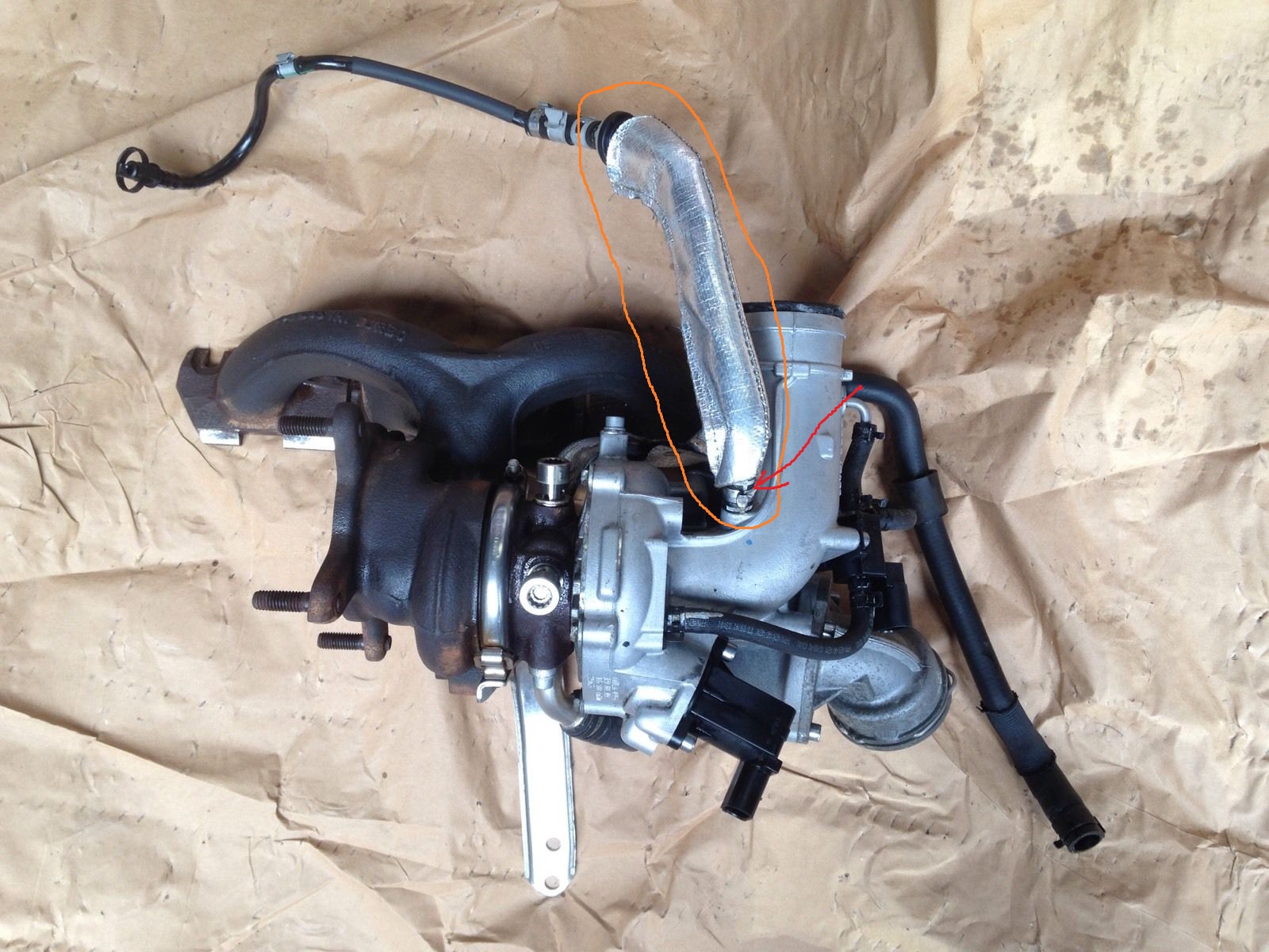

Cheers mate.  I've got the pipe and valve, but the crimp clamp I need to remove is on the charge side of the turbo so, like the N75, it's going to be a bitch to get off:
I think I might try to get these off and replace them with spring clamps...
You can also put a flat blade screwdriver into the crimped part of the clamp and rotate it to open it up, as it opens wider use a bigger screwdriver and repeat until you can slide the pipe off . Replace with a stainless steel jubilee clip
