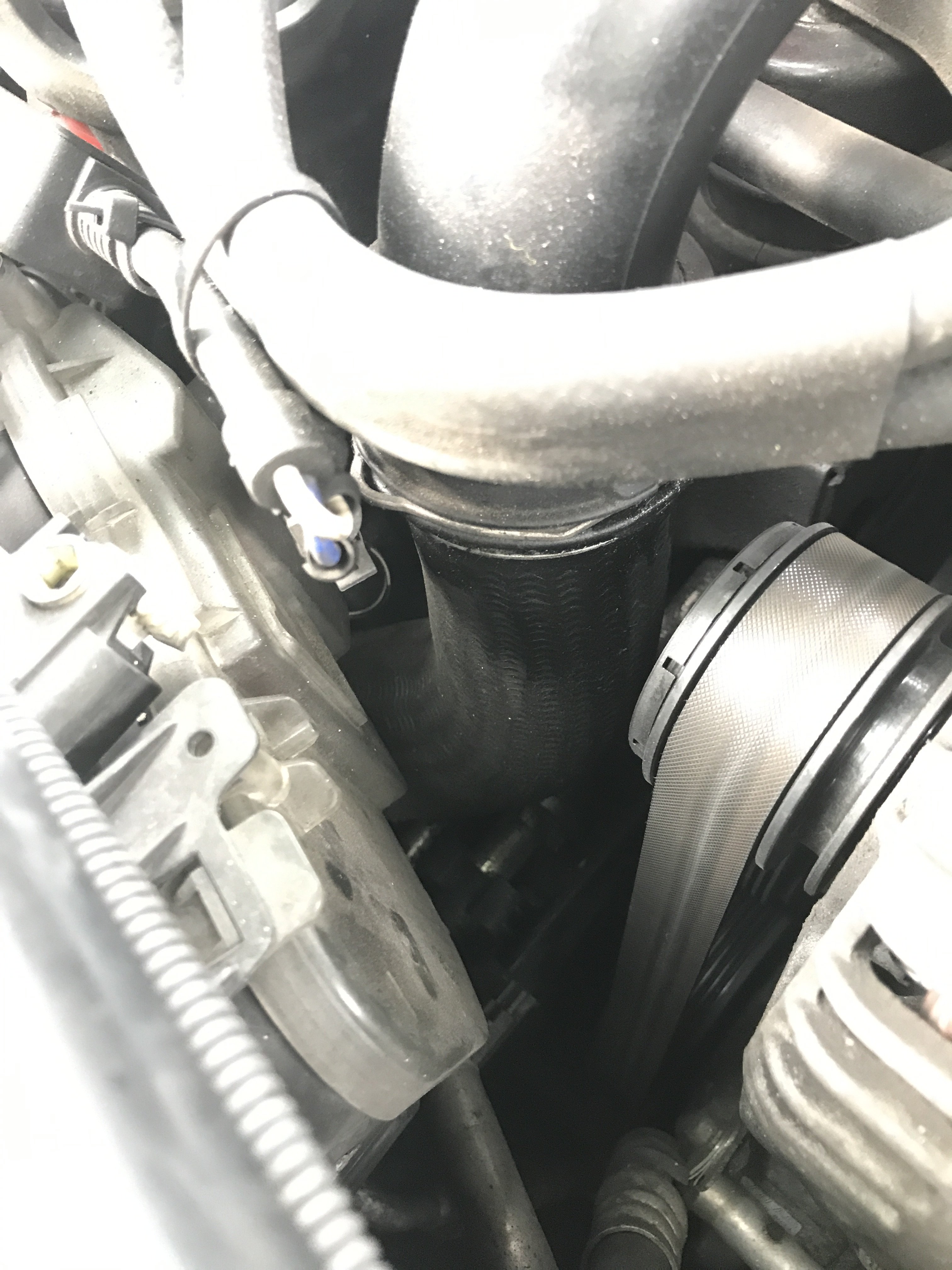

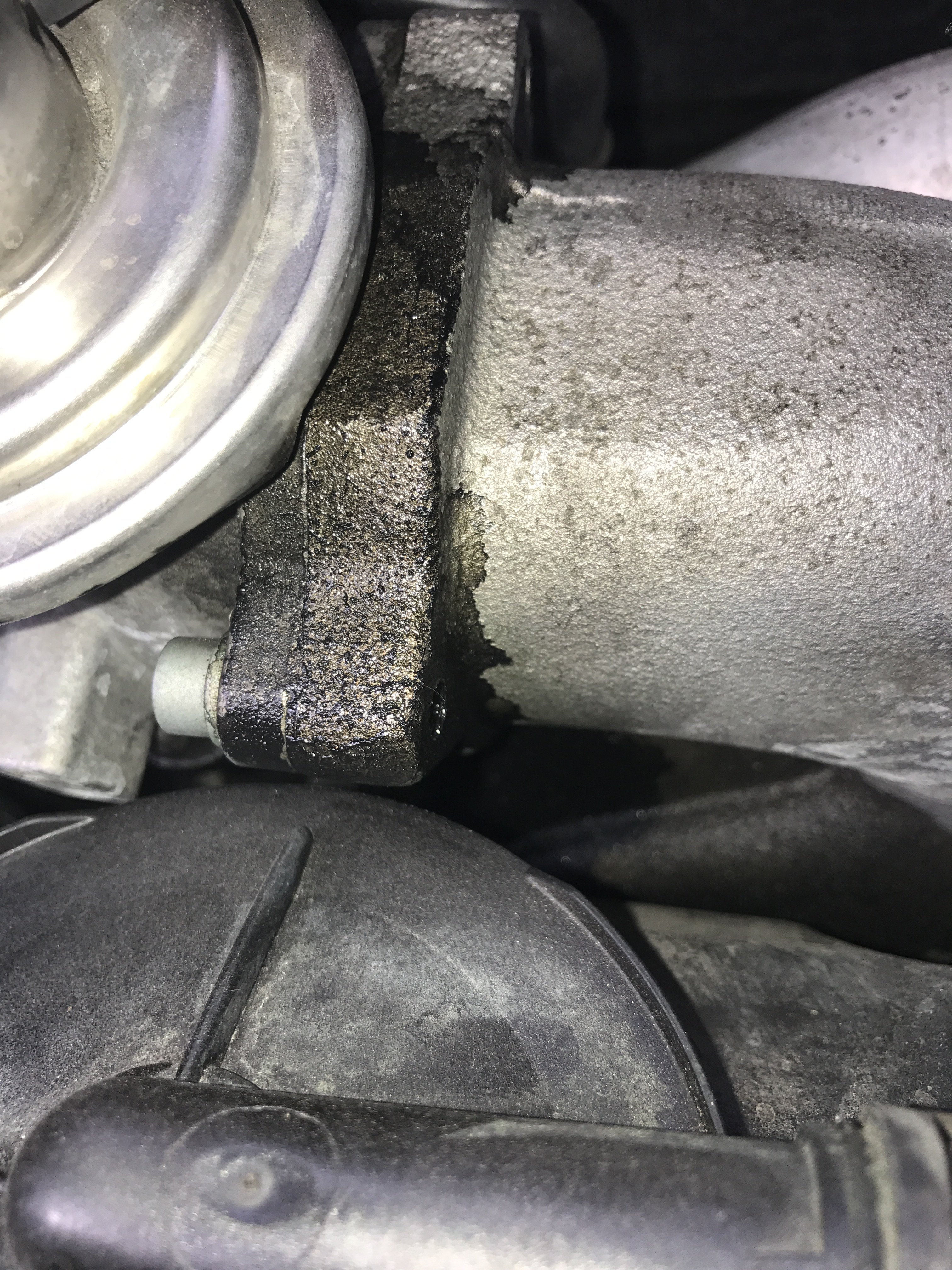

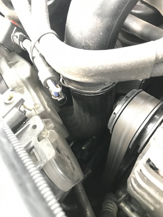

Noticed some oil around my EGR when I first bought the car a month ago - cleaned it all off and now 2 maybe 3 weeks later possibly a tad more it's all oily again. Also noticed on the boost pipe that runs down the side of the radiator is also oily. My car has recently been mapped, seems to smoke around 3/4K rpm however no smoke lower down in the rev range and as the car comes on boost there is a slight whooooosh sound around 2k RPM. More noticeable in higher gears e.g 6th on motorways etc, the car feels possibly down on power however this could be because I'm used to the extra power of the remap. Here's the photos I have taken hopefully someone can clear up for me

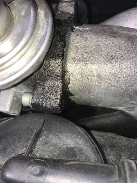

oil is more saturated down rear of pipe pipe however I can't get the phone down there to take a photo!

This is normal / very common and nothing that i would worry about ,but yes in effect they are small boost leaks/very small boost leaks.
OkY thankyou I'm yet to look into the other boost pipes as there is certainly a whooshing sound on boost and the car sounds different on boost, a lot more "airey" than before and there's no real soot until about 3k rpm then there's a dust cloud left behind the car lol. Is there a way I can get a check for boost leaks or simply have a visual inspection?

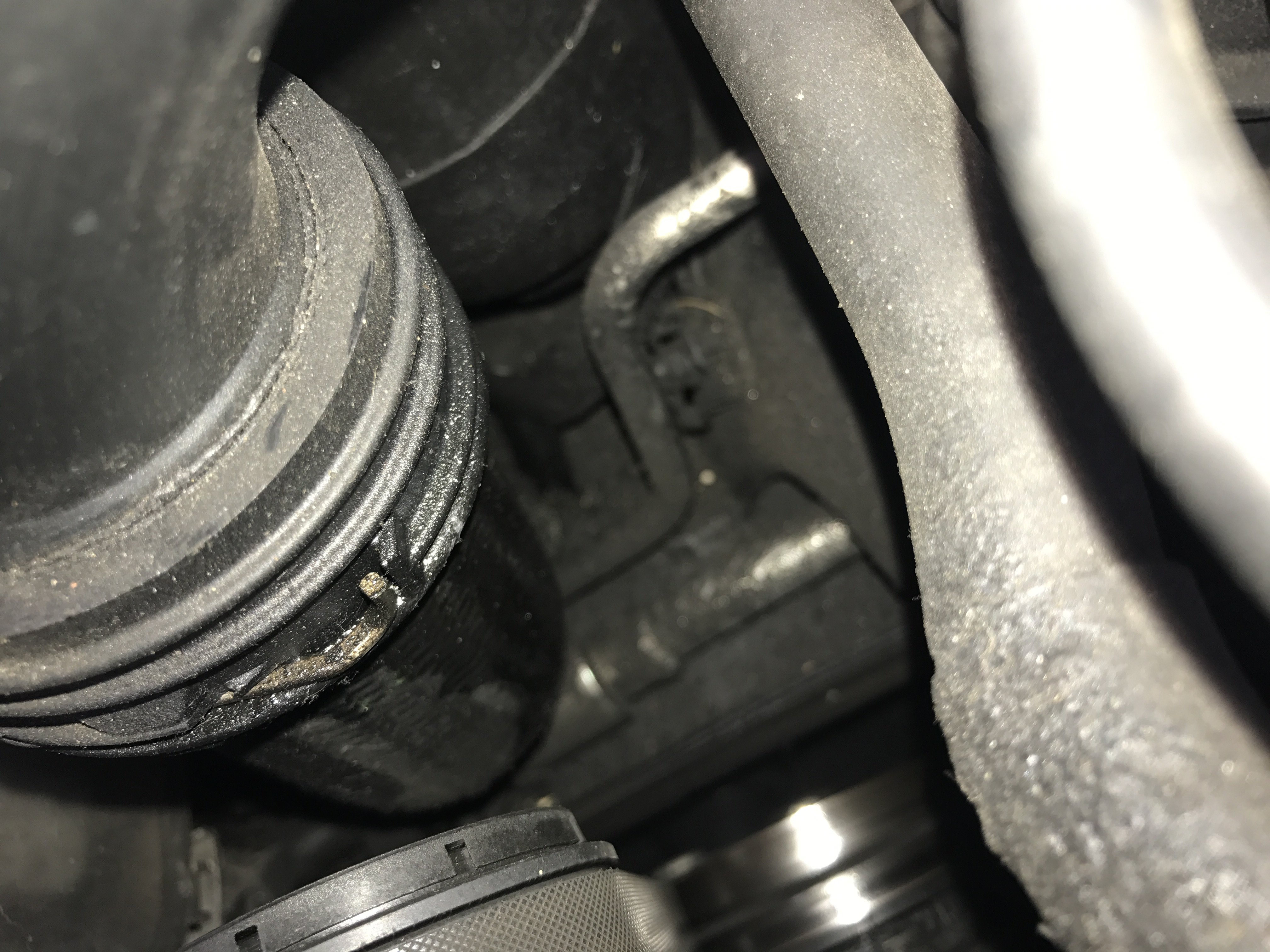

Think I may of found my boost leak :D now how to fix it?

in in terms of asking how to fix it I didn't want to screw into the boost pipes as there is possible swarf that could enter boost pipes so I put a cable tie on top and bottom boost pipe then various ties to pull the pipes together until I order all the other pipes

Dude, there are literally dozens of members here who've used the self-tapper trick and no-one's ever had a problem, which is why I suggested it.
You're being too precious and you're overthinking this. It's a car, not a person, just get stuck into it, you only need small pilot holes for self-tappers and swarf comes OUT of the hole via the drill bit flutes, in any event an engine will happily munch tiny aluminium or plastic fragments without even belching.

Ok, the thing is that by definition a boost pipe is between the turbo and the engine which is why it's under boost pressure, this means it's downstream from the the turbo and any little fragments will get blown straight through the engine by that boost pressure, they can't sprout wings and fly upstream back to the turbo and damage it so it isn't a problem. I've drilled, tapped and helicoiled spark plug threads in an alloy head without removing the head with no ill effects, only hard materials can actually damage an engine.

Just pointed a torch down to the intercooler and gave the boost pipes a wiggle seems the pipe that had the original boost leak is also leaking at the intercooler side! I'm guessing this is a bumper off jobby?
