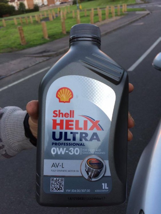

9 minutes ago, r2mc2 said:
don't put that anywhere near the TSi it's way to thin and it will just burn it straight off , the TSi must use as minimum 5/30. 5/40 is defo the best to use and switch to fixed servicing (every 9200 miles or 12 months which ever occurs first)

was recomanded by skoda :angry:....i was there for a travel check....i will call them monday morning

I can see the Shell Helix Ultra is vw504.00, it is approved for Long Life 504.00 and will be ok. It should behave like a 30W when at operating temperatures. Are you in a particularly cold weather area?  The 0W when cold helps with cold temp circulation until at temp.
A 502.00 5W40 might help consumption a little but I am afraid 1litre in 215 miles sounds terminal.  How long have you had the car, who did you buy from?
 There is a fairly regular trickle of this fault coming across this forum, if you search you will find others who have experienced the same thing and the outcomes. Eventually, the engine will fail from that amount of oil burning. I suppose it could be a turbo fault as well but more likely to be the dreaded ring problem.
