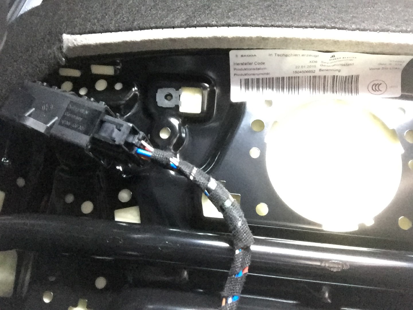

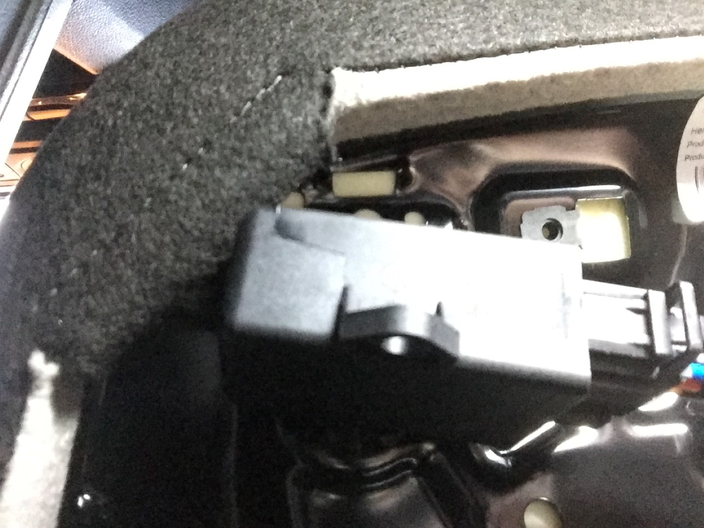

Unfortunately there is a large bunch of cables that come out of the under-seat loom and terminate at the inside corner of the seat in a large plug and small black box (see photos Passenger seat (Large).jpg and Box (Large).jpg attached).

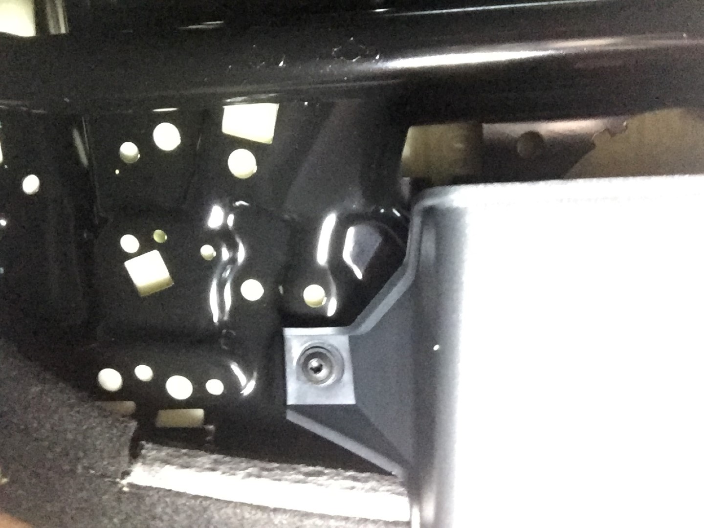

I am not sure if the above black box is just a termination cover for the plug or if it contains electronics. Unfortunately the thickness of the loom means the chassis of the storage drawer will not locate in the two slots of the seat pan without dangerously distorting the plastic carrier.
Does anyone know what this cable is used for? There doesn't appear to be one under the drivers seat as can be seen from other photos.
It is located in a square hole and removes from the seat pan with a quarter turn and I could relocate it behind the carrier but don't know if it needs to be readily accessible as part of servicing or diagnostics or if it has something like an accelerometer or similar for tightening the seat belts.

I can certainly do that. However before doing so I wanted to ensure it was not some form of sensor e.g. accelerometer or similar that activated the seat belts, airbags or other safety item. Also was access by Skoda fitters as part of servicing or diagnostics required? If tucked behind the cage its not easy to access?

It was indeed that link that inspired me to fit my own seat boxes and have read through several times but there's no mention of the loom being in the way.

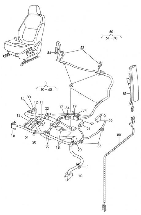

The Hood from the Yeti Owners Forum has kindly found a wiring loom diagram and I believe the plug might be either for the electric seat operation if specified or alternatively heated seats of which I have neither.
I think as no one is saying its a safety feature I'll just un-clip it and attach it to the back of the drawer carrier with a couple of cable ties as suggested by Sad555.

This is the link kindly provided by The Hood http://www.oemepc.com/skoda/part_single/catalog/sk/markt/CZ/modell/YET/year/2015/drive_standart/779/hg_ug/972/subcategory/972026/part_id/2540392/lang/e
I think the termination I can see under my seat is either 16 or 10 in the diagram. If you click on the links on the main website it takes you to a table which refers to seat heating for 16 but no real detail for 10.
