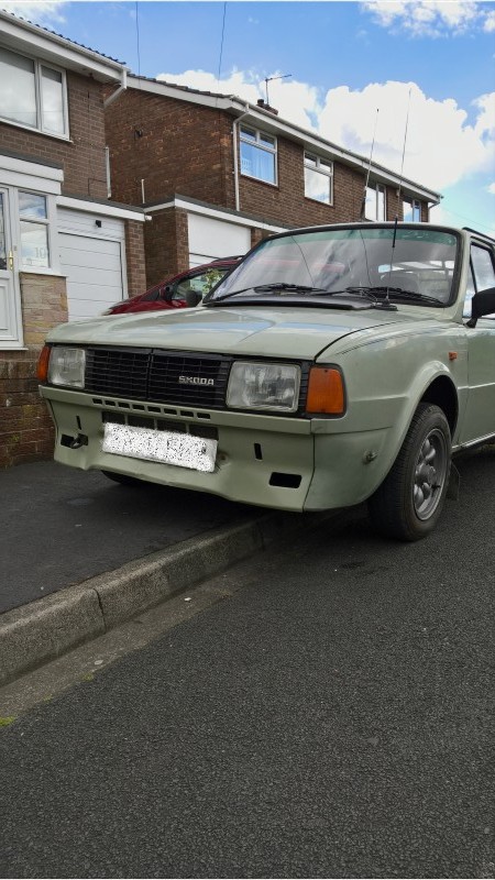

hi all first post on here just bought a 120l
i know the felicia 1.3 has an alu head was wondering whether that could be put onto my 1.2 block without too much of a headache, and would that make a big difference to the head gasket problem if both head and block were alu, i know i would need the manifolds but apart from that not too shure
will get some photos and a thread up about mine
