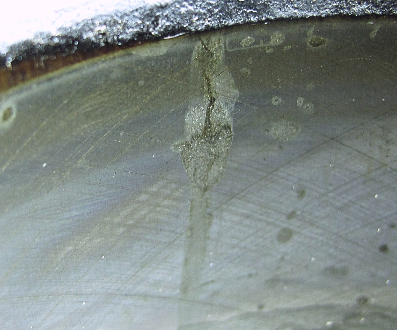

I took some pictures when the head was off. I sow something I don't  like, but since the gasket was gone I took the chance to no do anything with the cylinders.
Atfer some days the warning light an buzzer cam on. Low cooling water in the "fishbowl". Filled i ut and drive two day, and the warning came on again.
Then I study the picture - zoomed in and look with thick glasses!
I think something i wrong!
I will change the liner, piston rings an try again!?
