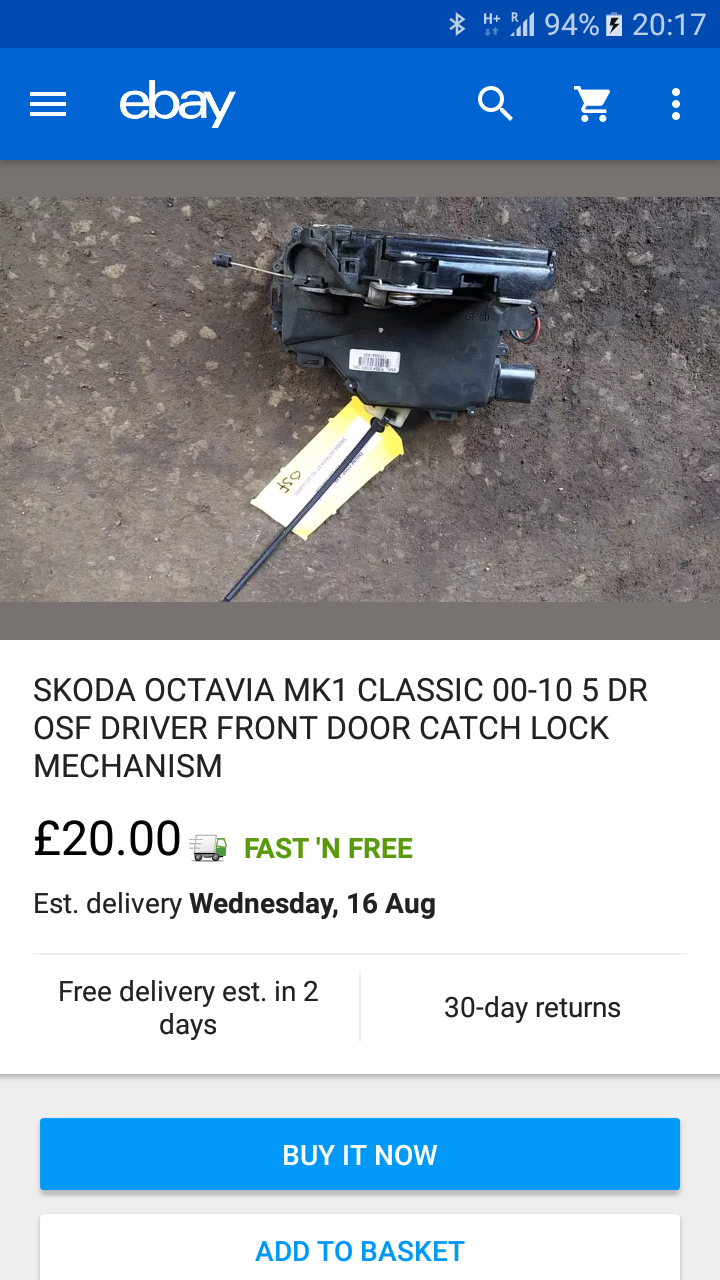

@vrsTom is this the badger I'm looking for?
That's the entire mechanism/driver convenience unit.
It will work, but for about £6, you can instead just replace the microswitch, as per this thread:
I'll be replacing my own later this week, if I get teh time, although since flooding it with contact cleaner and WD40, it has started working.

Thanks guys all done following that guide. I just replaced the whole mechanism as a pattern part was £20 off ebay. Took me just over an hour and has fixed multiple issues.
