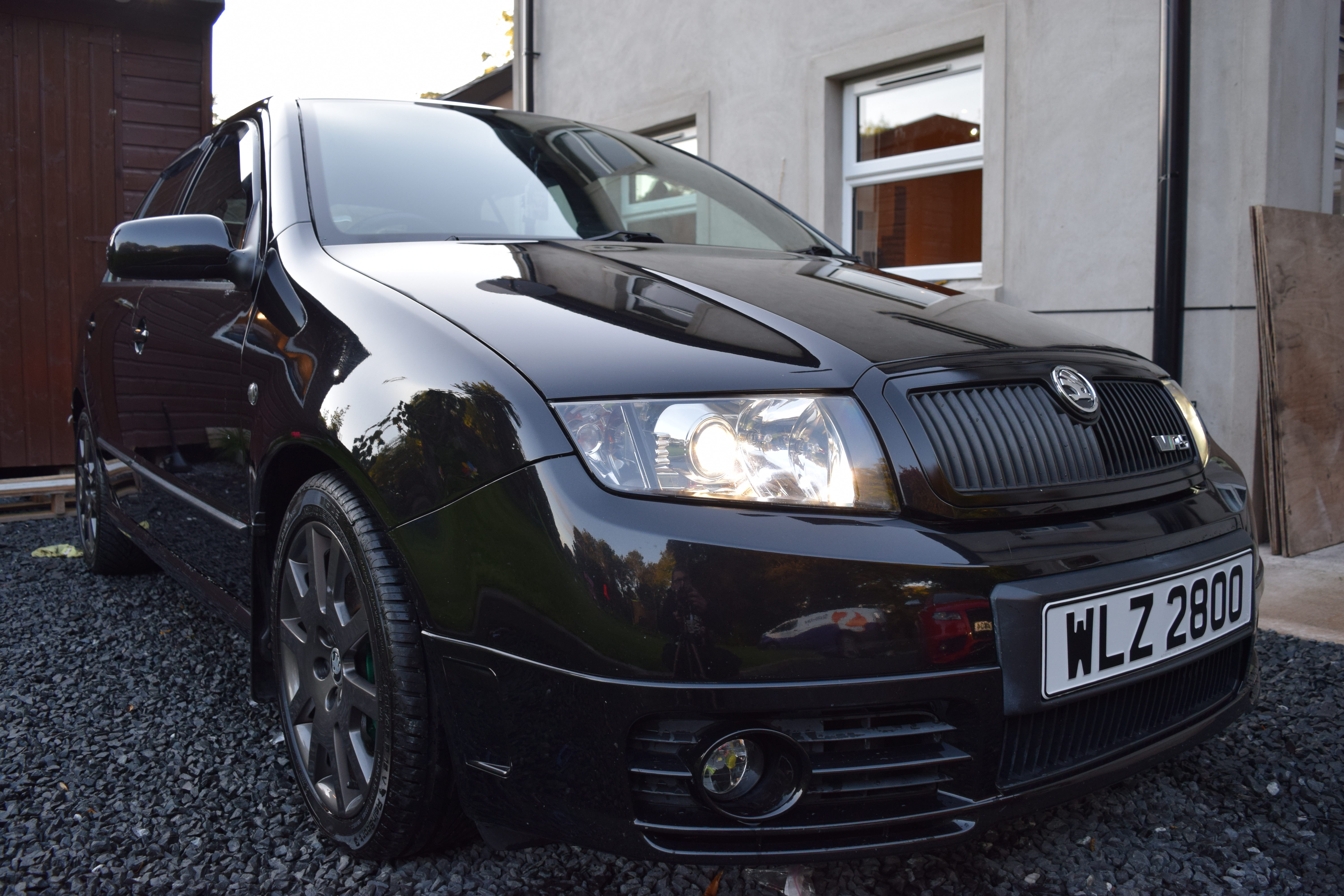

I've just put eibach Sportlines into mine. Sits 25mm lower. Also put new Sachs shocks and new top mounts in aswell. Handles excellent now
looks lovely, want to get mine looking like that, you just used the standard sachs shocks? do you not need shorter ones?

Nope just standard ones matey
