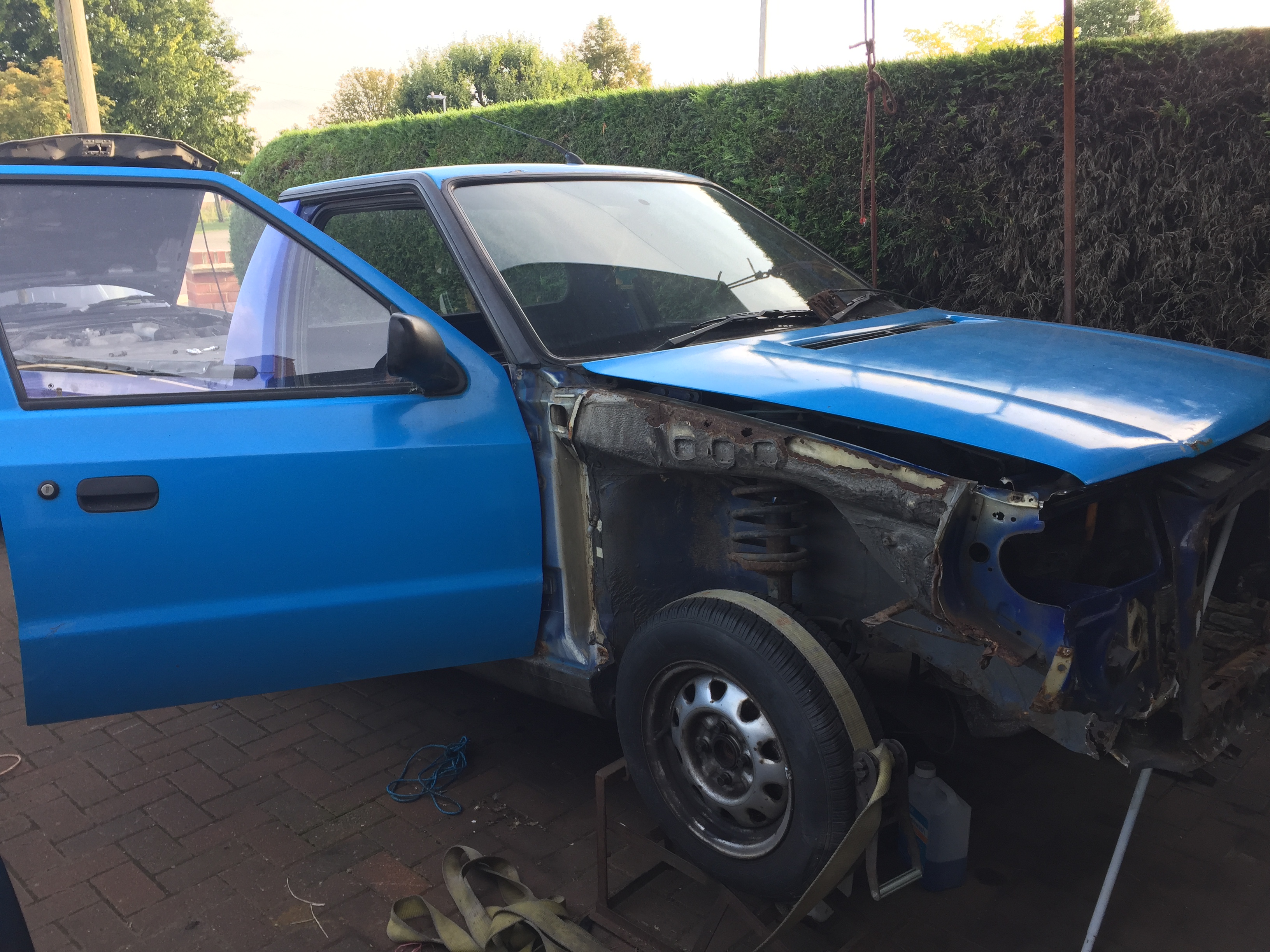

Finally after 6 years of getting it together, I started my engine swap into my skoda pickup. PD130 out of a fabia vrs.
Job number 1. try and get it to fit in.

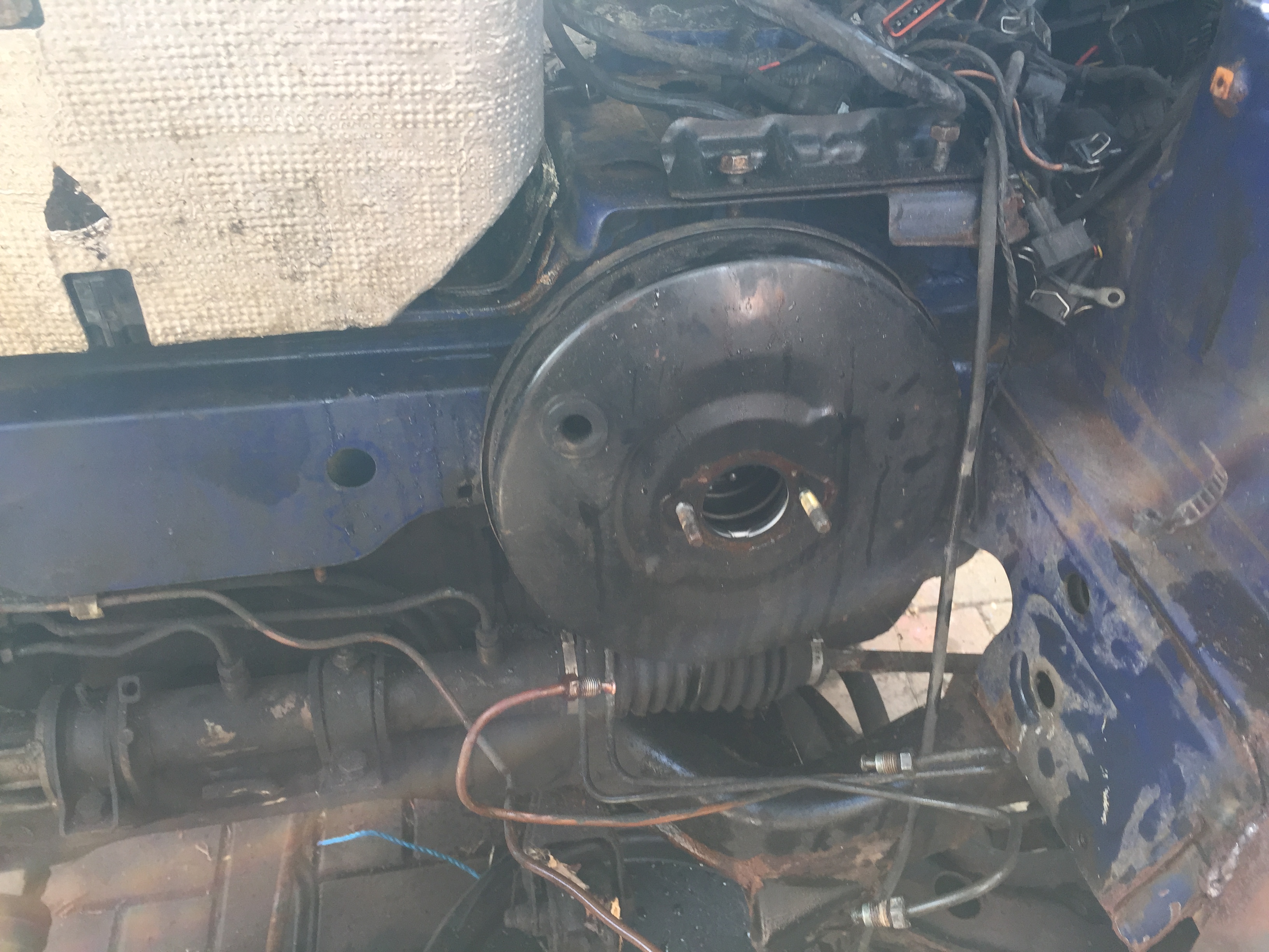

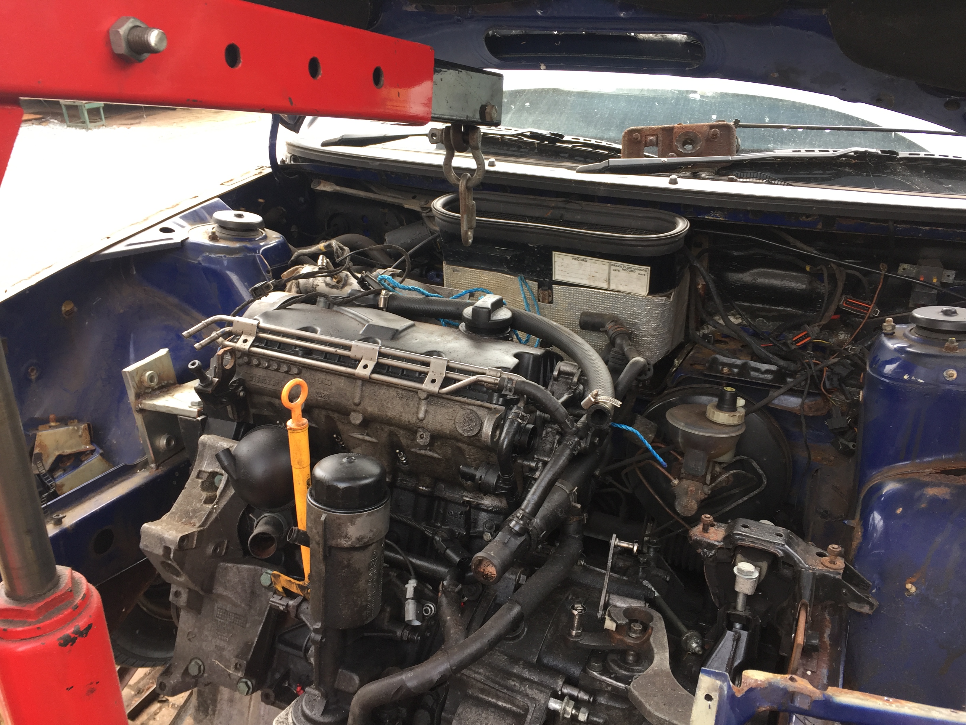

Last Saturdays job. See if engine fits.

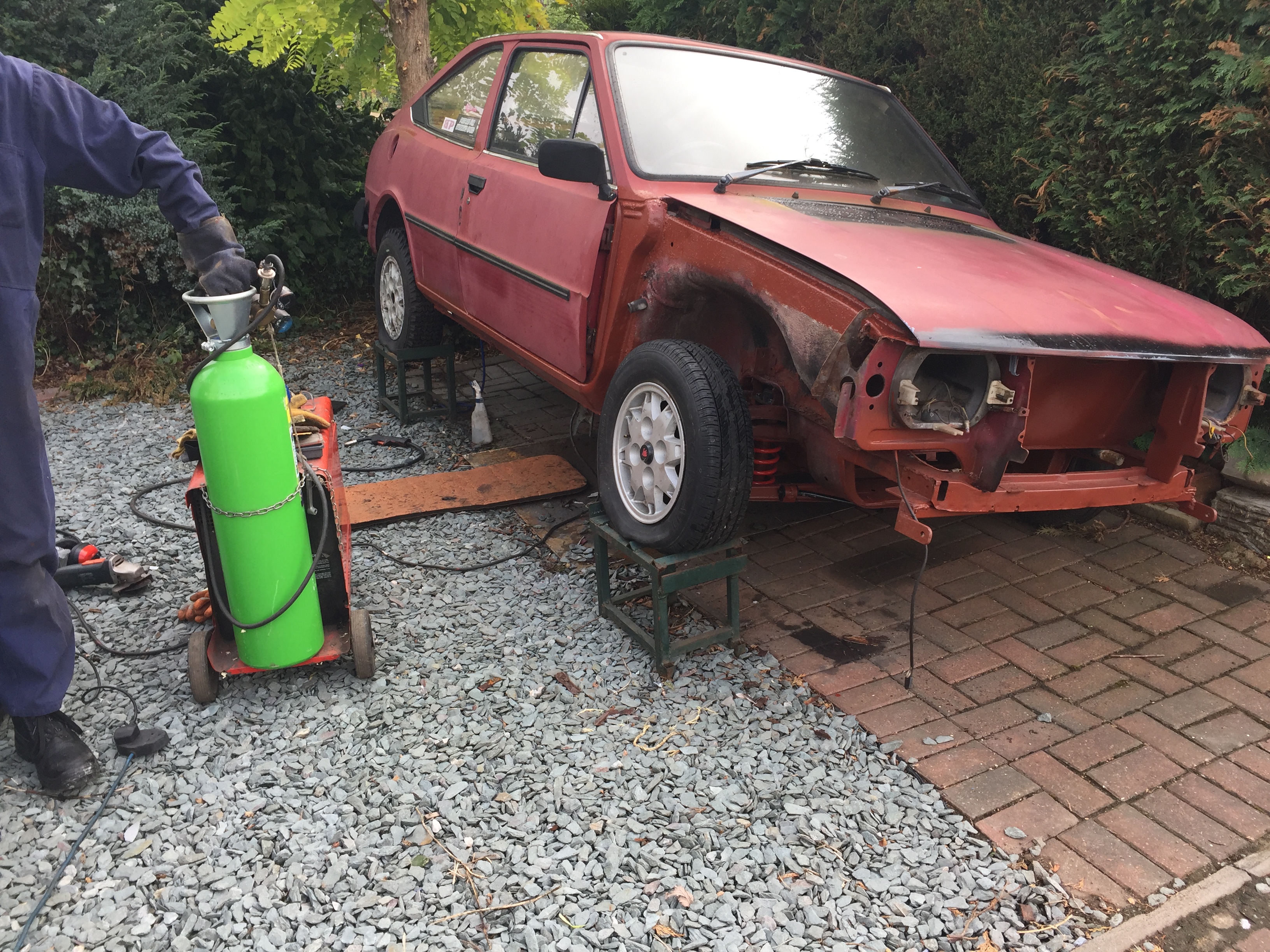

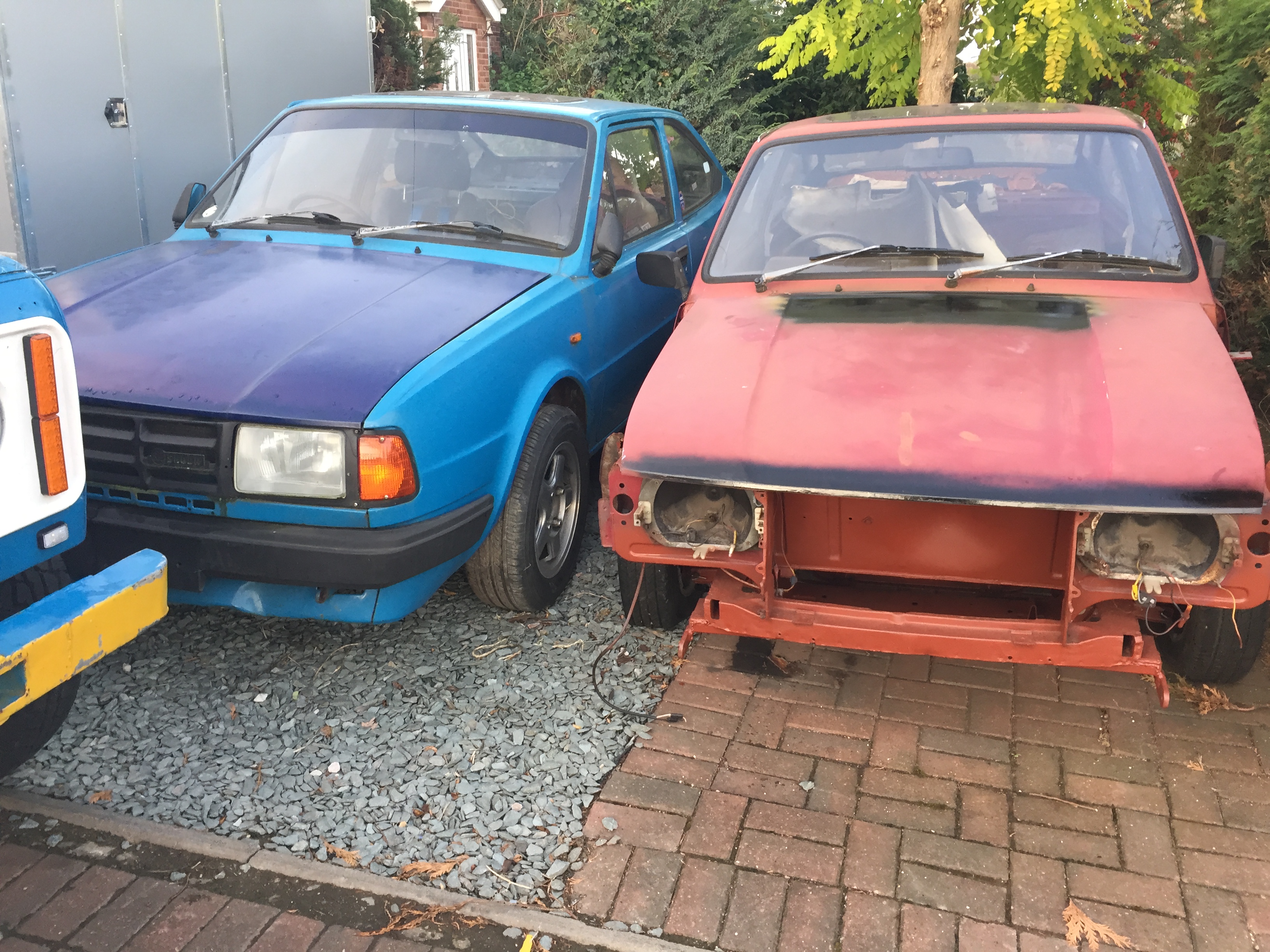

Oh work on an old rapid aswell.

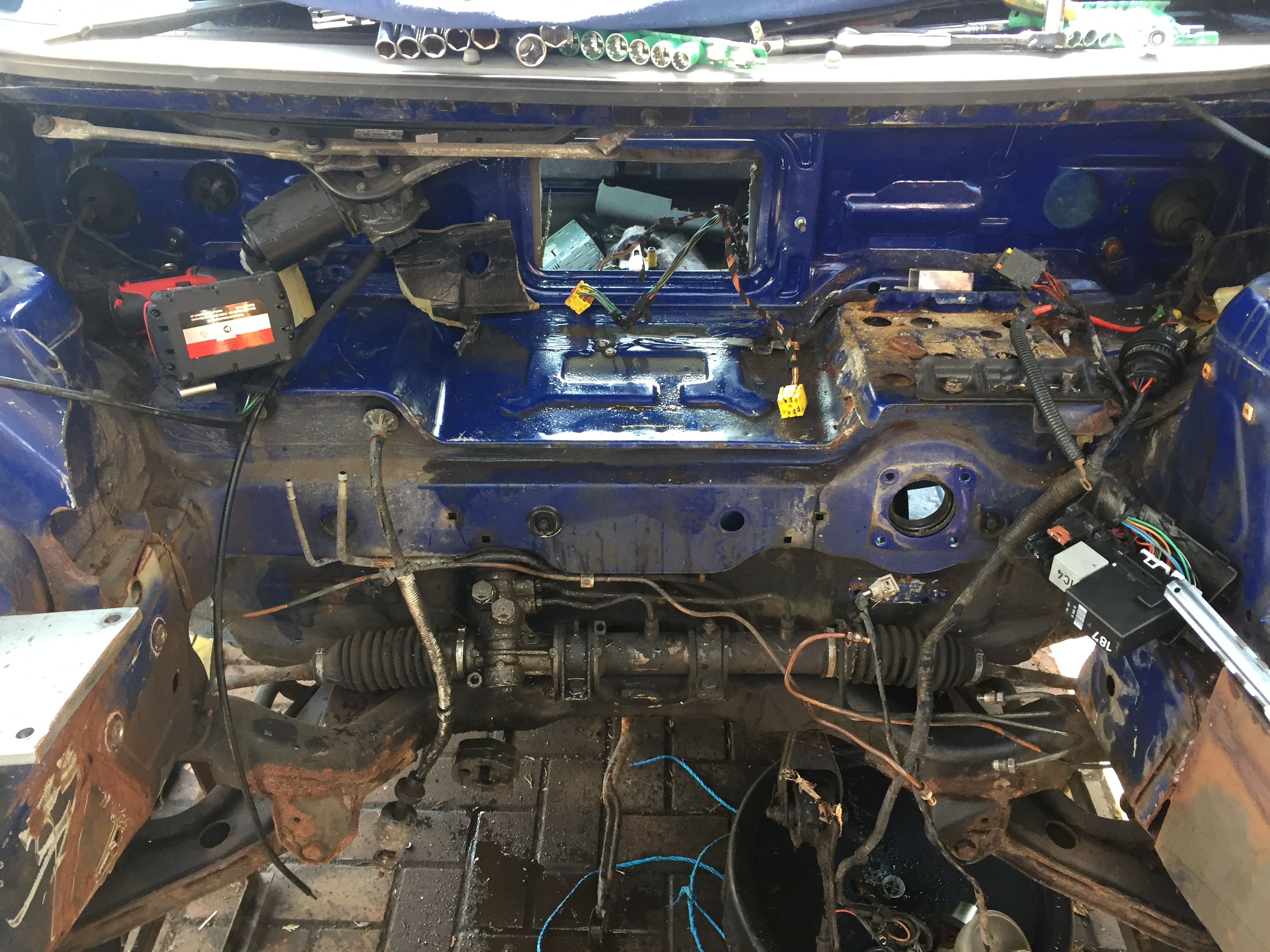

No it does not. Need to loose heating and breaks.
Edited by rob w

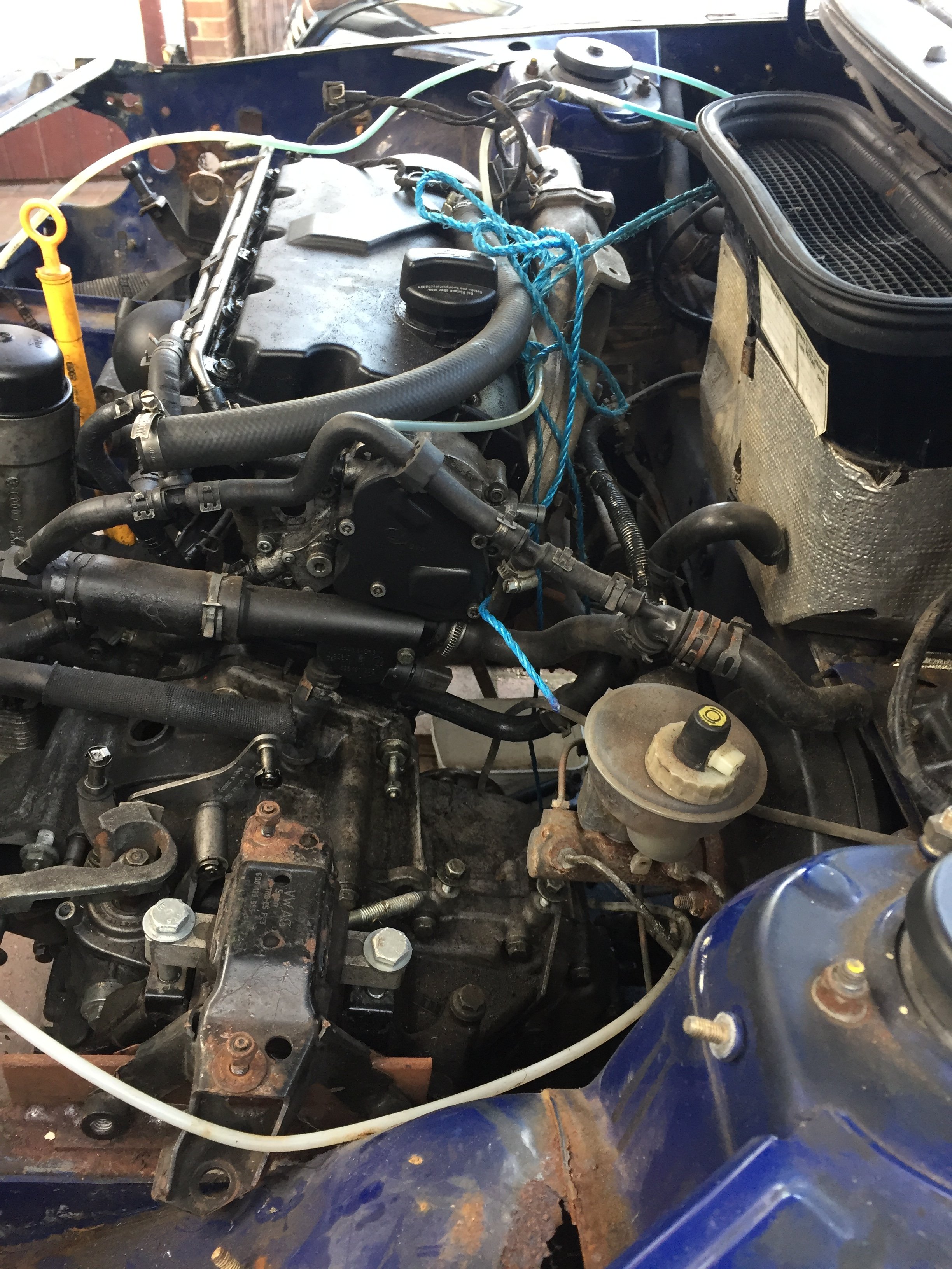

I think it fits now. try again this week end. Need to line up gearbox with wheel bearings.
the rapids are multiplying.

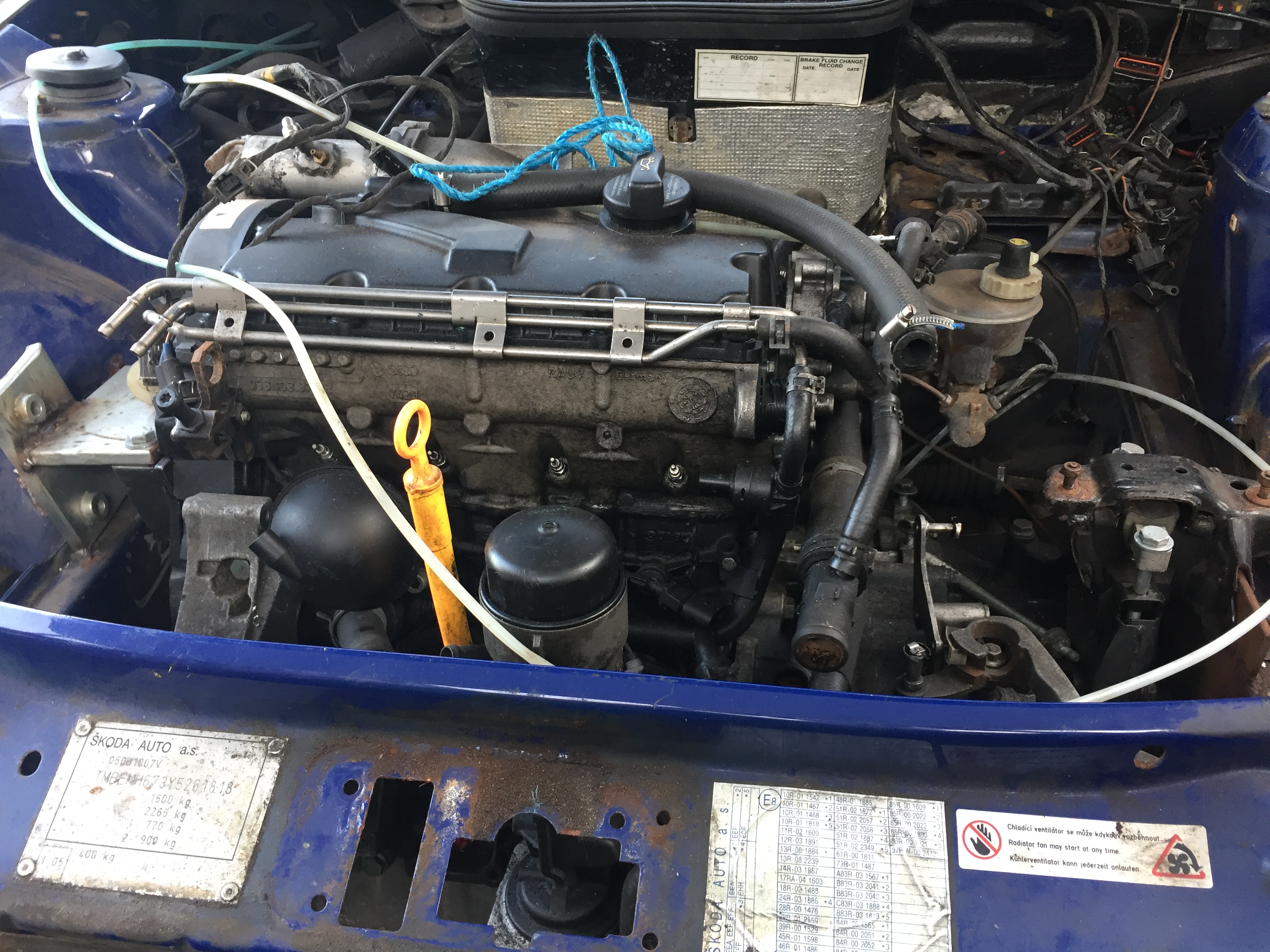

ok so the red rapid has its engine back in. not plumed yet.
The engine in the pick up positioned and making engine mounts. Slow going.
