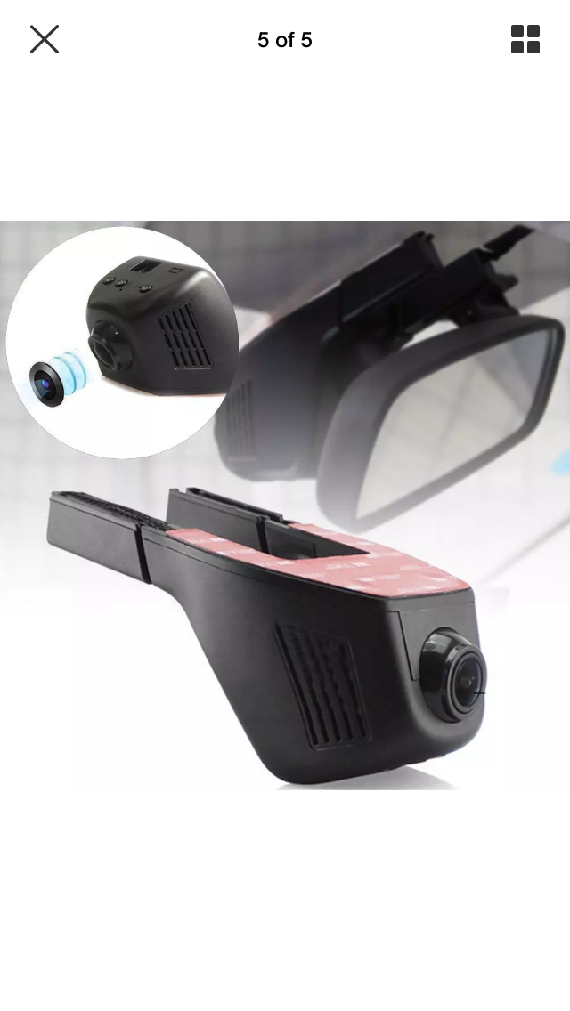

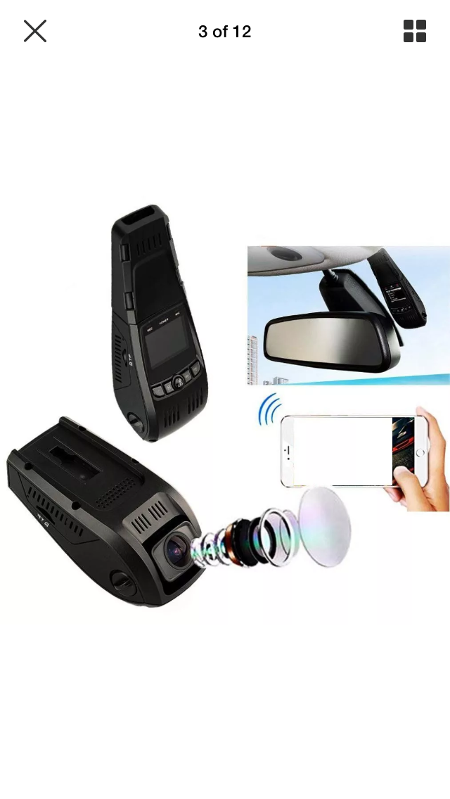

i). Having had an accident where someone 'didn't see me' and pulled out into my front passenger door on my old car- I'm wanting to add a permanent front discrete dash cam, and am thinking about one that mounts up by the rear view mirror, taking the wires around the windscreen and hardwiring behind the dash somewhere. (A professional auto electrician is doing it!) I've got the two choices attached below- one I suspect won't go around the fairly chunky plastic of the mirror housing and the other looks like it would work (if only I could remove part of the ceramic paint sun screening on the windscreen there!)- has anyone used a camera like either of these? What did you do location wise?

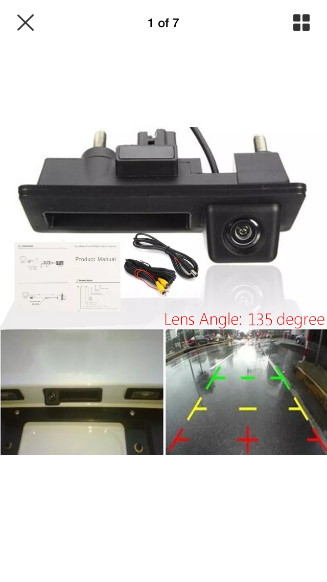

ii). As to rear view reversing camera- I'm looking at one that will replace the trunk handle- these seem identical on my Fabia 3 estate and my Fathers Octavia estate, but if anyone has advice on this I'd be grateful for it! Pic below

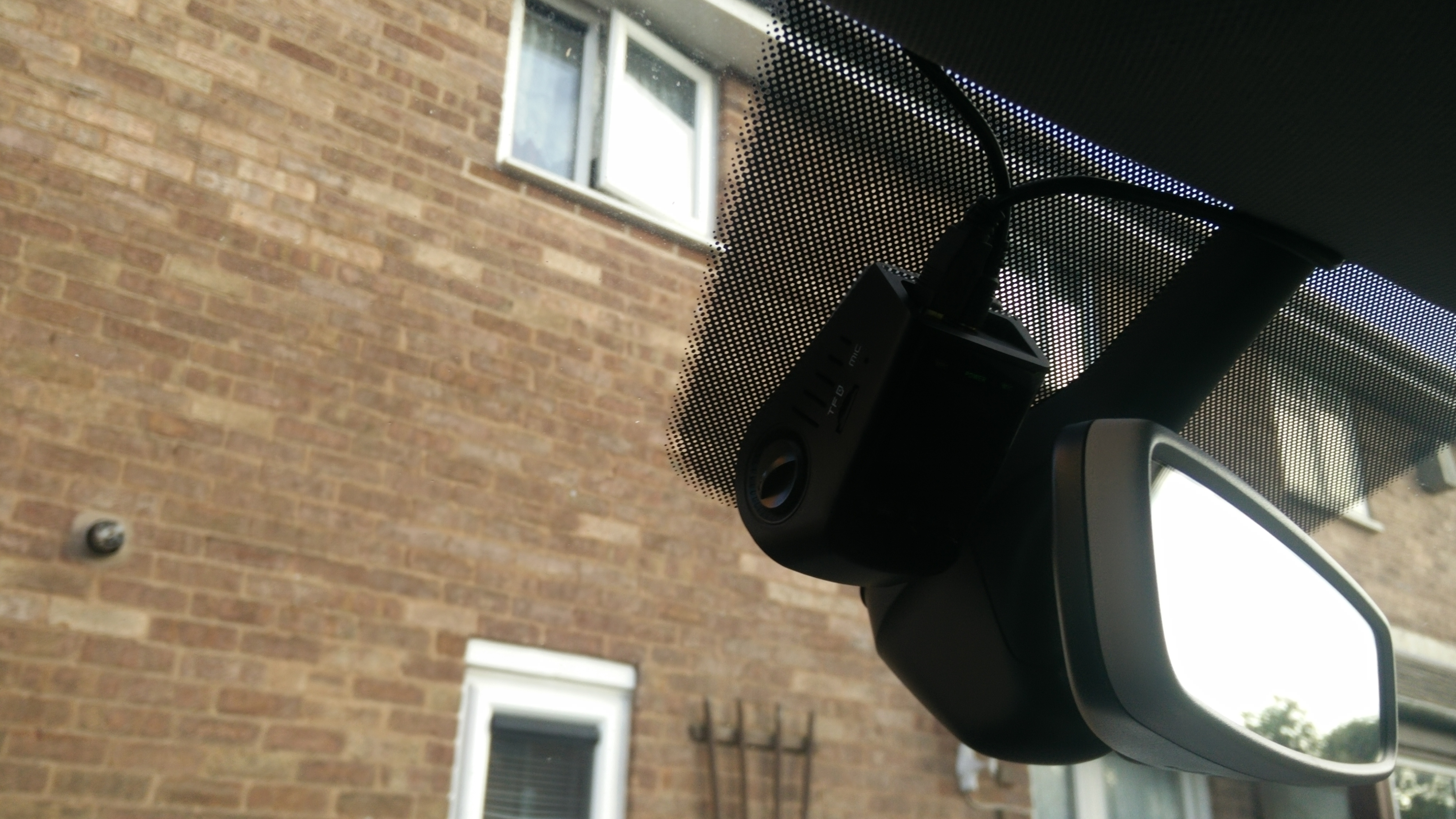

I use a dashcam similar to that, its behind the mirror goes along the headlining down the rubber door seal on the drivers side and is hardwired into the fusebox. I can take some pictures if you'd like to see how I did it.

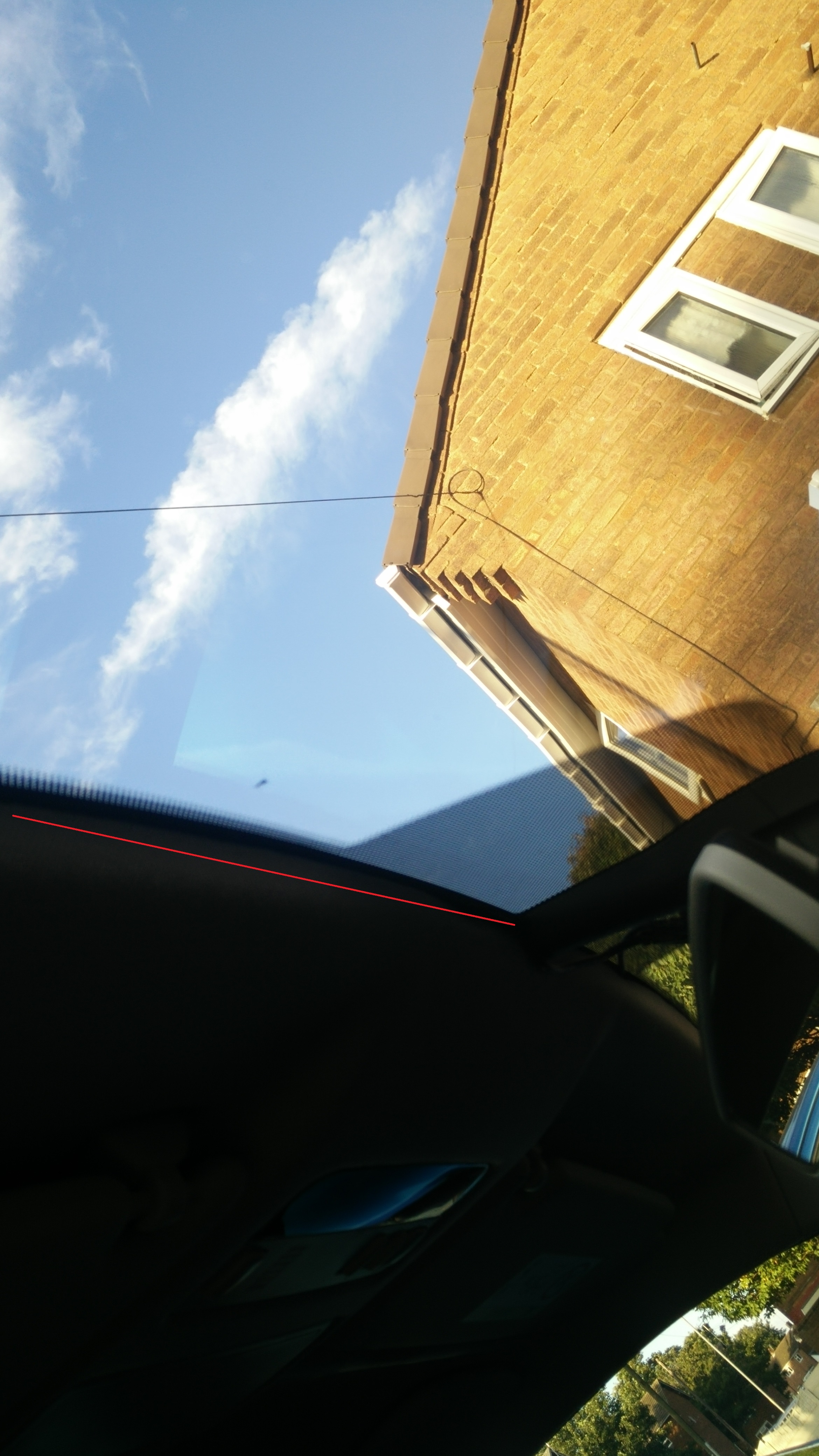

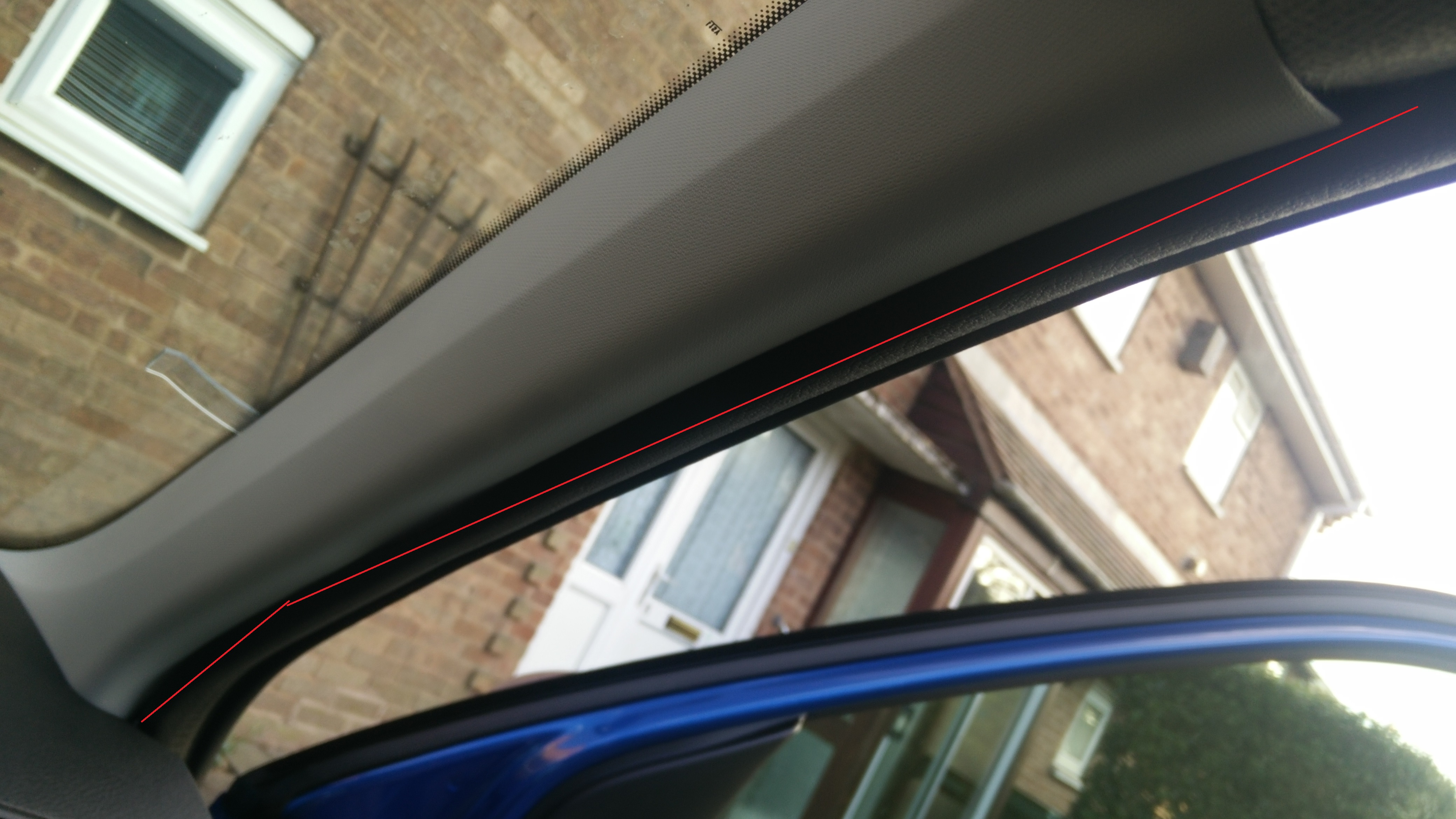

Cable follows the red line. Then comes out of the seal and into the fusebox, for some reason it won't let me upload any more pictures though. Let me know if you have any more questions.

I like the idea of the one that looks like it wraps around the existing mirror support- where did you find that one?
