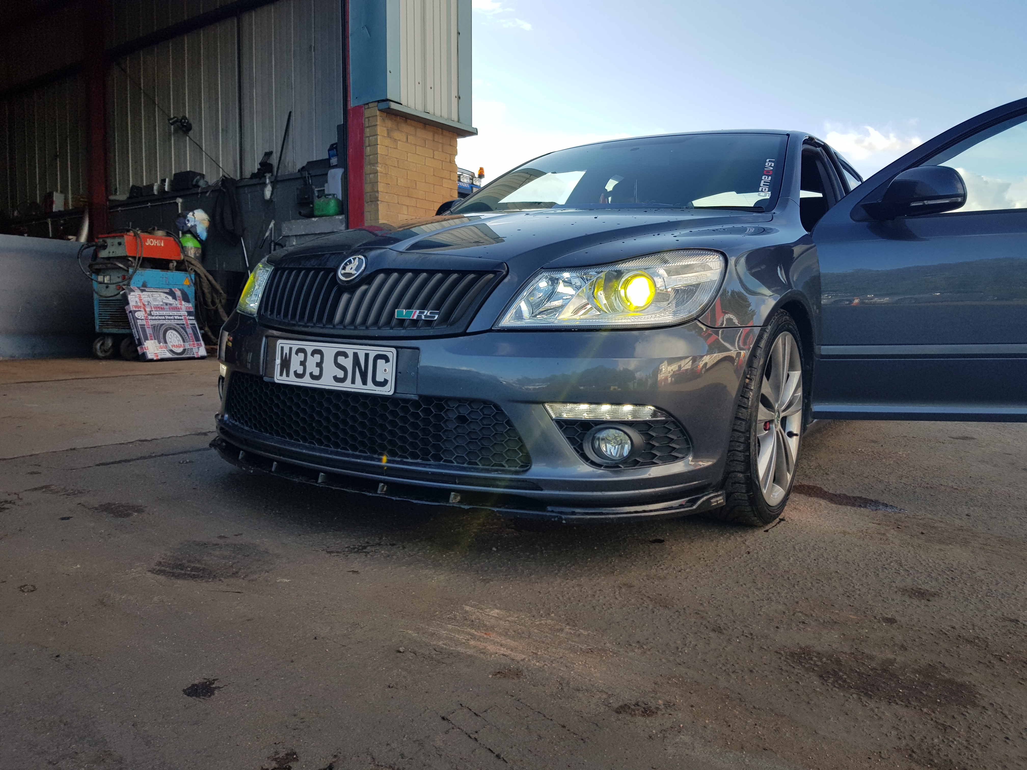

Hi guys looking for some help
My self & a friend tried to change settings to turn my indicators to stay on like our US friends but we somehow managed to turn my DRL off!! And can not being them back on ?
I have went to another friend who remapped my car who took a copy of the setting before the remap and reapplied these and still nothing now before a trip to the dealer can anyone advise anything else ?? I have carista and have tried the app and it is they are turned on but still nothing nothing outside the car
Thanks guys
